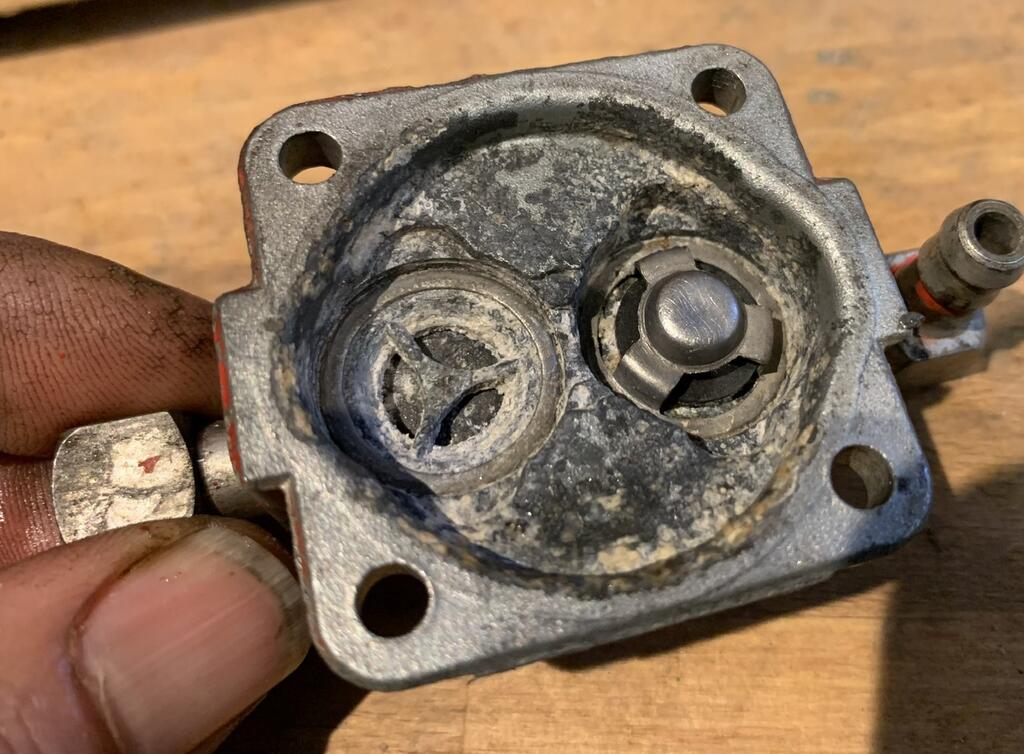

meadowfield 3,191 #1 Posted June 29, 2020 Over the years a few of my k series have become sluggish to start and miss at high revs. The C-101 in particular suffer from taking a long time to draw fuel and misses - running better with a little choke. It’s a challenge to find a good cast aluminium pump, most of mine have had water in and the two valve seats are often really corroded making the pump inefficient.... I’ve tried at least 3 cheap plastic pumps. They start off well and all my issues go away. However within weeks I will find that I can’t get the tractor to start - working through it’s always lack of fuel. Each time the pump just fails to either draw or pump - priming it helps, but it still doesn’t work right. I once wired an electric pump under the seat, however the noise Was unbearable - as well as the size of the thing. so looking for inspiration on an effective replacement - has anyone ever tried a pulse pump from a later engine and tried using the crank pressure? thanks Share this post Link to post Share on other sites

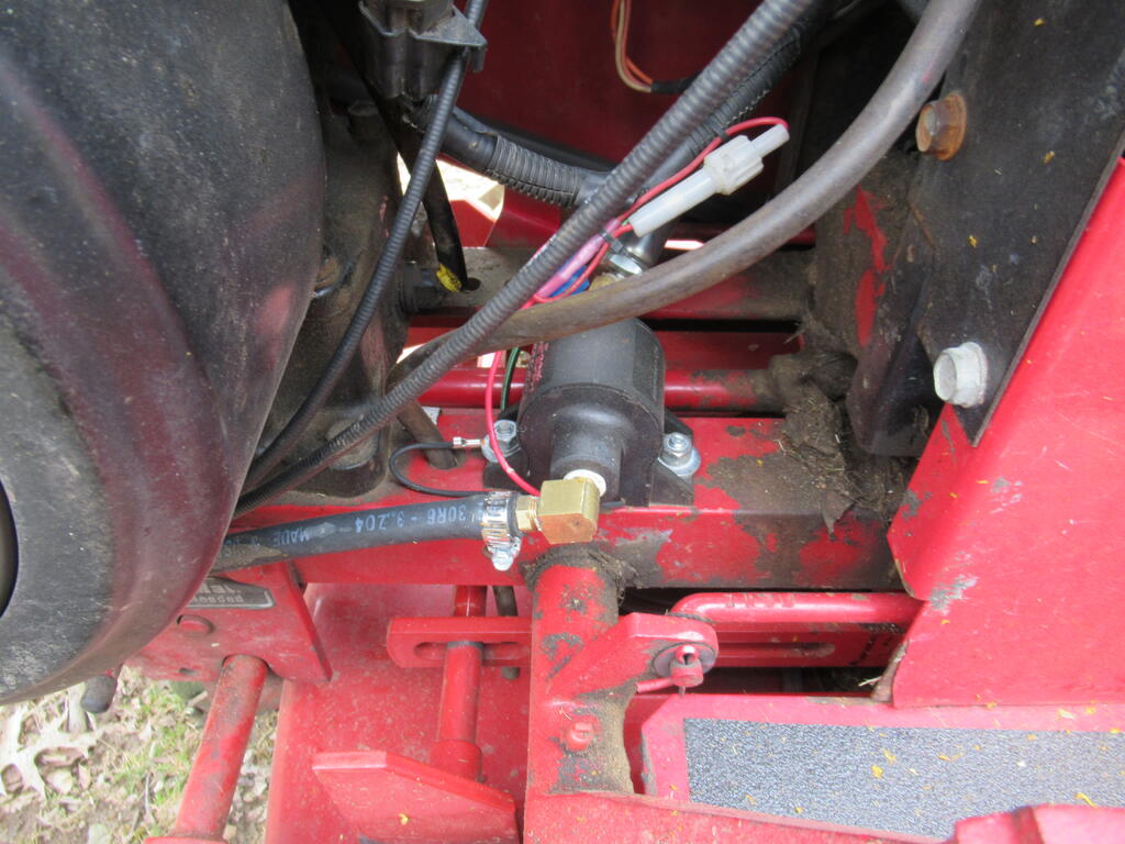

squonk 48,322 #8 Posted June 29, 2020 The Facet pump ( Napa # 610-1051) is small, quiet, draws low amps & is reliable. I can hardly hear it run on my C-160. I do not know what the equivalent would be in Jolly Ol' England. 3 1 Share this post Link to post Share on other sites

meadowfield 3,191 #10 Posted June 29, 2020 5 minutes ago, WHX24 said: I was going to suggest what the redneck did.... Yah he belongs on Monty Python but kinda knows what he is doing! Guessing you tried rebuilding the old metal ones? I have previously, but the valve seats have been corroded. I've got a slightly different one in the ultrasonic tank at the moment and it looks like the valves can be unscrewed... Share this post Link to post Share on other sites
WHX?? 58,347 #11 Posted June 29, 2020 No chance of resurfacing the seats? Also guessing you have seen these.. http://www.then-now-auto.com/kohler-fuel-pumps-2/ 1 Share this post Link to post Share on other sites
meadowfield 3,191 #12 Posted June 29, 2020 10 minutes ago, WHX24 said: No chance of resurfacing the seats? Also guessing you have seen these.. http://www.then-now-auto.com/kohler-fuel-pumps-2/ I haven't tried pulling them out as they look pressed, I'm assuming the corrosion will have done a good job of welding too! 1 Share this post Link to post Share on other sites
pfrederi 21,301 #13 Posted June 29, 2020 Your engines must be very very quiet. I hear my electric pumps clicking (Facet Posiflo) when I turn the key on. Once the engine is running there is no way I can hear them. Pulse pumps carry a rick that when the diaphragm fails you suck gas into the crankcase. 2 Share this post Link to post Share on other sites
pacer 3,181 #14 Posted June 29, 2020 "I hear my electric pumps clicking (Facet Posiflo) when I turn the key on. Once the engine is running there is no way I can hear them." My 4 pumps are like Paul sez, In fact, as a rule I pause a few seconds to make sure I hear the clicking then when started ... nothing cept engine running... and the mower deck, etc. I dont have the Facet pump brand, but they are a copy of it. Had 3-4 of the round ones and they failed quickly but the Facet copies are holding up. 1 Share this post Link to post Share on other sites

oldlineman 1,820 #22 Posted June 29, 2020 Ya what squonk said, I replaced my mechanical pump on my 1989 414-8 and I will never go back to a mechanical pump, I used a Facet pump a little pricey but you only get what you pay for. Can't even hear it when engine is running. I will never use a mechanical pump again instant starts every time! Bob 5 Share this post Link to post Share on other sites
953 nut 70,324 #23 Posted June 29, 2020 10 hours ago, meadowfield said: valve seats have been corroded. I rebuilt one with a Then and Now kit that had seats that were a mess. Cleaned them up as best I could, applied a little JB Weld and installed the valves and clamped them in place. Once it set up the pump went together and has been working fine for several years. Share this post Link to post Share on other sites
meadowfield 3,191 #24 Posted June 30, 2020 Is this fixable? Share this post Link to post Share on other sites
953 nut 70,324 #25 Posted June 30, 2020 5 hours ago, meadowfield said: Is this fixable? Yes, if you can pop those old valves out and clean the passages to the fuel lines it will be ready for the Then and Now repair kit. Share this post Link to post Share on other sites
