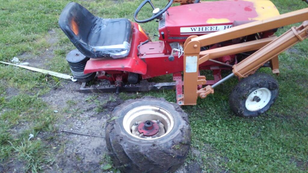

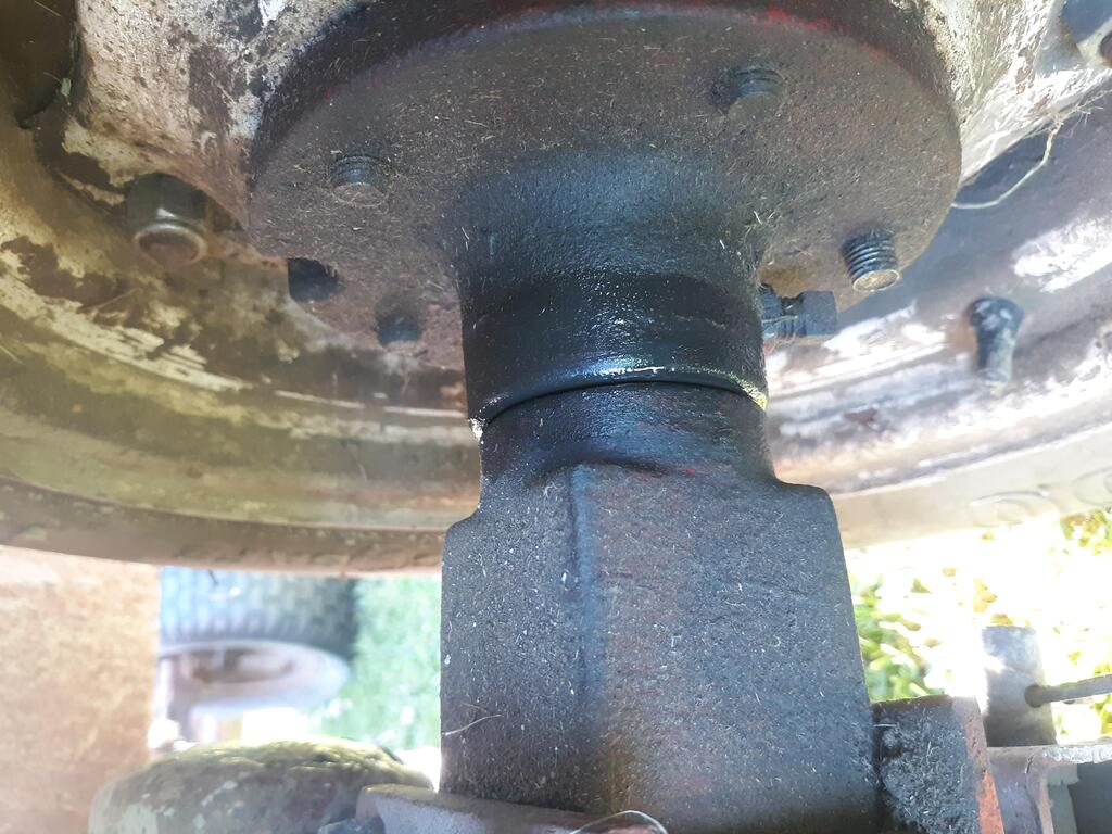

1973Auto 85 #1 Posted June 29, 2020 Well the old horse may have seen better days. Changed the cam plate as I have done may times before. Put her in reverse went fine then real slow in forward then it just quit. No reverse no forward, nothing. . Took a pic of the rear wheel, say oil/grease coming out. Did notice that it was bucking hard going forward in slow speed. Did not think much of it. Any thoughts? Share this post Link to post Share on other sites
Pullstart 71,333 #2 Posted June 29, 2020 I think that’s no reason to put a Horse to pasture... Is the fluid level ok? I’d start there on the motion. Your transmission is two parts working together. The hydro motor and the differential casing. If you can get it to move, the diff can be split and new bearings/seals installed. There is plenty of help on here 1 Share this post Link to post Share on other sites
ebinmaine 80,783 #3 Posted June 29, 2020 8 minutes ago, pullstart said: I think that’s no reason to put a Horse to pasture I'd agree. These machines are incredibly easy to repair and get needed parts. With all the hydro maestros on Redsquare you can get it running around... 3 Share this post Link to post Share on other sites
1973Auto 85 #4 Posted June 29, 2020 15 minutes ago, pullstart said: I think that’s no reason to put a Horse to pasture... Is the fluid level ok? I’d start there on the motion. Your transmission is two parts working together. The hydro motor and the differential casing. If you can get it to move, the diff can be split and new bearings/seals installed. There is plenty of help on here Yes. There is fluid. I didn't do more than check that. I didn't jack it up yet. I just got PO'ed and left it there. I know nothing about trany's so I am Leary about ripping this apart. I wouldn't mind taking it to someone that is knowledgeable in this area. Maybe a 150 mile radius of Jamestown NY Share this post Link to post Share on other sites
RandyLittrell 3,946 #5 Posted June 29, 2020 Sure it's not a woodruff key? Randy 3 Share this post Link to post Share on other sites
1973Auto 85 #6 Posted June 29, 2020 8 minutes ago, RandyLittrell said: Sure it's not a woodruff key? Randy's have not checked yet I just let it sit. Question though, wouldn't one wheel grab? Just spit ballin' here Share this post Link to post Share on other sites
RandyLittrell 3,946 #7 Posted June 29, 2020 (edited) Nope, one axle will just spin in the hub and its my experience at first they might grab a little, making it feel like the tranny. I'll keep my fingers crossed since it's an easy fix!! This can happen while trying to get it back to the shop. Randy Edited June 29, 2020 by RandyLittrell 3 1 Share this post Link to post Share on other sites
RandyLittrell 3,946 #8 Posted June 29, 2020 The hub that close to the tranny is a clue I think. If they slide in a bit, they lose bite on the woodruff key. Randy 1 Share this post Link to post Share on other sites

71_Bronco 1,072 #11 Posted June 29, 2020 While in there, change out the seal. That will stop the fluid from leaking out like you said. Seals are cheap. 2 Share this post Link to post Share on other sites
Pullstart 71,333 #12 Posted June 29, 2020 I believe that is an 1-1/8” axle. Here’s a link to part numbers for seals. 1 Share this post Link to post Share on other sites

1973Auto 85 #16 Posted June 29, 2020 The horse is still kicking!!!! it was the 65 cent woodruff key!!!! Thanks for the suggestions and where I can get the Trany worked on in case it some day kicks the bucket. Just the way it acted I thought the worst! The fat chick is still going!!! 1 3 Share this post Link to post Share on other sites
1973Auto 85 #17 Posted June 29, 2020 21 hours ago, RandyLittrell said: Nope, one axle will just spin in the hub and its my experience at first they might grab a little, making it feel like the tranny. I'll keep my fingers crossed since it's an easy fix!! This can happen while trying to get it back to the shop. Randy Had the exact same thing happen to me about 7-8 years ago. But I was plowing and it was a freakin snow storm! Lucky the neighbor had his Kubota with the front bucket. Picked up the ass end and pushed it back to my garage!! 1 Share this post Link to post Share on other sites
