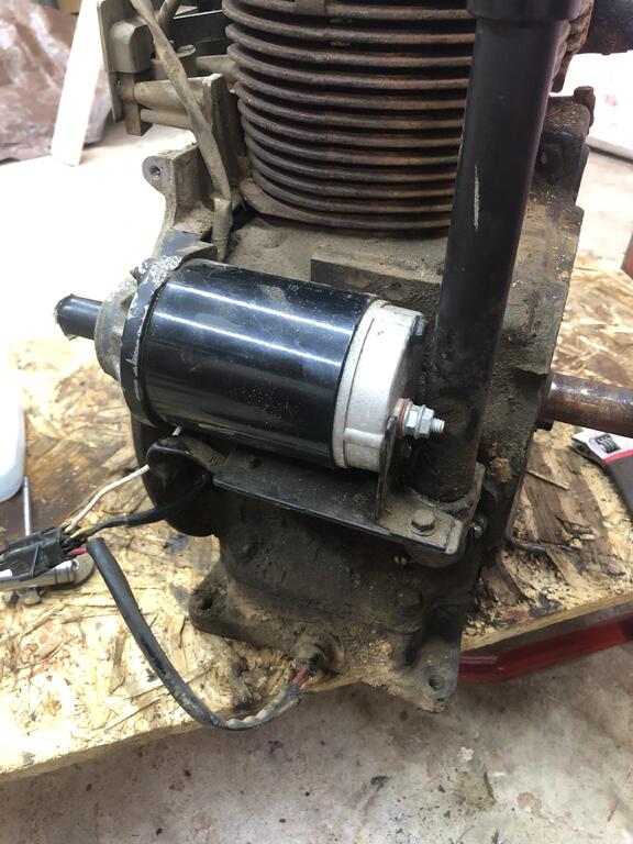

The Tuul Crib 7,354 #1 Posted June 28, 2020 Sitting here looking at the starter on this magnum and trying to figure out the best way to remove it without well you know screw it up!? I need a push! Share this post Link to post Share on other sites
pfrederi 20,264 #2 Posted June 28, 2020 (edited) Tape the end caps to the body. the two mounting screw also hold the ends on Edited June 28, 2020 by pfrederi 2 Share this post Link to post Share on other sites
stevasaurus 23,662 #3 Posted June 28, 2020 Can you remove the bracket with the starter attached so you can get it on the work bench before taking out those through bolts?? Careful, there is a spring snake in the case!! 2 Share this post Link to post Share on other sites
WVHillbilly520H 10,378 #4 Posted June 28, 2020 1 hour ago, The Tuul Crib said: Sitting here looking at the starter on this magnum and trying to figure out the best way to remove it without well you know screw it up!? I need a push! I just did the 414-8... Take the dipstick tube off (3 screws) then remove the block fastening bolts easy peasy installation is in reverse operation. 1 1 Share this post Link to post Share on other sites
The Tuul Crib 7,354 #5 Posted June 28, 2020 1 minute ago, WVHillbilly520H said: I just did the 414-8... Take the dipstick tube off (3 screws) then remove the block fastening bolts easy peasy installation is in reverse operation. I just picked this engine up from a friend he said he didn't need it no more so he gave it to me. I have a magnum 14 but I have never pulled a starter off of it so I was making sure I didn't turn something that wasn't supposed to be turned! 2 Share this post Link to post Share on other sites
The Tuul Crib 7,354 #6 Posted June 28, 2020 3 minutes ago, WVHillbilly520H said: I just did the 414-8... Take the dipstick tube off (3 screws) then remove the block fastening bolts easy peasy installation is in reverse operation. Man that sounds too much like a day job!! Ill give it a try ! I'm actually gonna set it back aside so I can get back to my sunstrand rebuild. 1 Share this post Link to post Share on other sites
WVHillbilly520H 10,378 #7 Posted June 28, 2020 Just now, The Tuul Crib said: Man that sounds too much like a day job!! Ill give it a try ! I'm actually gonna set it back aside so I can get back to my sunstrand rebuild. Day job yes... 10 mins... And the rest of the day for some malted adult beverages of your choice 😁. 4 Share this post Link to post Share on other sites
