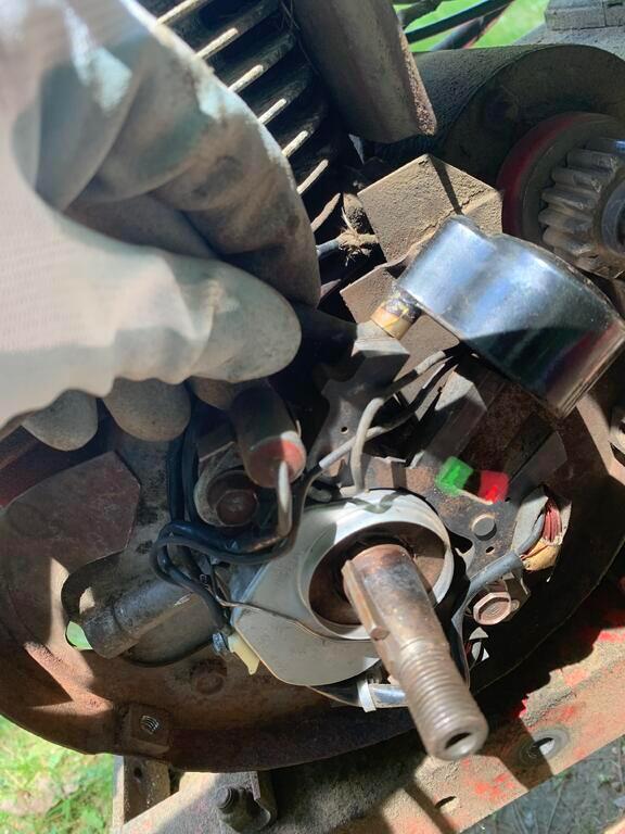

Tractorhead
On your Flywheel, you have an spot that is a bit thicker.
That is the Ignition Magnet. Get the center of that and mark it if it‘s not alleady marked.
in the inserted Pict i have marked two spots green and red.
close to the middle of them both maybe a bit closer to the right side shall be the ignition point.
Here must your points opening.
Build a template that can be outside the flywheel be mounted
or mark that Area on the Airflow cover.
your points must open in center of that marked area.
mark the magnet with an edding in black or blue or a light scratch on the flywheel
and verify if your ignitionpoint is steady.
