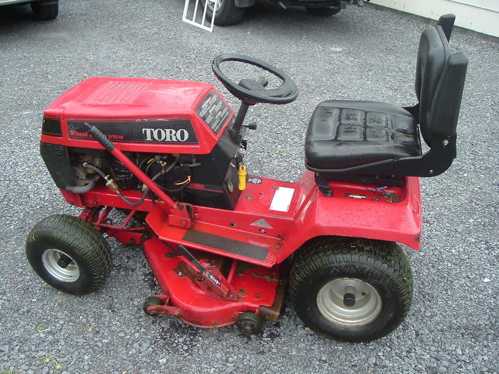

211-4 2 #1 Posted June 27, 2020 I cant get original rim off my W/H and want to make sure not to bang it up, any ideas? Share this post Link to post Share on other sites

gwest_ca-(File Mod) 11,920 #4 Posted June 27, 2020 This model has the wheel keyed to the axle so no hub. You do not want to pull the wheel off the axle. That will do transmission damage. You need to push the axle out of the wheel to get them separated. Rust may make that impossible. Why does it need to come off? If the tire is flat you can remove the tire with the wheel where it is. The hardest part of changing a tire is securing the wheel so you can work on it. Your's is well secured. Garry 1 Share this post Link to post Share on other sites

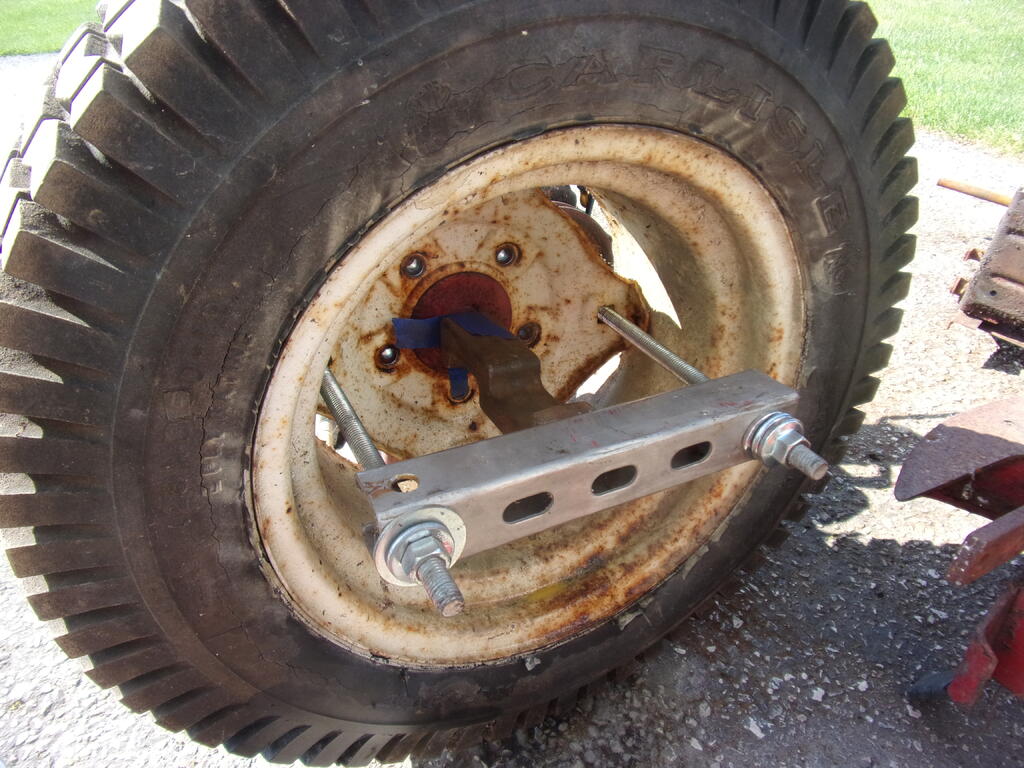

Ed Kennell 44,095 #6 Posted June 27, 2020 If you must take it off, make a simple puller that pushes against the axle. This will not damage the transmission. 1 1 Share this post Link to post Share on other sites
squonk 45,077 #7 Posted June 27, 2020 (edited) You cannot push the wheel that way. There is no hub. You will have to fashion a bracket like Ed's picture to the wheel weight bolt holes, but you will need to make a center screw smaller than the axle itself to push on the axle and fit inside the wheel hole. This must be done carefully as to much pressure on the axle can damage the transmission. This is the style of wheel he is working with: Edited June 27, 2020 by squonk 3 Share this post Link to post Share on other sites
