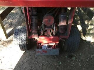

RTJ 5 #1 Posted June 26, 2020 Hello everyone. I have a 1974 D200 that needs mufflers. I found a muffler made by Nelson on eBay. It is model 10n90. They are about $55 shipped. They have 1" male npt at each end. Seems I could use a 1" coupling or screw them straight into the exhaust elbow. Is this too good to be true? It would be pretty easy to add a coupling, straight pipe and elbow on the bottom Please let me know what you think The eBay auction is 193528498809 Thanks! Enjoy the day with your wheelhouse! RTJ Share this post Link to post Share on other sites

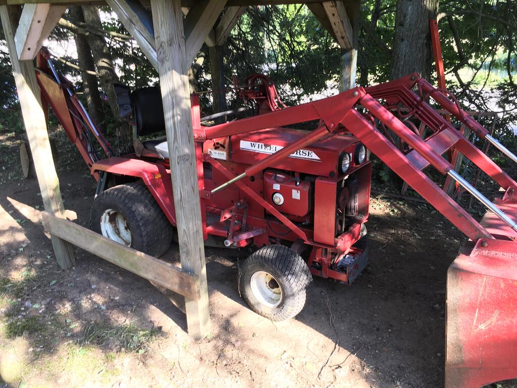

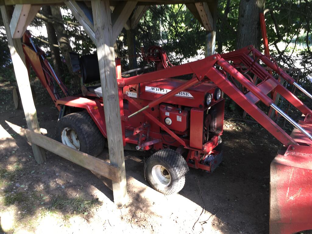

RTJ 5 #5 Posted June 26, 2020 Thanks for the welcome. Here are a few pix of the beast 4 Share this post Link to post Share on other sites
Pollack Pete 2,273 #6 Posted June 27, 2020 VERY nice D-200.Front end loader??? Backhoe??? I'm green with envy{ Not John Deere green }What brand is the loader and backhoe?Really nice. Share this post Link to post Share on other sites
RTJ 5 #8 Posted June 27, 2020 Thanks. The FEL is an Ark. The backhoe is a Brantly. I bought it a number of years ago as seen with a few boxes of parts and pieces, as well as the original gas tank and weight plates. I just need to get some mufflers. I really don't want to drop almost $600 for the OEMs.... Share this post Link to post Share on other sites

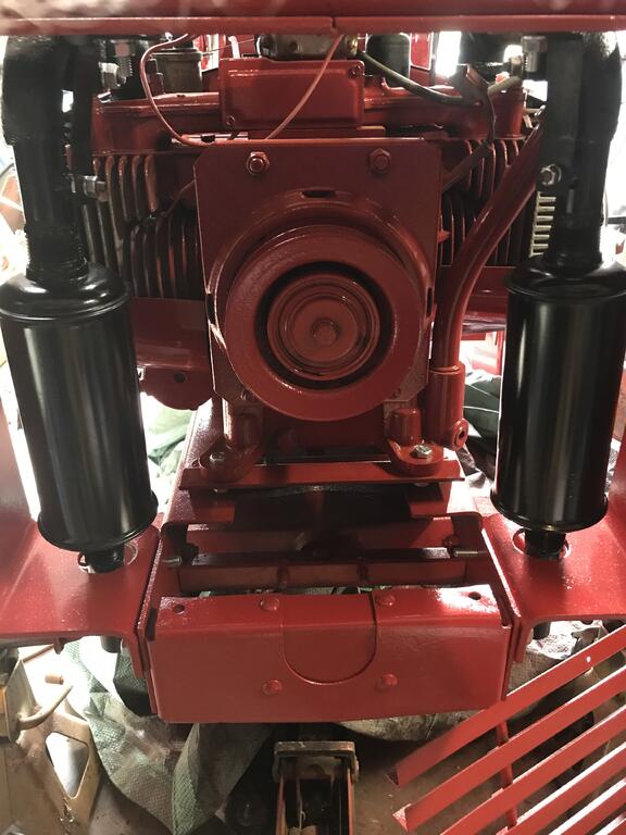

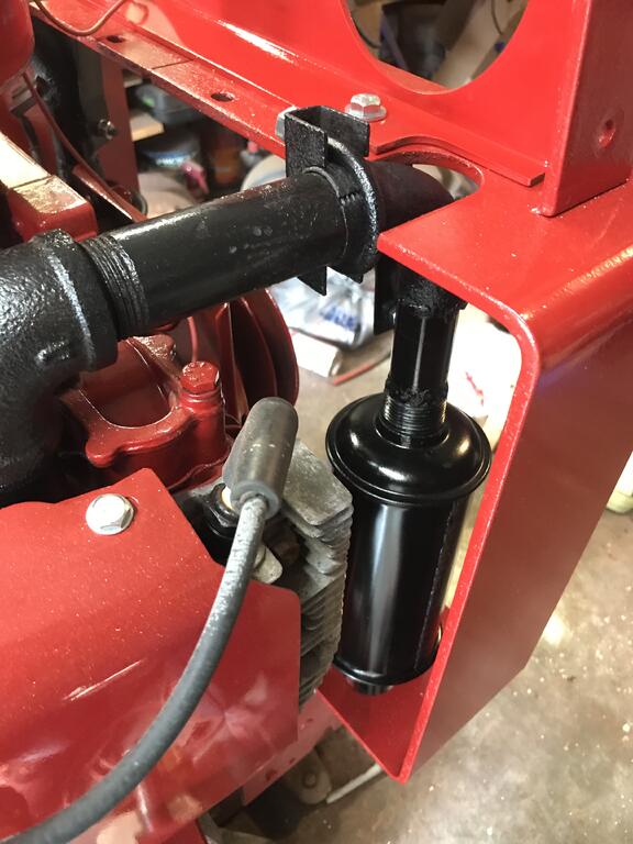

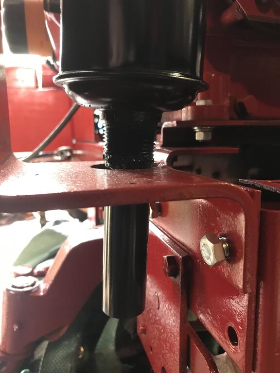

dells68 7,499 #9 Posted June 27, 2020 They were perfect for my D160. I bought a set last winter from the same seller. I chose to weld tubing to them to avoid the heavy pipe couplings and keep a better look. They sound great too! Share this post Link to post Share on other sites
RTJ 5 #10 Posted June 27, 2020 That is awesome! Great job. The seller still hasn't replied with size confirmation. But from m your experience it seems like they will work. I am not familiar with these tractor supply at all, but it seems the 160 180 and 200 utilized the same mufflers originally. I plan to put elbows or plugs and drill holes similar to the OEM. Depends on my mood that day I guess....... Thanks for the photos and info!! 1 Share this post Link to post Share on other sites
RTJ 5 #11 Posted June 27, 2020 Dells68, Did you insert the pipe into to muffler or butt it up before welding? What paint did you use? And is it holding up? Thanks RTJ Share this post Link to post Share on other sites
dells68 7,499 #12 Posted June 28, 2020 On 6/27/2020 at 10:40 AM, RTJ said: Dells68, Did you insert the pipe into to muffler or butt it up before welding? What paint did you use? And is it holding up? Thanks RTJ I simply but welded them together. I had some electrical tubing the perfect size. I’m tickled with how it turned out! As far as paint, I used Rustoleum semi gloss barbecue paint. So far, it’s holding up well and I e had good luck with it in the past! Share this post Link to post Share on other sites
