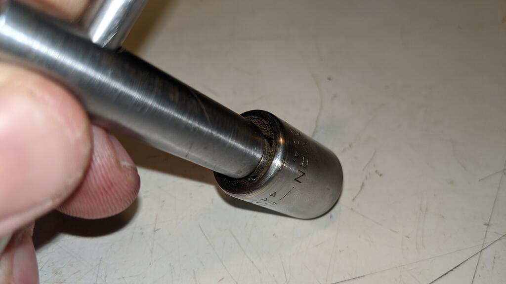

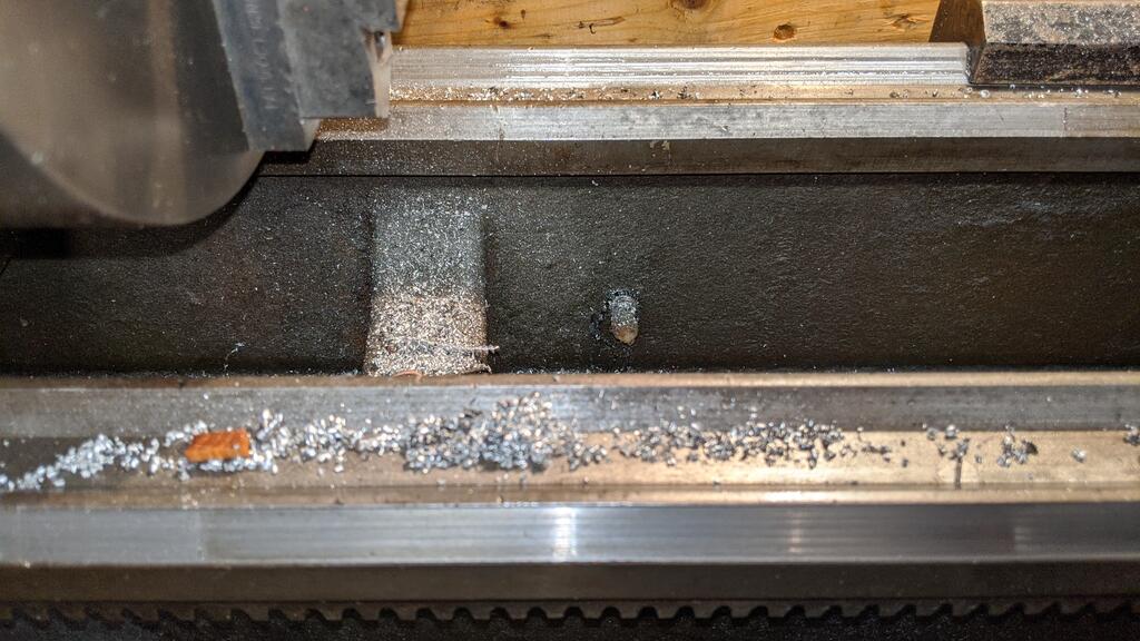

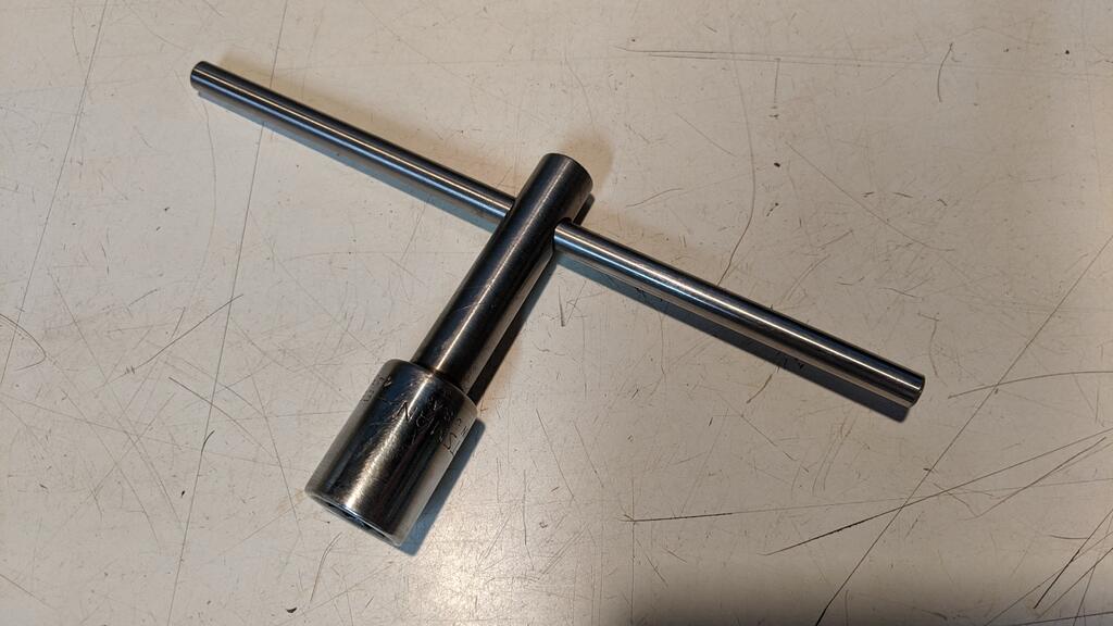

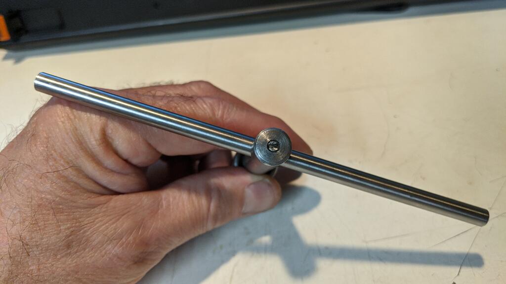

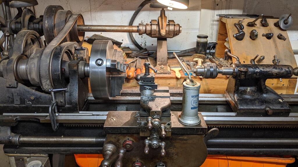

echris 1,425 #1 Posted June 24, 2020 (edited) About 20 years ago or so, I got a 10" F.E. Reed and Company engine lathe from my brother. She's old. Really old. But she's has less wear than many much newer machines I've seen. Look at the condition of the ways, right under the chuck! When I first got her, I didn't not have a chuck key, so I used a good old trusty Swagelok wrench. Kinda of a pain in the butt, so I used my lathe to make a tool for my lathe. Nothing fancy, but I did add a set screw to the shaft. I didn't have the correct one so I cut the head off a 6/32 and file a slot in it. Ground the end of the shank square And epoxied a spare socket onto the end. Love this old girl! NEVER leave your chuck key in your chuck. I know. It's for the paparazzi! I hope you guys enjoy ancient machines as much as I do. They JUST WORK. Edited June 24, 2020 by echris 7 3 4 Share this post Link to post Share on other sites
JAinVA 4,638 #3 Posted June 24, 2020 (edited) I know its just for the pictures but the machinist in me cringes at the sight of the chuck wrench left in the chuck.The last time i saw that the apprentice turned on the lathe before I could get to him I could live a life time and be happy without seeing that again. Edited June 24, 2020 by JAinVA 4 Share this post Link to post Share on other sites

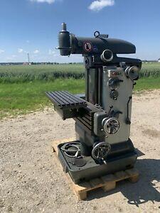

Tractorhead 9,215 #10 Posted June 24, 2020 Like that old tools. They built rock solid. If i got my Part of Shed in 2 Years, a old Deckel FP2 Milling Machine is still waiting for, to come into my new Workshop than. actually it‘s my Friend‘s Workshop aside, i can use it if i need but it‘s 50 km Far... hope this time goes quick. 2 Share this post Link to post Share on other sites
echris 1,425 #11 Posted June 24, 2020 15 hours ago, JAinVA said: I know its just for the pictures but the machinist in me cringes at the sight of the chuck wrench left in the chuck.The last time i saw that the apprentice turned on the lathe before I could get to him I could live a life time and be happy without seeing that again. I know what you mean. I'm a real stickler about this. This pic may be the only time I've done that and it was removed immediately after! See the board with the lathe tooling behind the lathe, there's an empty hole on the lower left. That's for the chuck key. 1 Share this post Link to post Share on other sites
echris 1,425 #12 Posted June 24, 2020 40 minutes ago, Tractorhead said: Like that old tools. They built rock solid. If i got my Part of Shed in 2 Years, a old Deckel FP2 Milling Machine is still waiting for, to come into my new Workshop than. actually it‘s my Friend‘s Workshop aside, i can use it if i need but it‘s 50 km Far... hope this time goes quick. Those Deckel's mills are beautiful. My neighbor Dave has one he recently restored. A bit older than yours I believe. What a fantastic machine. 2 1 Share this post Link to post Share on other sites
