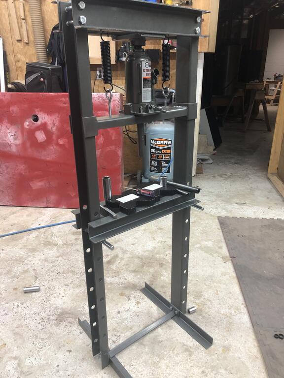

The Tuul Crib 7,347 #1 Posted June 21, 2020 Got this Father's Day gift today the wife said I know what you want go pick it up at Harbor freight. I've already used it a couple times today and this is a wonderful tool 4 10 1 Share this post Link to post Share on other sites

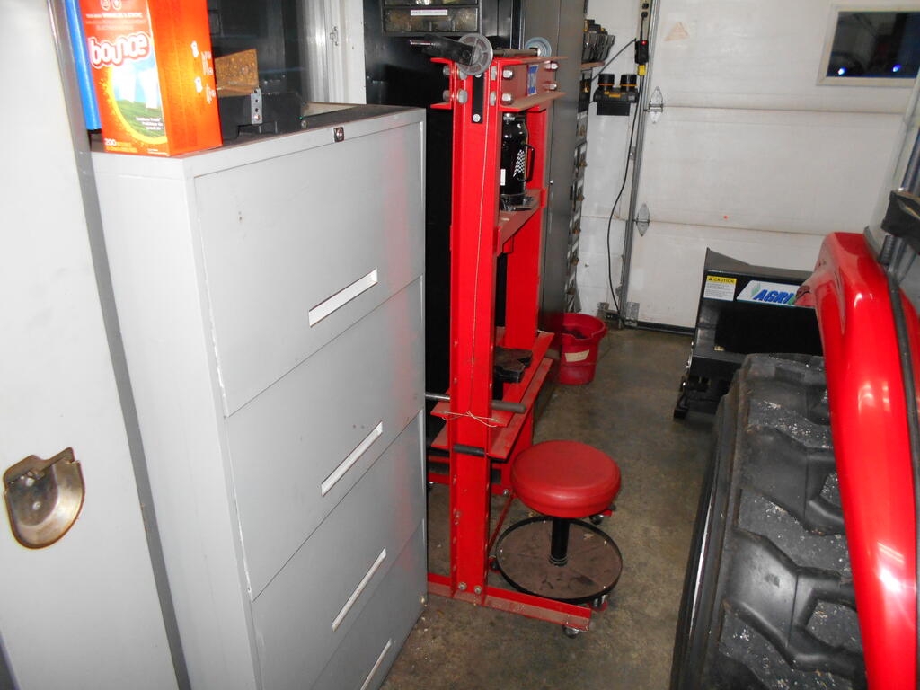

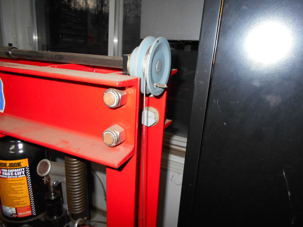

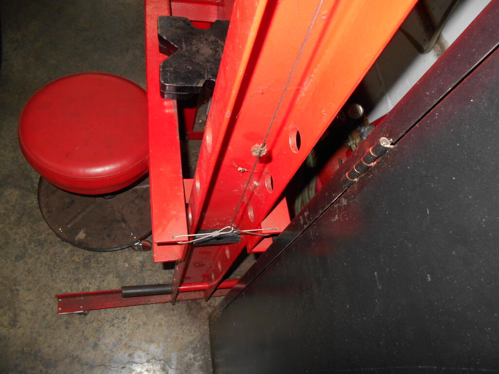

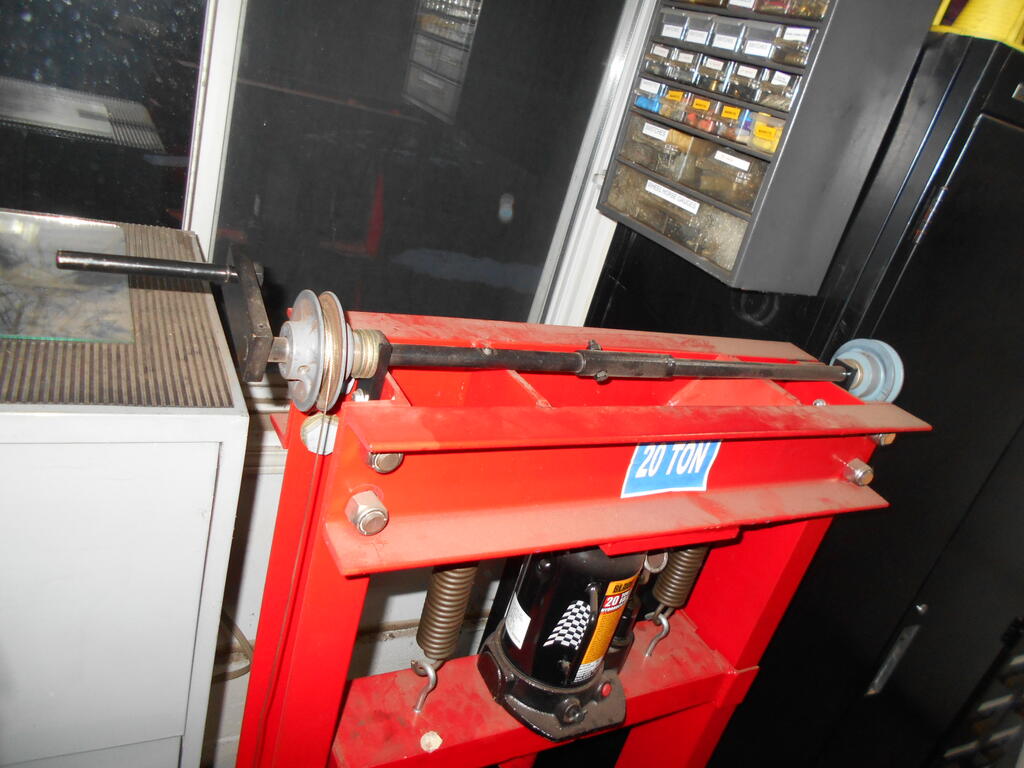

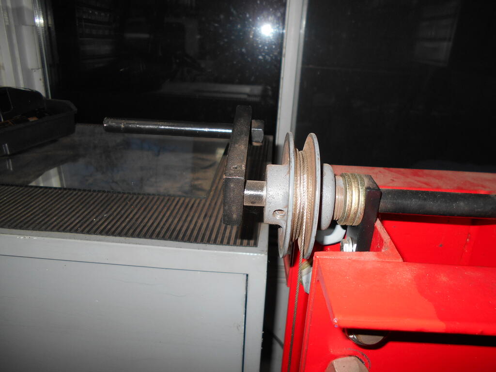

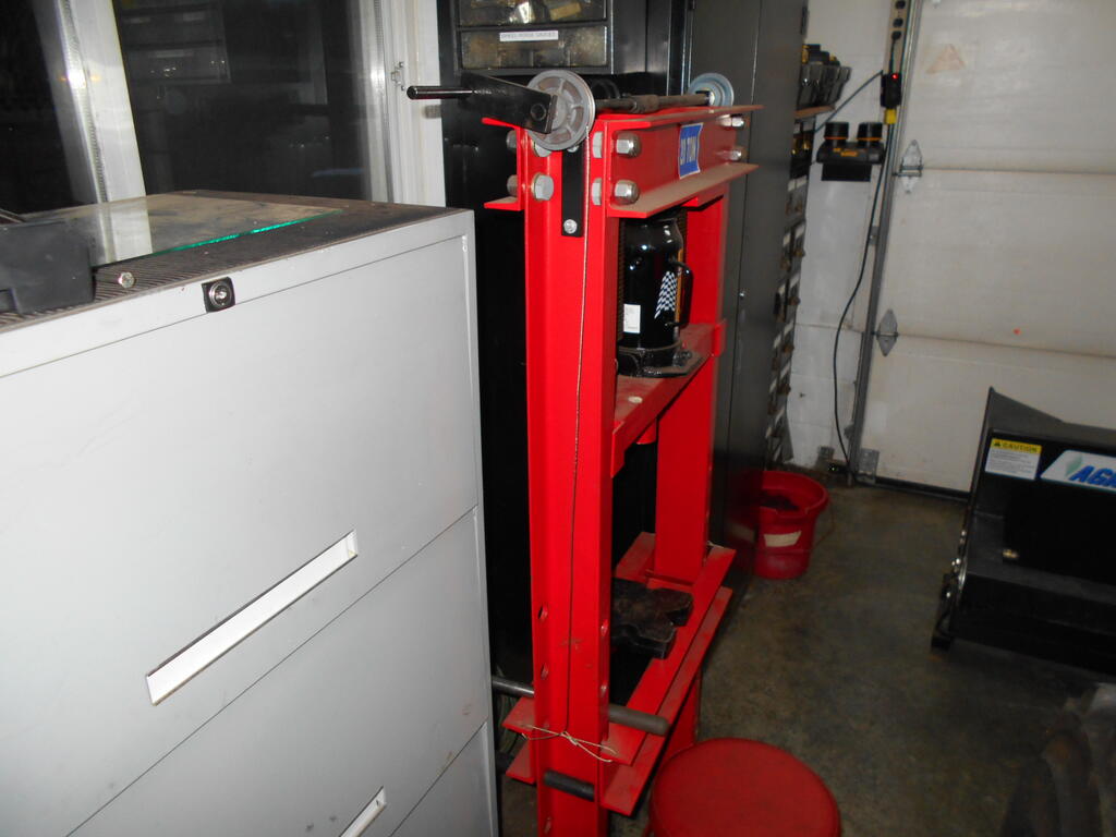

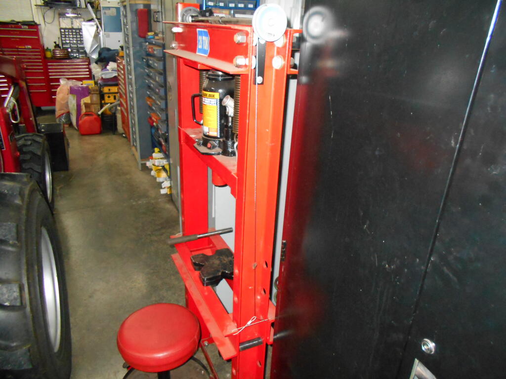

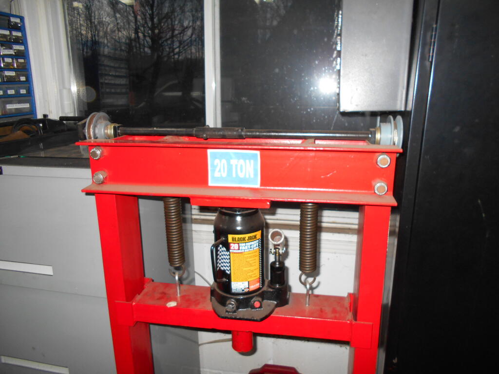

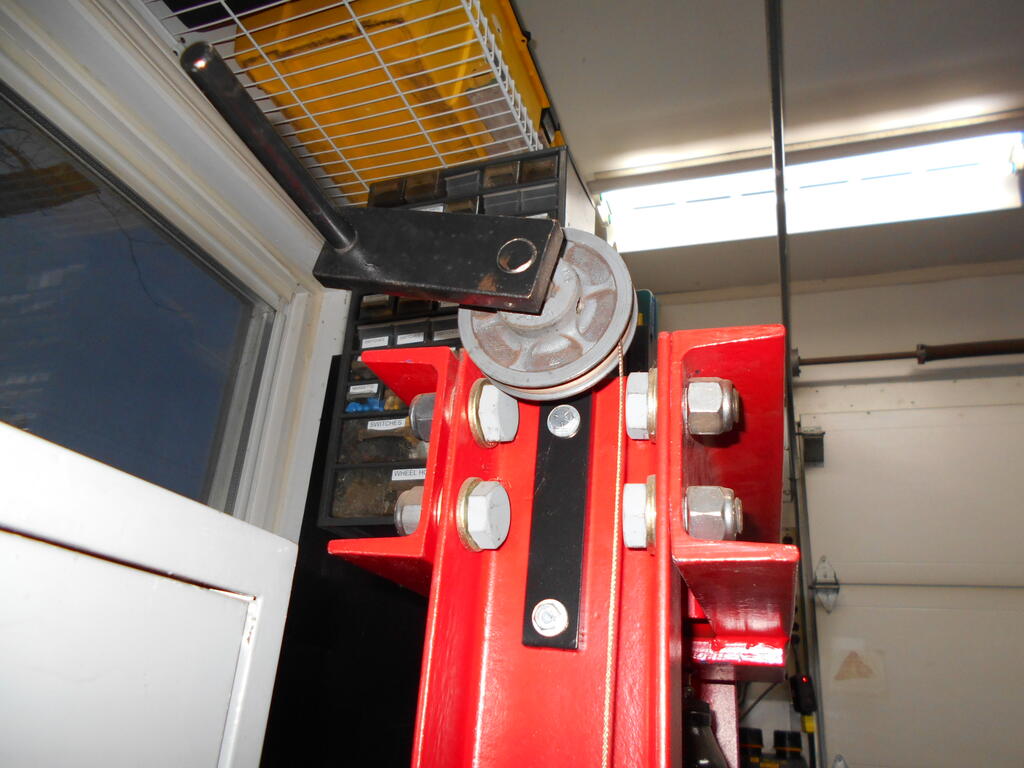

cleat 8,750 #5 Posted June 22, 2020 I love my press and have used it a lot over the years. I have done 3 mods to mine. 1) put it on castors so I can move it. 2) put in a speed lift jack so it only takes a few pumps to lower the ram (yours may be this way already, I don't know) 3) Added a cable lift system to the table to make adjusting the height a breeze. You will wonder how you did without it. 1 1 Share this post Link to post Share on other sites
cleat 8,750 #6 Posted June 23, 2020 I did one more thing that I forgot to mention before. I made up a short handle for the jack that I use 90% of the time. The only time I use the long handle that came with the jack is when I am maxing it's capacity. I get real nervous at this point especially since this press does not have a safety cage. You get 20 tons of force exerted and something suddenly lets go it gets real interesting real quick. Longer handle gets you another foot or so if distance plus it makes pushing the jack easier. Mine came with the long handle, I just made up the short one. Share this post Link to post Share on other sites
