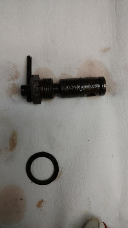

pfrederi 21,007 #4 Posted June 21, 2020 (edited) Two different tow valves here. GT14 is port valve no threads other than the hold nut 67 you should be able to pull it straight out. The C160 valve is a needle valve with threads. 65 is a plastic backer ring it may have gotten jammed/wedged. Edited June 21, 2020 by pfrederi 1 Share this post Link to post Share on other sites

gt14rider 1,275 #6 Posted June 22, 2020 Mine came out hard to, I've had good luck with evaporust, soke or rap went rag around part keep wet , stuff works great. Little tap on back and forth, let it soke, repeat. only has two orings, and a plastic oring, once nut is lose 1 1 Share this post Link to post Share on other sites

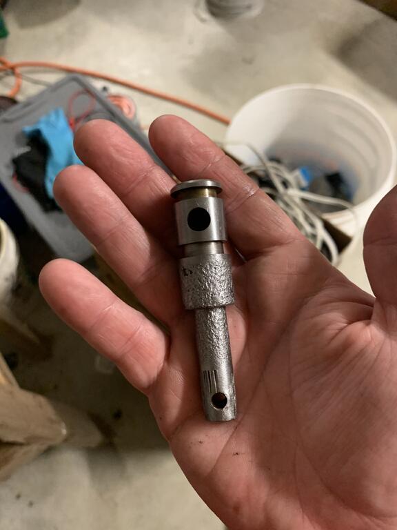

Jhensley87 10 #8 Posted June 28, 2020 Finally got it out. 2 Share this post Link to post Share on other sites

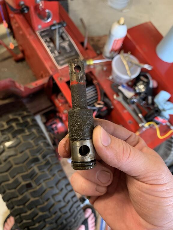

Jhensley87 10 #9 Posted June 28, 2020 Vinegar soak. 3 Share this post Link to post Share on other sites
pfrederi 21,007 #10 Posted June 28, 2020 Guess she sat outside for a long time.... Check pinned topic on Sunstrand o rings. Share this post Link to post Share on other sites
Jhensley87 10 #11 Posted June 28, 2020 48 minutes ago, pfrederi said: Guess she sat outside for a long time.... Check pinned topic on Sunstrand o rings. Actually, it’s never been stored outside. That’s why it was so strange. Undoubtedly at some point it got some moisture in there some how. Thanks for the info Share this post Link to post Share on other sites
