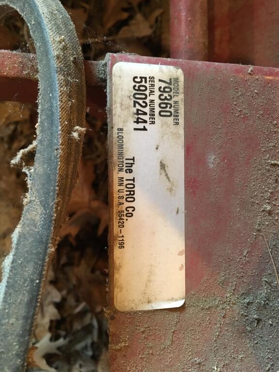

TonyToro 1,166 #1 Posted June 20, 2020 I was just offered a really good shape 42 inch snow thrower. I was wondering if this snow thrower model number 79360 will fit my Wheel Horse C -145? Any help would be appreciated since this snow thrower will serve us very well! 1 Share this post Link to post Share on other sites
squonk 46,657 #2 Posted June 20, 2020 Tall shoot single stage! You bet! Here is a video of my 79360 on a C-145 I used to have. 1 1 Share this post Link to post Share on other sites
