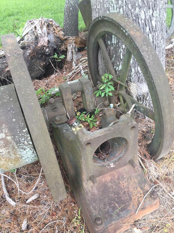

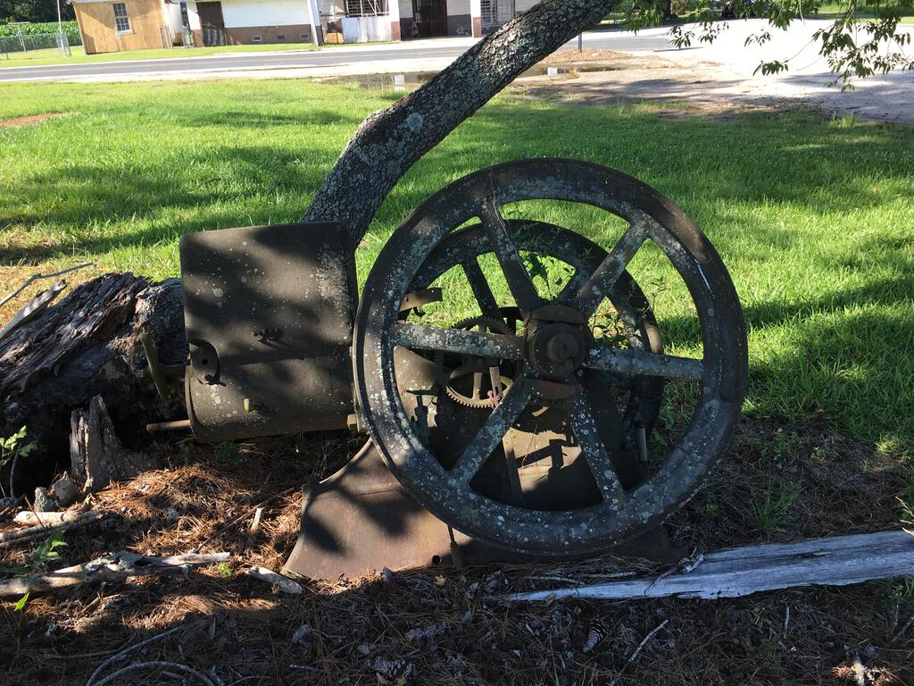

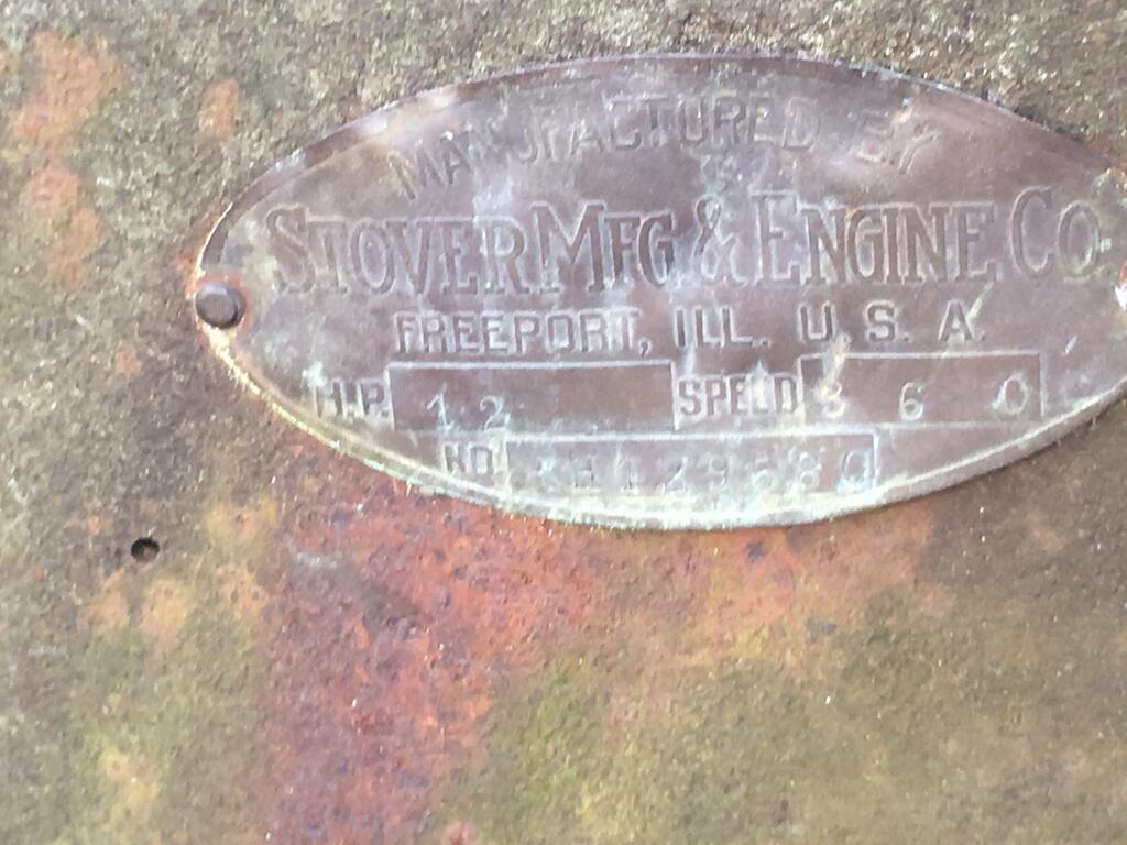

Mattmoore94 0 #1 Posted June 20, 2020 (edited) I found this stover hit and miss engine and I’m trying to learn more about it. The owner told me to make an offer but I don’t know wher to start. There are two. They’re missing the pistons rods and many more parts. I’m also trying to determine a weight as to wether or not my trail or could even hold it. Any help would be appreciated. Is it worth buying? Is there any hope of finding parts? Or is just the shell worth it? Edited June 20, 2020 by Mattmoore94 Auto correct changed the first word in the title Share this post Link to post Share on other sites

ZXT 2,402 #6 Posted June 20, 2020 Being a 12HP, that engine is going to be better than 2,000 LBS if it is complete. Certainly worth getting, even if you just resell it to a collector for parts/restore. Is the hopper busted on the one? Looks fine but I can't see the other side. There are people out there who would love to have parts off of those.. They certainly aren't making them any more! Very cool find regardless. If I were in your position, I would drag them home.. But then again, I'll drag just about anything home Welcome to the forum! 2 1 Share this post Link to post Share on other sites

Stepney 2,357 #10 Posted June 21, 2020 That is a BIG engine and would be a major labor of love to restore to working order. You will be into a lot of custom parts. All in all she will come in to total about 1650lbs. That's what the one I work on weighs. I think this one is 1913. I am actually helping with the restoration of nearly the same engine, a 12hp Stover that ran a local sawmill. If you want to play that engine game, do yourself a favor and subscribe to SmokStak. It's an online forum for all things old engines, like RS is to us. There are some rare parts on that engine.. IF someone needed them, you have gold... The thing is, there's pretty much nothing (important) left on that hulk, notwithstanding the badge and timing gear. Seeing the bracket hanging off the somewhat complete one, I would bet anything the low tension ignitor ignition failed and it was fitted with a more modern WICO EK mag before being retired. All your trip linkage is gone. Ignitor/head are gone. Carb gone.. they aren't incredibly rare but you won't likely see another 2 in the same place. Value..... Scrap value.. sorry.. but thats it. If the guy cares at all and wanted them preserved they'd better be free to .. maybe low hundreds tops to cover the iron value. Your looking at thousands in restoration unless you get incredibly lucky. I'd see if he knew their original locations or any previous hands who may have had something to do with it.. never know. You may just track down some of the old parts. If those bits are missing off both there's a good change there had been a third either owned or the parts sold off to keep her operable. Where it could be now is anyones guess. But it never hurts to try. I've followed the trail a time or two, I've had a dozen or more engines. Did see the fuel pump there on one.. again.. not easy to find so that's a plus. That would be a massive undertaking. This one we are restoring was mostly complete and even turns over. 2' braze along the bottom of the jacket and a new sleeve later, mechanically she's almost ready to roll again. 2 Share this post Link to post Share on other sites
