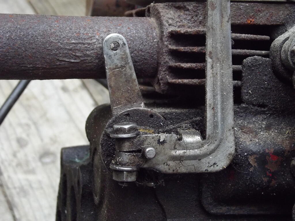

JAinVA 4,638 #1 Posted June 18, 2020 I picked up a complete Kohler k181 8 horse that was supposed to have been removed from a Wheel Horse.This engine is governor controlled with no provision for throttle.My question for you guys who have or had an 8 horse on a WH,is is this how a K on a GT is supposed to be set up? Share this post Link to post Share on other sites

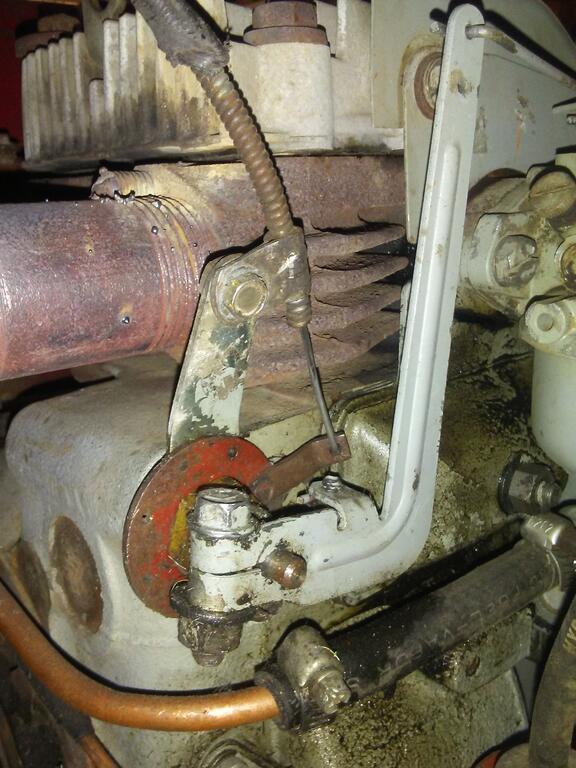

kasey54 305 #3 Posted June 18, 2020 I have some. Throttle cable connects to circular disc on the stem of the governor shaft. There are several holes in that disc. 4 1 Share this post Link to post Share on other sites

JAinVA 4,638 #6 Posted June 18, 2020 (edited) Eric,when you get a chance it may help.This is what I have looks like.Truth be known what I plan for this engine constant speed would work. Edited June 18, 2020 by JAinVA Share this post Link to post Share on other sites
gwest_ca-(File Mod) 12,490 #7 Posted June 18, 2020 The governor arm must have been slipping on the shaft because they torqued the bolt so tight they bent the bolt. The arm is collapsed under the bolt so cut or file some clearance so it will tighten with less force. Garry 1 Share this post Link to post Share on other sites
Sam Pasch 450 #8 Posted June 18, 2020 Yup. That's what its supposed to look like. The throttle goes in the lever thing on the right of the disc like on my 867. 1 1 2 Share this post Link to post Share on other sites
JAinVA 4,638 #9 Posted June 19, 2020 Sam, Thank you very much.That picture is what I needed.I will save it for future reference.Garry,a new arm is on the way!Thanks for the response. 3 Share this post Link to post Share on other sites
