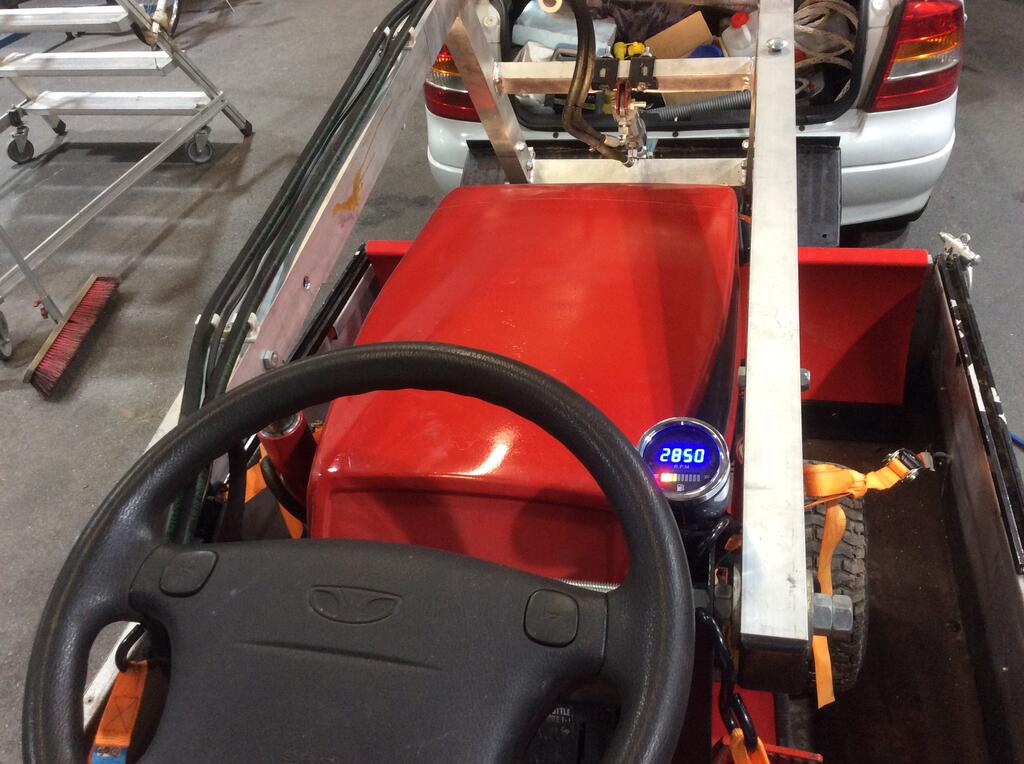

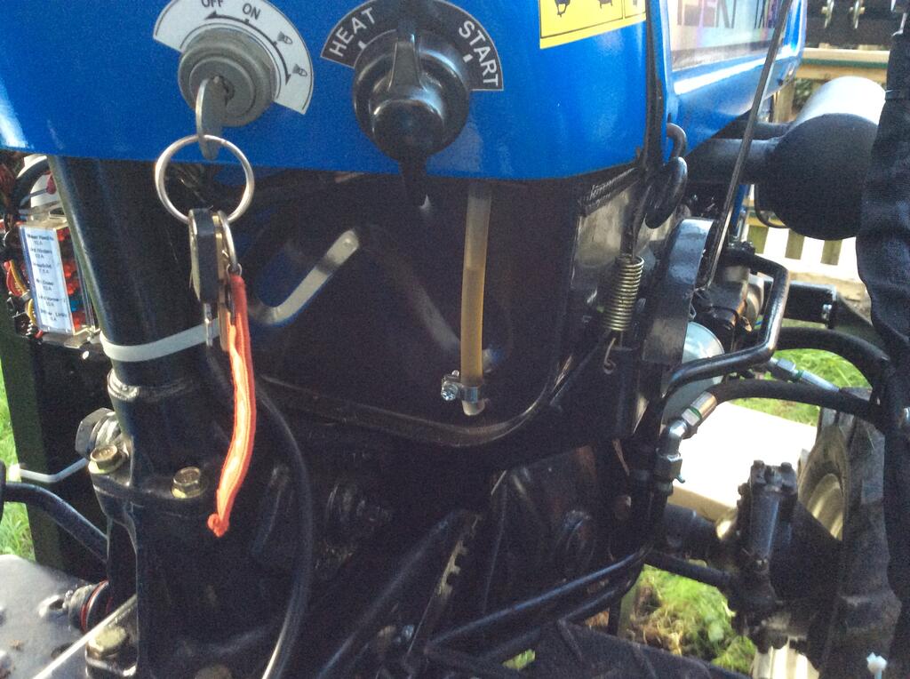

Tractorhead 9,217 #30 Posted June 19, 2020 @meadowfield i tryed the rpm / fuel gauge combo on my 212, because the fueltank is under the hood, but i found that it works not pretty well. this combo can be seen on the right side of the Dash outside. - yap, i know wrong steering wheel but this was just one i had laying aside and no the Airbag wasn‘t in it - 😂 if it shows the Fueltank is empty i‘m close to half full. even after i had calibrated it as the manufacturer suggested several times. The reaction of that fuel gauge is pretty slow. On my Beast i have the transparent pipe version, that works really well for me. A quick view and i‘m informed about fuel. it is a good indicator for long term trips, not to reach the „never comeback“ line. 2 Share this post Link to post Share on other sites

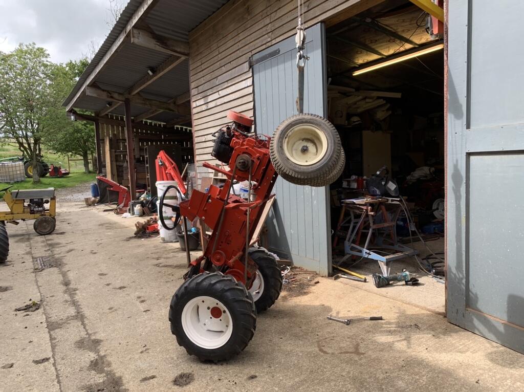

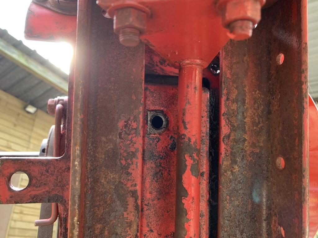

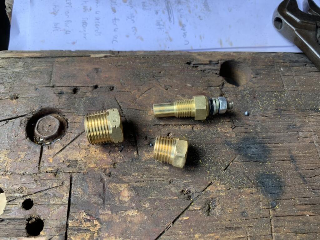

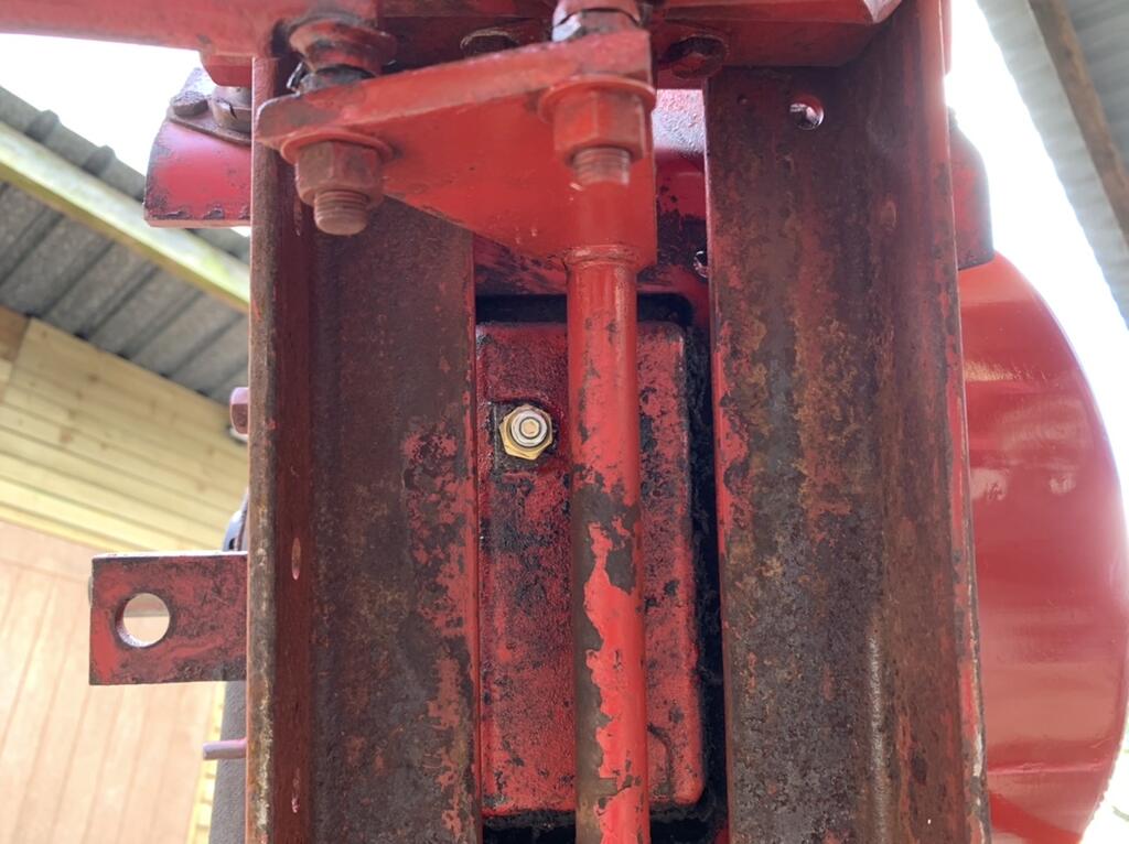

meadowfield 3,190 #40 Posted June 22, 2020 Installed the oil sender yesterday.... as the oil was new and didn’t want to drain it - I had to be ingenious good job I have my crane... I wasn’t sure whether the pan was 3/8 or 1/2 NPT so bought a mix of adapters. The sender is 1/8” bsp. proof that no oil was lost finished and in place. now to make the wiring loom - as this tractor had nothing! 3 Share this post Link to post Share on other sites
WHX?? 58,058 #41 Posted June 22, 2020 What's your plan to drain the oil, just remove the sender? No room to put a tee in there? 1 Share this post Link to post Share on other sites
meadowfield 3,190 #42 Posted June 22, 2020 (edited) 1 hour ago, WHX24 said: What's your plan to drain the oil, just remove the sender? No room to put a tee in there? yeah, a long 9/16 socket fits over the whole lot. Just the wire to pull... I figure it will read quicker if the sender is in the pan - though the oil and pan will all get to temp. Edited June 22, 2020 by meadowfield Share this post Link to post Share on other sites

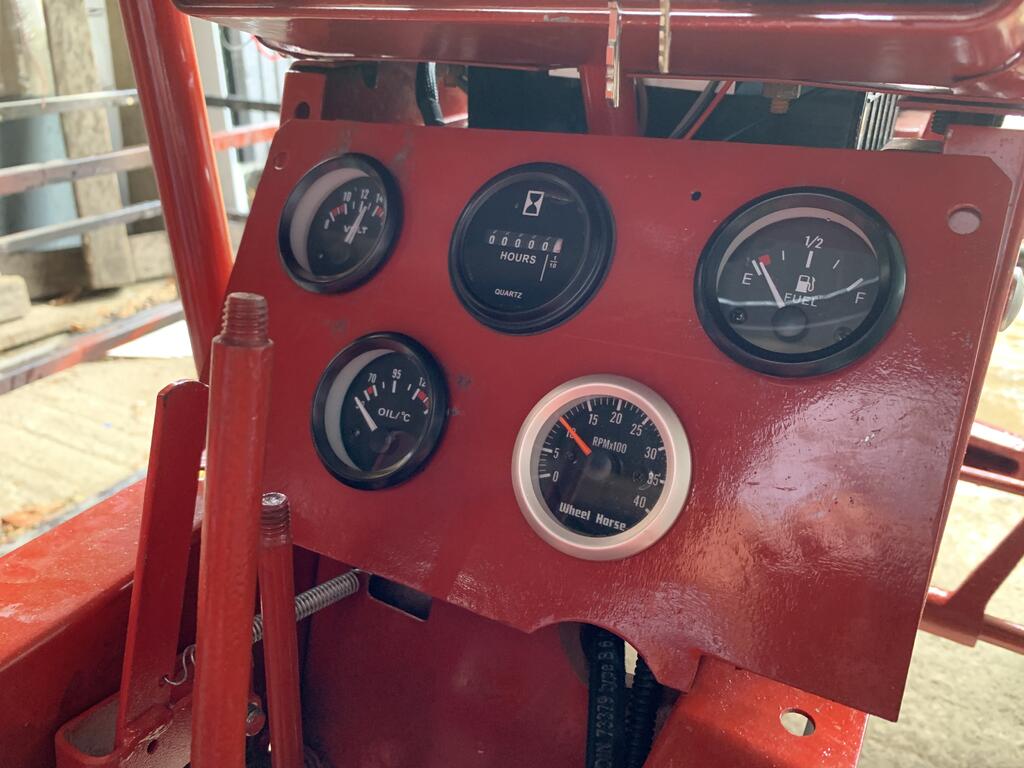

meadowfield 3,190 #44 Posted June 28, 2020 Final gauge came, all wired in and working. Not had engine hot enough yet to move the oil temp. 2 Share this post Link to post Share on other sites
