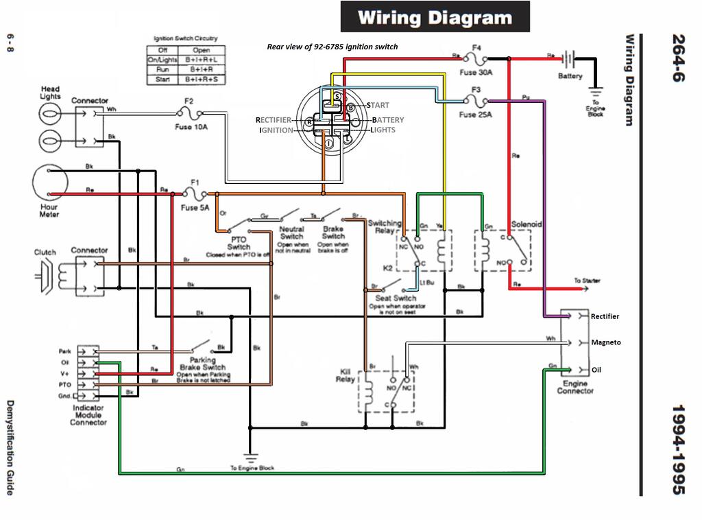

gwest_ca-(File Mod) 12,416 #3 Posted June 18, 2020 So you still have the ignition problem? You realize this engine has magneto ignition which is self-powered. Do not allow any battery voltage to get to the ignition wire as that will instantly burn up the coil. This model uses a battery type of ignition switch to control a kill relay to control the magneto ignition. The relay simply grounds the ignition wire to shut it off. The pto must be off, the transmission in neutral and the parking brake applied to get spark. If there is an operator in the seat the above conditions are not required and you should have spark. Hope these diagrams work. The serial number of the tractor identifies the model year 49xxx, 59xxx and 69xxx for 1994, 1995 and 1996. The diagrams are listed for 1994 and 1995 only. Keep us posted with your progress. Garry 2 Share this post Link to post Share on other sites
gwest_ca-(File Mod) 12,416 #4 Posted June 18, 2020 Threw some color at the large schematic and found a mistake in it so this may help. Garry Share this post Link to post Share on other sites
stolmar 35 #5 Posted June 18, 2020 Gentleman. Thank you so much for your replies. The seat has been changed by somebody so i will follow up with that, with the owner and go from there. There is no switch on it now. i will post my findings. Again, Thank you. Share this post Link to post Share on other sites
stolmar 35 #6 Posted June 19, 2020 Well my fellow wheel horse men and ladies. I finally got back to this tractor and was pleased to find it to be the brake safety switch. It is now up and running beautifully for his grand kids.Thank you for the Quick reply 1 1 Share this post Link to post Share on other sites
