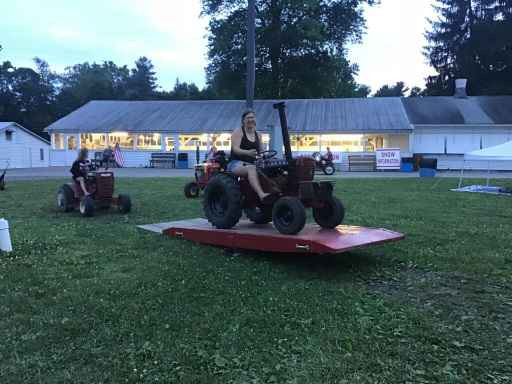

Sam Pasch 450 #14 Posted June 19, 2020 I would really like to build a big wheel, round hood, row crop tractor. I think that would be pretty awesome. Probably won't ever do it though (time, space, money). 1 1 Share this post Link to post Share on other sites
Pullstart 71,521 #15 Posted June 20, 2020 On 6/18/2020 at 8:13 PM, Sam Pasch said: I would really like to build a big wheel, round hood, row crop tractor. I think that would be pretty awesome. Probably won't ever do it though (time, space, money). that’s quite the mashup! “Frank” is quite similar. I imagine with an 8 speed or 3 speed even, things would have been much easier. 1 1 1 Share this post Link to post Share on other sites

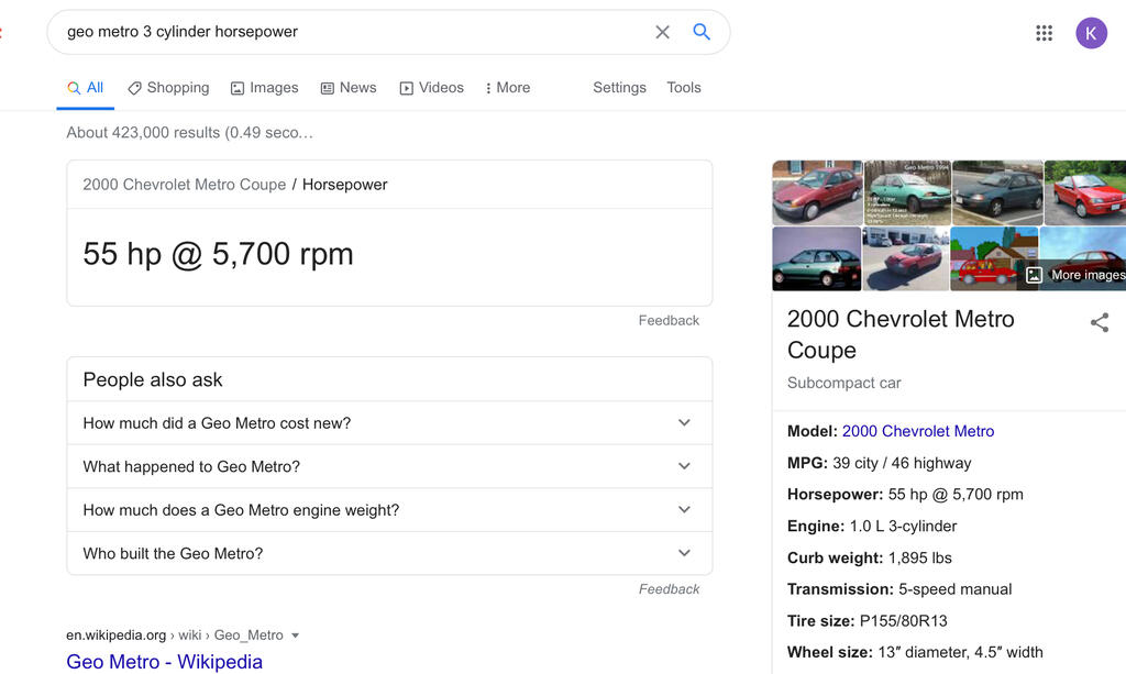

Tractorhead 9,218 #21 Posted June 21, 2020 (edited) Is the Metro Engine the X10XE Version ? Edited June 21, 2020 by Tractorhead Share this post Link to post Share on other sites
johnnymag3 2,646 #22 Posted June 21, 2020 9 hours ago, Tractorhead said: Is the Metro Engine the X10XE Version ? Its a base 55 HP engine, with 49.000 miles on it Share this post Link to post Share on other sites
Tractorhead 9,218 #23 Posted June 21, 2020 (edited) Sounds correct, i meant the Engine Code from GM. 0,9L 54PS 3 Cylindre Engine with Valvesteering via chain. i dunno the chevy Metro, but it seems that’s the Car here sold under Opel Corsa B thinking the same Engine we‘re talking about. They have a wide usable speedband, but best torque band is from 1750 up to 3480 RPM below there is not much torque, above the torque nearly stalls. the injection system is here coupled with a Transponder for theft protect, i think the same on your site. So if you like to use this Engine, you need the Engine Control Unit, what is on the Engine side mounted, the Transponder engine with Antenna (marriaged together with ECU) and a Wireharness for the lambda sensor. Otherwise that engine will just fireup for 3 sec. Than it stalls. Or you wanna built a complete own ECU yourself. Edited June 21, 2020 by Tractorhead Share this post Link to post Share on other sites

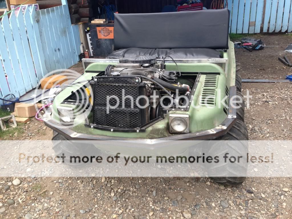

16 Automatic 53 #24 Posted June 21, 2020 I have seen them power 8 wheels with tracks with no problem. 2 Share this post Link to post Share on other sites
