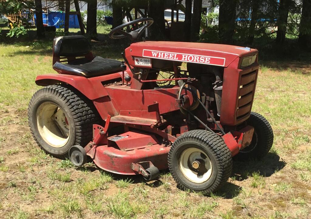

Mike C160 251 #1 Posted June 17, 2020 Greetings. Looks like the frame has failed from stress where the seat hinge attaches. Is this common? I am in the process of repairing correctly now. There was a Botched up job there. And they elected to move the seat back tow more inches with some angle iron..... I need a parts machine... Now vacuuming 45 years of grass and associated compost out of the shifter tunnel.... oh joy. Cheers - 2 Share this post Link to post Share on other sites

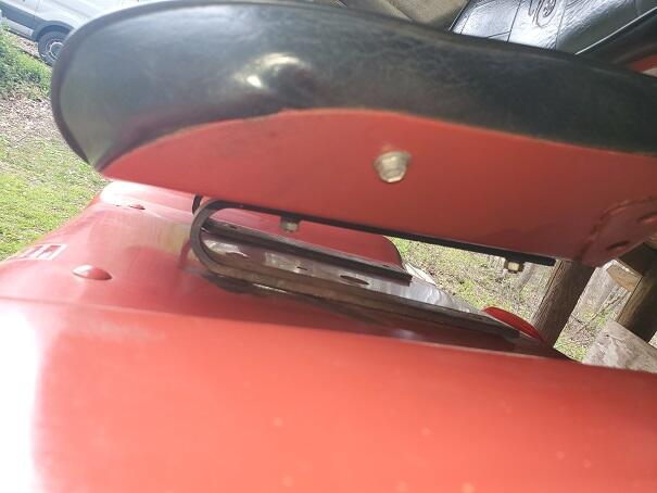

Mike C160 251 #8 Posted June 18, 2020 I only noticed this now. Look at the two photos. My tractor is missing the seat springs! I didn't notice till now! The previous owner was easy 300 pounds. I guess this explains all the problems with the rear fender cover and hinge. The rear fender cover was not only damaged when he back into something, but it's full of stress cracks where the seat bolts on. I need to dig up that rear fender cover, another hinge and now the seat springs. 6 1 Share this post Link to post Share on other sites
ebinmaine 81,289 #9 Posted June 18, 2020 My tractors are woods runners and the forest is VERY rough. I don't use seat springs because I don't like the pitch and roll. I have a nice set I'd sell cheap. The freight and border charges would be a kicker though. 3 Share this post Link to post Share on other sites

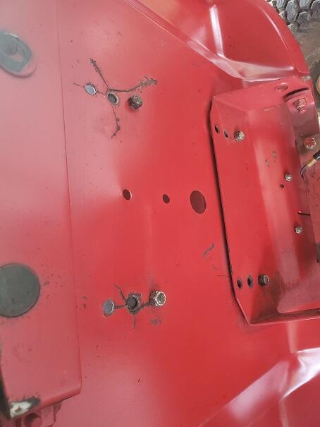

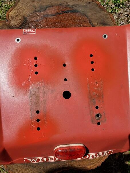

GAJoe 852 #12 Posted March 26, 2023 (edited) I need pictures of this fixed correctly. When I noticed the cracks and realized that the front connection of the seat spring would cause the thin gage seat pan metal to be flexed both up and down I thought that these seat springs must be a modification by the owner. Then I find this thread. Wow! I can't believe that they did this. I cleaned the paint off so that it's ready to weld. But after that is repaired then a change needs to be made to prevent the seat pan from flexing. Edited March 26, 2023 by GAJoe 1 Share this post Link to post Share on other sites
ebinmaine 81,289 #13 Posted March 26, 2023 5 minutes ago, GAJoe said: this fixed correctly I can't say it's correct but I've been known to add a very large washer or two there. 1 Share this post Link to post Share on other sites
squonk 48,429 #14 Posted March 26, 2023 I fixed my neighbor's C-160 by using a good seat pan from a Commando. Made a little different and it took minor work to do it 1 Share this post Link to post Share on other sites
Handy Don 17,740 #15 Posted March 26, 2023 (edited) 47 minutes ago, GAJoe said: cleaned the paint off so that it's ready to weld. If it were mine, I’d put a reinforcing patch at each hole to strengthen the fender and distribute the load. 1. drill a hole at the end of each crack to relieve any residual or future pressure to extend the crack (⅛” is enough) 2. grind the cracks lightly to prep for welds then use tack welds to gradually close each crack (avoid too much heat at one time in any area to prevent warping!) and grind as needed 3. clean and prime with Rustoleum (or equivalent) rust preventative 4. cut a square sheet metal patch that extends over the entire set of cracks for each hole (I’d use ⅛” or 3/16” sheet) and bevel its edges 5. lightly grind off the paint on the fender pan where the patch edges fall 6. weld the patch to the fender with a series of tack welds. It isn’t necessary to completely close up the edge of the patch but if you have the time...(again, avoiding concentrations of heat that will warp the fender and/or the patch) and grind as needed 7. Drill the patch for the seat mounting bolt 8. Clean, prep, and paint the patch & bolt hole (if you want to "gild the lily” for extra rigidity, then before you weld on the patch you can drill additional holes in the fender pan that will fall under the patch and then from the underside of the fender, do tack welds of the fender to the patch at the edges of those holes) Edited March 26, 2023 by Handy Don 2 1 Share this post Link to post Share on other sites

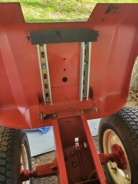

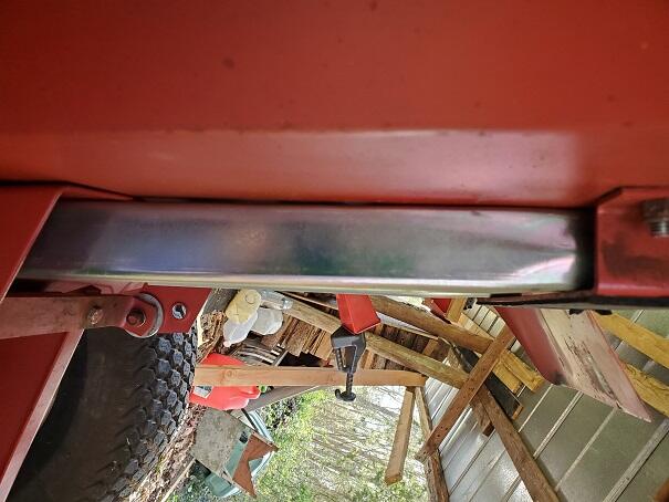

GAJoe 852 #21 Posted April 1, 2023 (edited) Got it welded up. It's not beautiful and the paint that I have is a shade off but it's under the seat. And added Superstrut to the seat pan to support the weight load and keep the seat pan from cracking again. Edited April 1, 2023 by GAJoe 5 1 Share this post Link to post Share on other sites
