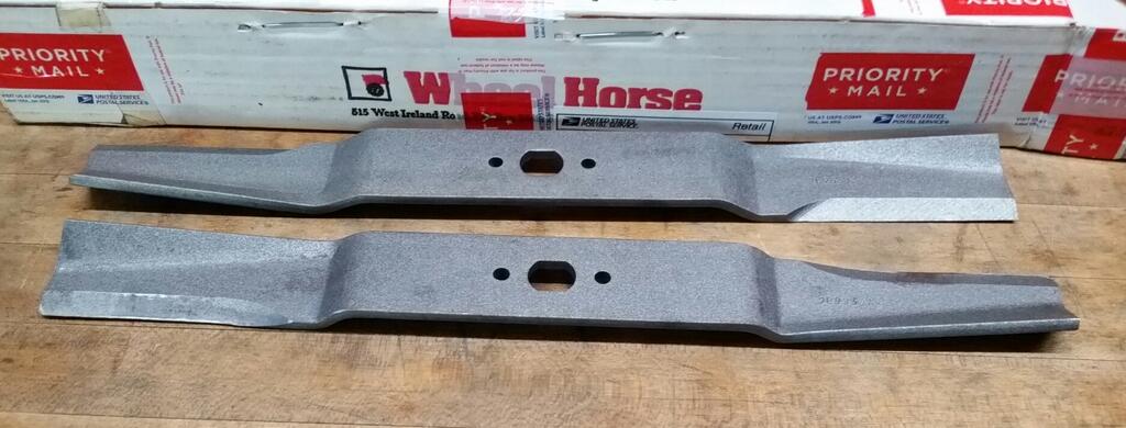

gwest_ca-(File Mod) 12,259 #3 Posted June 16, 2020 32" width of cut. 8777 2-blade set replaces 3719, 7760 and 7909 left blades and 3718, 7761 and 7908 right blades Most places list them as no longer available. This one still shows them at $92 a set. https://www.psep1.biz/arinet.asp#/s/TO//8777/1/ Garry Share this post Link to post Share on other sites

rjg854 13,064 #6 Posted June 17, 2020 I have a set here (8777) and I have nothing to put them on, at the moment. They are brand new still in the box. I'll try and look up what I paid for them, that plus shipping and you can have them. Share this post Link to post Share on other sites
Schmendrickthemagnificent 22 #7 Posted June 17, 2020 think you could take a pic of them so i can see wtf everyone is talking about, but yes very very interested in acquiring them Share this post Link to post Share on other sites

rjg854 13,064 #10 Posted June 18, 2020 Here's what I have if you're interested PM me 1 Share this post Link to post Share on other sites
