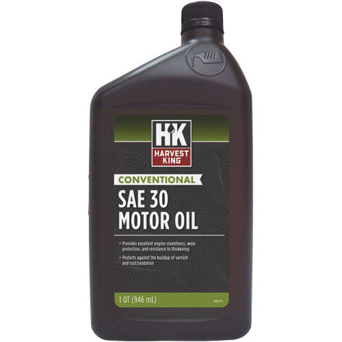

bottjernat1 2,197 #11 Posted June 16, 2020 Here is what i used in a 856 i sold and my 1973 no name i have. still working good no issues! VID_20200427_182917437.mp4 1 Share this post Link to post Share on other sites
bottjernat1 2,197 #12 Posted June 16, 2020 (edited) In the engine as stated everyone has there way of doing things. I grew up my late dad used sae 30 all year around the manuals call for most k series to use a lighter oil in the winter. My dads theory was if your really using your machine in the winter you are going to get it just as hot as you would in the summer. I have stuck with sae 30 all year around in the old cast iron blocks and never ran into an issue ever. Of course some of this new stuff cant hack the thickness of oil like the old gals can so to be on the safe side do as the manual says! My theory on oil in the old k series is i like the oil thick just like my lady! And I dont have any issues with her either. LOL! This is what i use in the engines in the old gals Edited June 16, 2020 by bottjernat1 Share this post Link to post Share on other sites

Howie 900 #16 Posted June 17, 2020 That oil pictured above is rated SN so it is a deteergent oil. I buy quite a bit of it. Share this post Link to post Share on other sites
