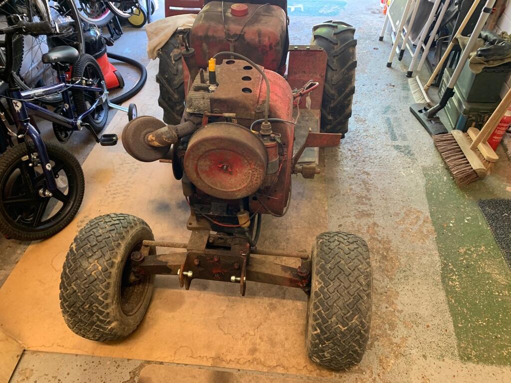

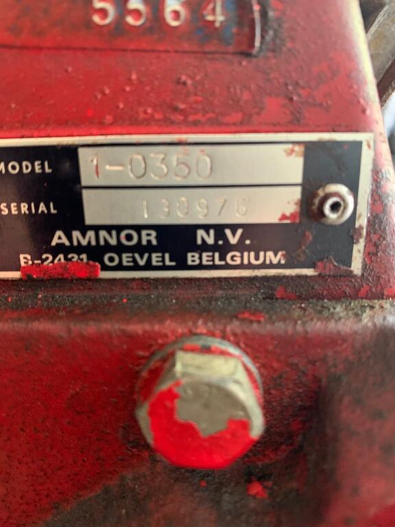

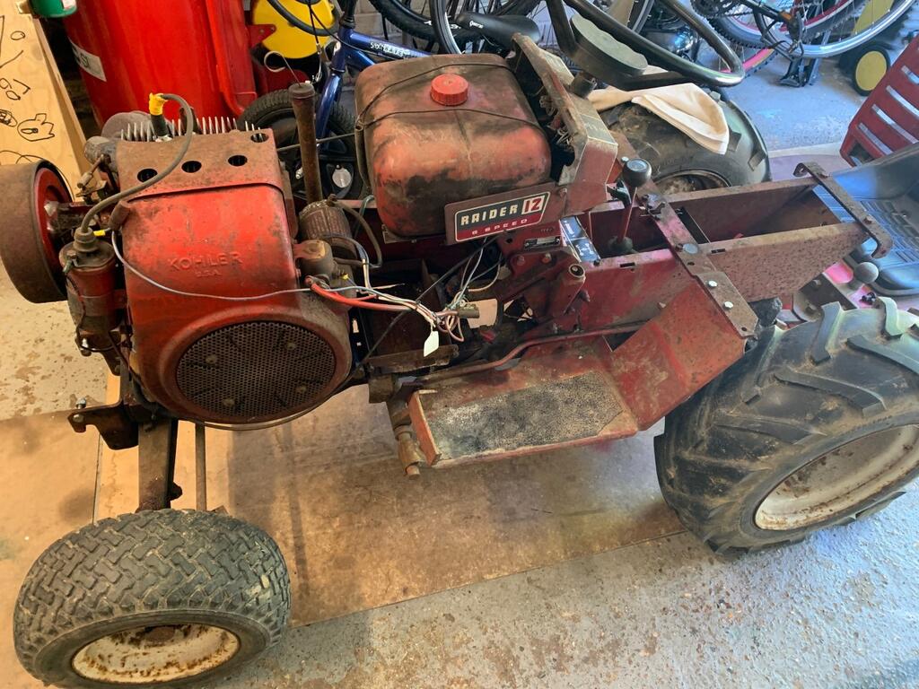

AliT 13 #1 Posted June 16, 2020 Morning Please can someone help me determine which wheel Horse this is, the only reason I am asking is the engine is only mounted to the frame with 2no bolt as the holes the other side over hang the frame. The plate says its a Raider 12 but I am wondering if the main frame is different?? Please see attached photos 5 Share this post Link to post Share on other sites
kasey54 305 #2 Posted June 16, 2020 I believe you will find bolts underneath frame up into tapped holes into the bottom of the engine. Looks original to me. K301 2 1 Share this post Link to post Share on other sites
rjg854 13,190 #3 Posted June 16, 2020 just as Kasey said, 2 bolts go up into the engine from underneath. 1 Share this post Link to post Share on other sites

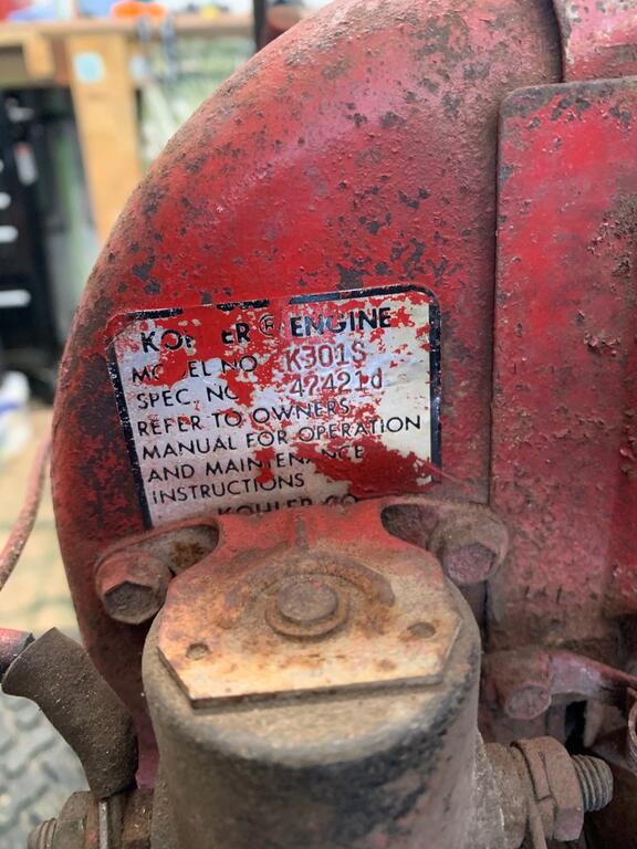

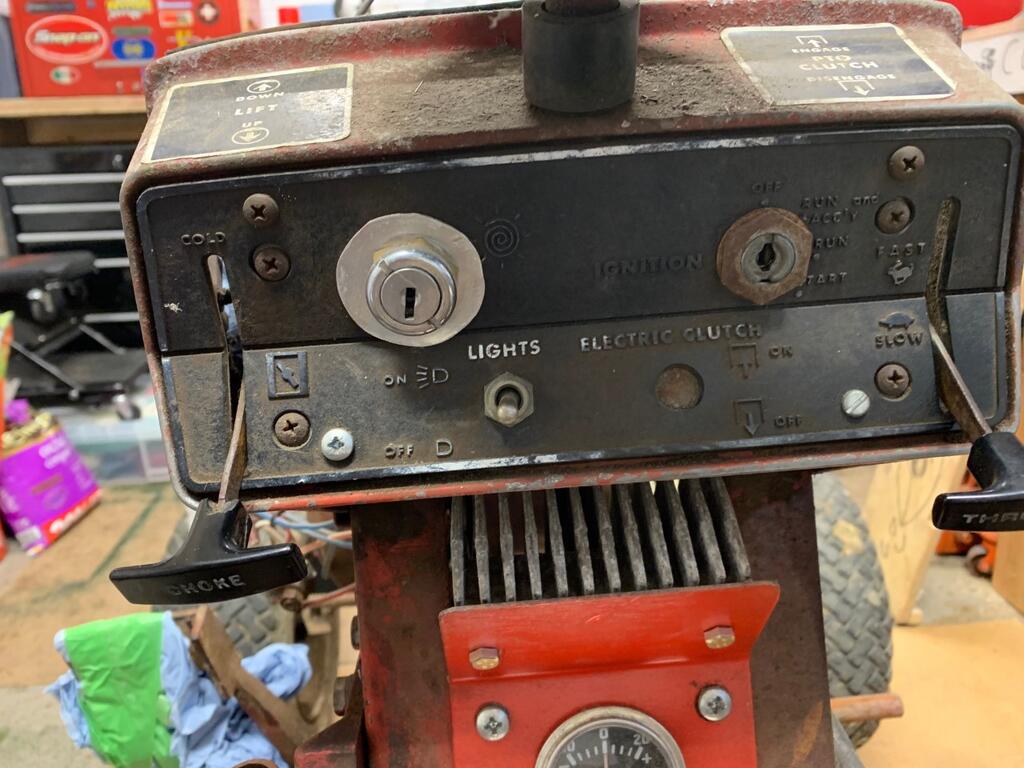

Ed Kennell 46,596 #5 Posted June 16, 2020 You have an original 1973 Raider 12 with a Kohler K301S-47421D 12HP engine and Kohler 5073 8 speed transmission. The second ignition switch in the lighter hole is not original. The right side engine mounting bolts are tapped in the block and inside the frame as Kasey said. to the 2 Share this post Link to post Share on other sites

gwest_ca-(File Mod) 12,357 #10 Posted June 16, 2020 Welcome to the forum. In North America this model was named a 1973 12hp 8-Speed but the Raider name continued for exported models. Here is what we have for the model number 1-0350. The search results are mixed up so look through them all. https://www.wheelhorseforum.com/search/?q=1-0350&quick=1&type=downloads_file Garry 2 Share this post Link to post Share on other sites

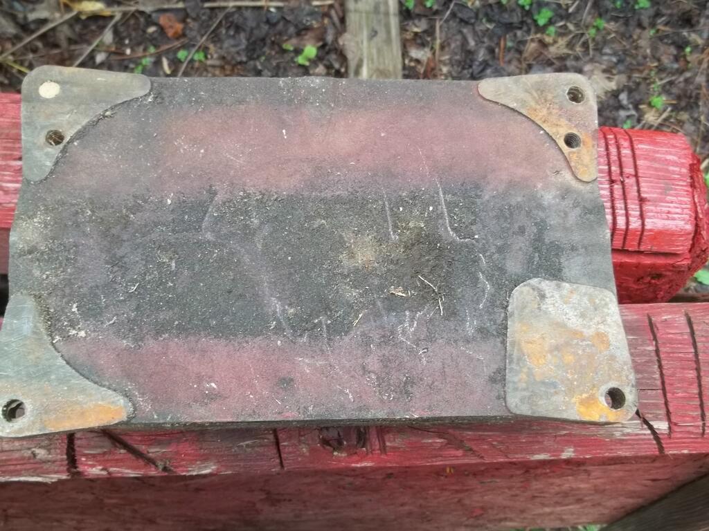

953 nut 67,418 #12 Posted June 16, 2020 Glad to see the will stay in the family ans will be given some love. As you go along please post your s and be sure to ask any questions that come along. Here is what the oil pan looks like. 1 1 Share this post Link to post Share on other sites
