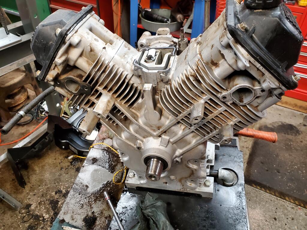

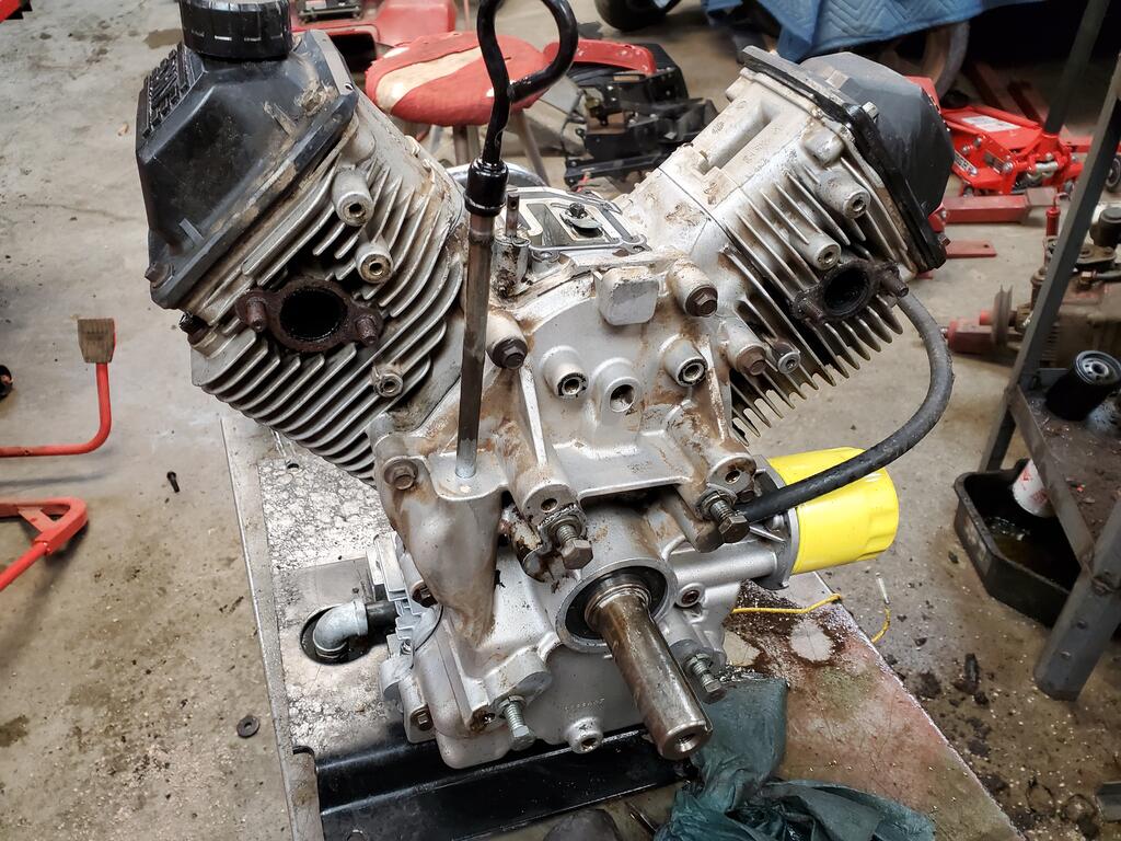

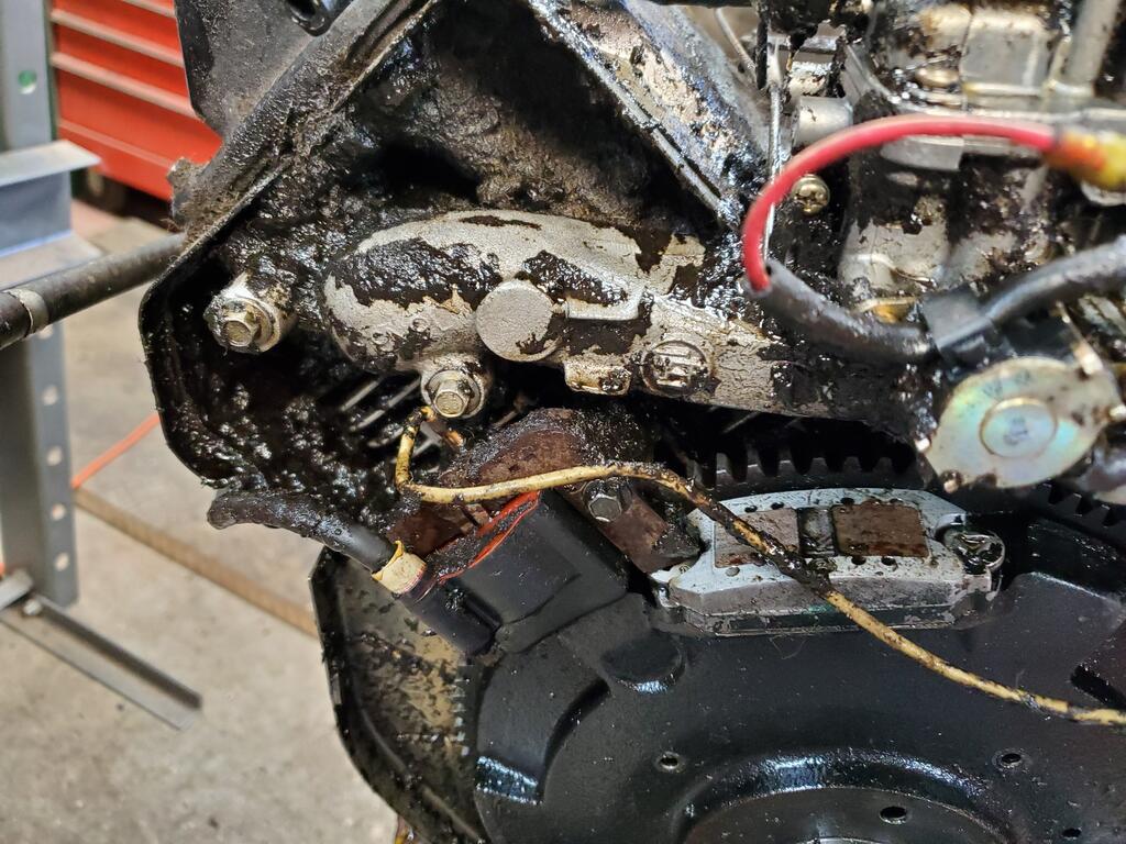

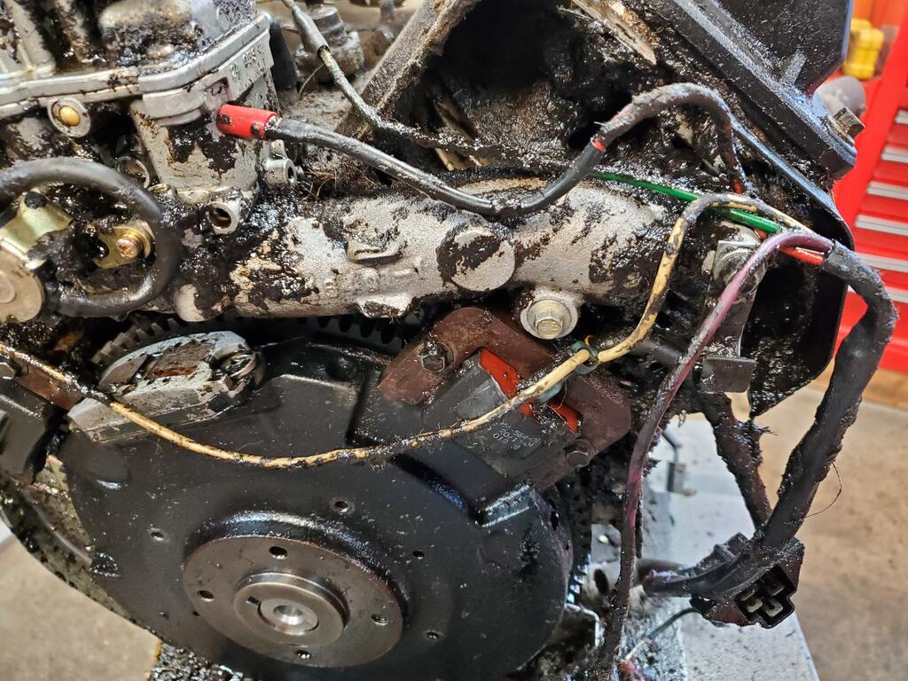

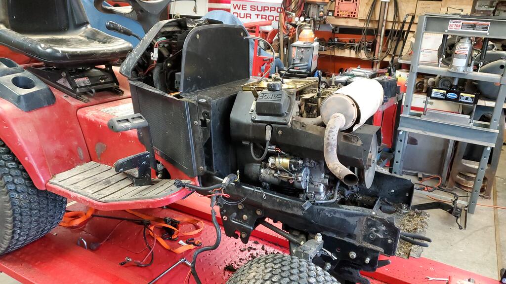

stevebo-(Moderator) 8,742 #20 Posted June 23, 2020 Anyone here know if I have to pull the motor in order to get to the intake gaskets? I have not looked hard but at quick look it may not be possible to remove tins on top to access in the tractor. Share this post Link to post Share on other sites
Shynon 7,728 #21 Posted June 23, 2020 You may be able to move the plate between engine and steering to access the flywheel cover and move it toward the steering shaft. To get to the intake bolts. Share this post Link to post Share on other sites
stevebo-(Moderator) 8,742 #22 Posted June 23, 2020 Thanks pal. Not looking forward to this job 1 Share this post Link to post Share on other sites
