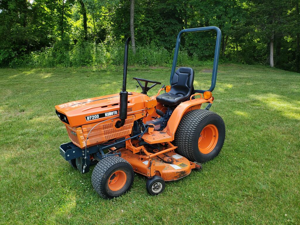

71_Bronco 1,072 #10 Posted June 14, 2020 Quick update. The tractor is mine now. It was originally bought new in 1986 by my grandfather. It is a B7200 with a 60" belly deck, currently sitting at ~1,400 hours. My grandfather bought it new, and sold it when he bought a new, bigger Kubota. After passing almost 2 years ago, the bigger kubota went to my dad. After changing owners a few times, my dad caught wind it was for sale, and bought it for me. It needs a few little things like a new deck belt and a little TLC, but for 34 years old, it looks pretty dang good. Starts right up (after doing the glo plugs) and purrs beautifully. As far as I know, it hasnt ever had any big attachments on it (like a loader). Only the occasional york rake, and mostly mowing duty. Oh, and I have the original manual, sales brochure, and signed bill of sale from 1986 with my grandfather's name on it. 3 Share this post Link to post Share on other sites

WHX?? 57,957 #13 Posted June 14, 2020 And the pics are where??? Share this post Link to post Share on other sites
71_Bronco 1,072 #14 Posted June 15, 2020 21 hours ago, WHX24 said: And the pics are where??? Here she is 2 2 Share this post Link to post Share on other sites
71_Bronco 1,072 #15 Posted June 15, 2020 According to the build tag, the motor is a D950, 3 cylinder diesel, output is 17hp at 2,500 rpm. From what I found online, that motor has the spherical combustion chamber, so that would be the indirect type mentioned above. Share this post Link to post Share on other sites
bc.gold 3,406 #16 Posted June 16, 2020 (edited) 4 hours ago, 71_Bronco said: According to the build tag, the motor is a D950, 3 cylinder diesel, output is 17hp at 2,500 rpm. From what I found online, that motor has the spherical combustion chamber, so that would be the indirect type mentioned above. Maintain the glow plugs, they can be tested as installed, keep the battery fully charged if the starter shows signs of being sluggish have it repaired and keep starting fluid away, never leave the key in the ignition inviting unauthorized use. Leaving the key in my Thomas 233 HD skid steer which had a 6 cylinder Kubota engine a buddy used starting fluid and ruined the engine. I'm sure your Kubota will give you many years of enjoyment. Edited June 16, 2020 by bcgold Share this post Link to post Share on other sites

8ntruck 9,254 #20 Posted September 11, 2021 Nice tractor. Ought to be a good worker. Are those 15" rear wheels? Share this post Link to post Share on other sites
