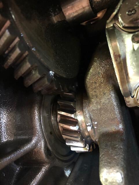

mooman3121 58 #8 Posted June 17, 2020 UPDATE- ok we got the motor out and base off- The timing marks that i highlighted appear to be correct, the crank tooth lines up with the cam mark when rotated- the timing marks on the stem of the advance cam are correct as well- springs on the weights are good and no evidence of excessive wear. Am using the correct marks as those were all I could find..... Share this post Link to post Share on other sites
mooman3121 58 #9 Posted June 17, 2020 Kind of confused by that raised pointer on crank being almost between teeth. Share this post Link to post Share on other sites

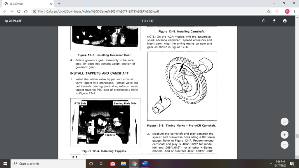

953 nut 62,979 #10 Posted June 17, 2020 (edited) Here are a couple of pictures from an excellent thread @prondzy did on engine rebuilding. Is your points cam properly aligned? Edited June 17, 2020 by 953 nut Share this post Link to post Share on other sites
