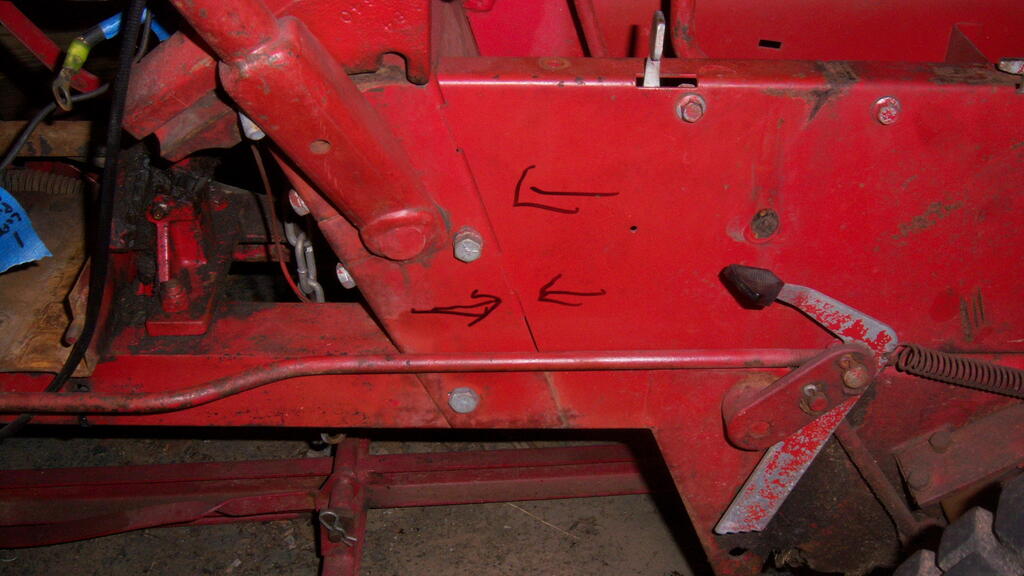

gigi 4 #1 Posted June 12, 2020 I'm restoring a 1967 867. I cannot figure out how to separate the lower part that is bolted to the frame from the dash. I have removed all of the obvious bolts securing it down. It looks like there is some sort of finger joint configuration keeping it in. Refer to the pics. Thanks. Share this post Link to post Share on other sites
Shynon 7,727 #2 Posted June 12, 2020 it's spot welded Share this post Link to post Share on other sites
Pullstart 71,482 #4 Posted June 12, 2020 Yep, it’s not easy to get that apart. I recently did one to make it into a 1045 lookalike. Here’s a link to the build in detail. Share this post Link to post Share on other sites
ebinmaine 81,048 #5 Posted June 12, 2020 6 hours ago, Shynon said: it's spot welded As long as the tabs that hold it in place and the spot welds themselves are in decent shape we leave them alone. Removing paint around the tabs if you're doing a restoration can be a challenge but with patience it's easy enough. Share this post Link to post Share on other sites
