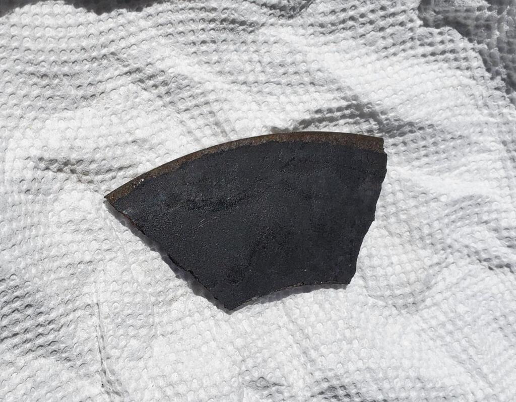

Vinylguy 4,797 #1 Posted June 11, 2020 The good news first. Got a new carb and got the 312-H running great. Reinstalled the air cleaner and shroud then closed the hood and fired it right up at quarter throttle no choke. Now the bad. After about 30 seconds I hear a bang and out flies this piece of dics from the right side. Looks like pressure plate for mule but I cant see where it came from nor any broken parts??? Also found a leak in the front right tire sidewall so off to Tractor supply to get a new tire 1 10 1 Share this post Link to post Share on other sites
ebinmaine 81,150 #2 Posted June 11, 2020 I agree that that looks like your PTO clutch plate. Maybe disassemble that and see what's going on in there? 1 Share this post Link to post Share on other sites
rmaynard 17,644 #3 Posted June 11, 2020 You sure that piece didn't hit the tire and cut it? Looks like a piece of the PTO to me. 1 Share this post Link to post Share on other sites
Vinylguy 4,797 #4 Posted June 11, 2020 Going to get the right front wheel back on and get it to the lake. Have better tools in the shed there and will check out the pto assembly. Thanks 1 Share this post Link to post Share on other sites

Lee1977 7,809 #10 Posted June 11, 2020 My C-120 hucked the hold disk out in a lot of little pieces. That was back when they were riveted on. Share this post Link to post Share on other sites

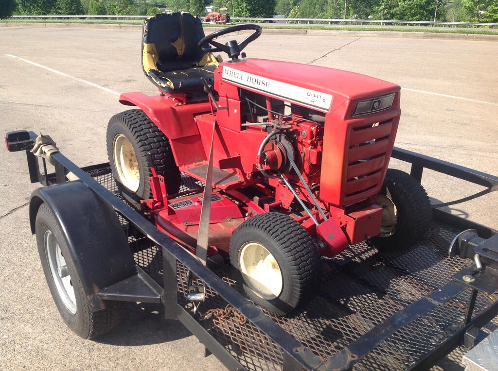

scWHhauler 96 #13 Posted June 13, 2020 I don't know about the Wheel Horse gods being angry but they led me to find my C-141 😀 2 1 Share this post Link to post Share on other sites
c-series don 12,656 #14 Posted June 13, 2020 Can we see more pictures of that C-141? Those 78-79 C- Series are my favorite! 1 Share this post Link to post Share on other sites
