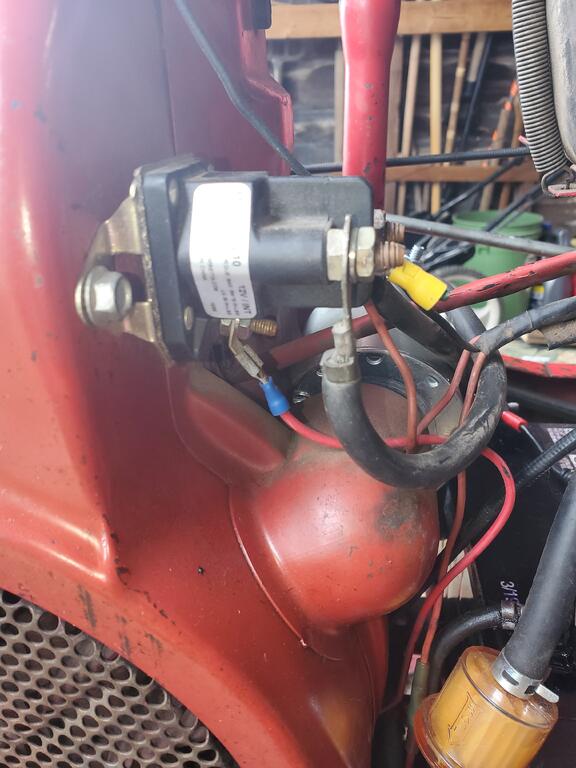

12Horse Paladin 1,038 #8 Posted June 12, 2020 Starter checks out😊, n reconnected the wire to the taillight incase thats a saftey switch (its also the only wire i disconnected on the tractor). Still nothing. No click, nada, zip. ? Tho: See in the pic, off the solenoid...the yellow terminal with no wire running off it...could that b something? It was exactly like that when i got the tractor, tho.... ? Share this post Link to post Share on other sites
12Horse Paladin 1,038 #9 Posted June 12, 2020 ...GOTITGOTITGOTIT!!!!😊😊😊😊 ...turns over great, but imma let it set on the charher awhile cuz i dont think my battery is the greatest n i dont wanna just keep cranking onnit. THANKS EVERYBODY!😁😁😁😁😊😊😊😊 1 Share this post Link to post Share on other sites
