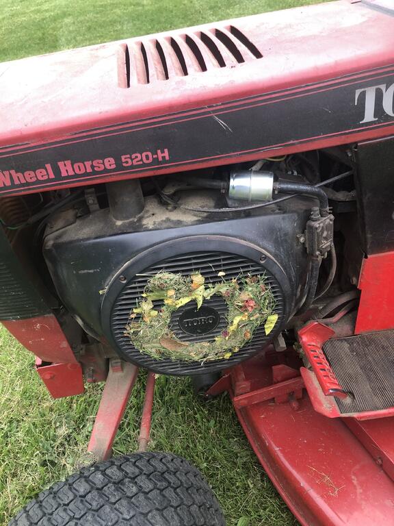

muz123 1,193 #1 Posted June 11, 2020 Over the years of using my 520H to mow grass, it has become a nuisance when the grass gets caught in the flywheel grass screen and you have to reach over and scrape it off so the engine won't overheat or the carb won't get dirty. Anyway to prevent it? Share this post Link to post Share on other sites

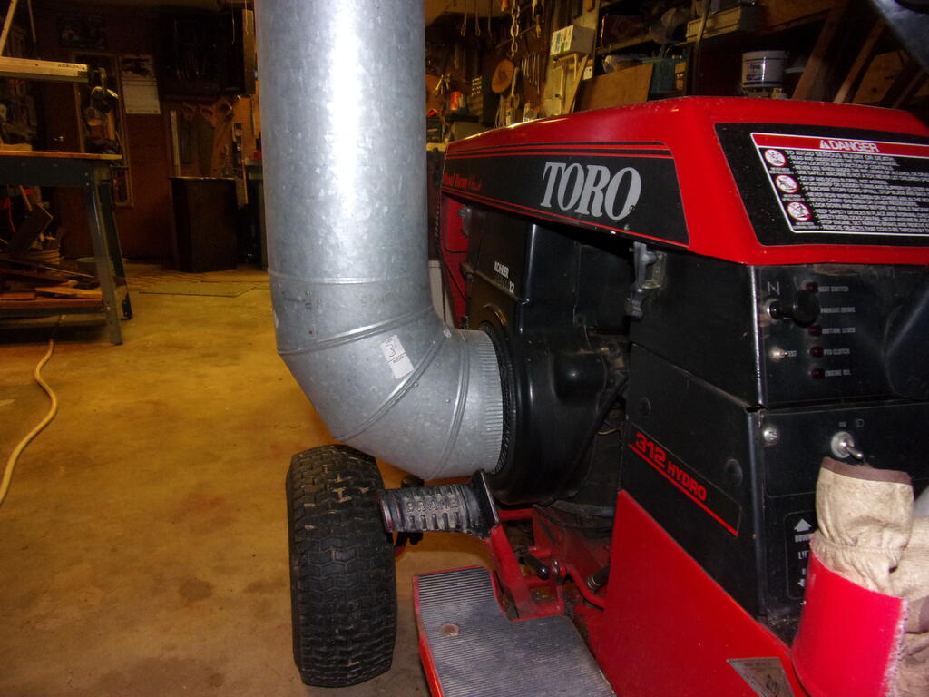

Ed Kennell 47,824 #2 Posted June 11, 2020 I can't find it, but I remember a thread on this problem. One guy added a 90 degree 10 or 12 " flue elbow to the intake. Share this post Link to post Share on other sites
roadapples 6,987 #3 Posted June 11, 2020 It has an inner screen that spins like the Kohler. Take the outer one off. The inner one will throw it off just like the Kohler.... 2 Share this post Link to post Share on other sites

Stormin 9,988 #6 Posted June 11, 2020 15 hours ago, roadapples said: It has an inner screen that spins like the Kohler. Take the outer one off. The inner one will throw it off just like the Kohler.... There's your answer. The outer grill will be there to keep the health and safety bods happy. Just in case you try and grab hold of the spinning screen. 1 1 Share this post Link to post Share on other sites

Sparky-(Admin) 26,693 #9 Posted June 11, 2020 21 hours ago, muz123 said: DANG! Looks like a tossed salad on the screen 1 4 Share this post Link to post Share on other sites

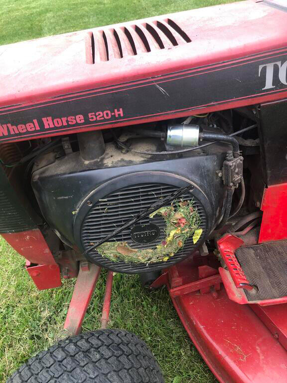

tom2p 2,396 #13 Posted June 12, 2020 (edited) On 6/10/2020 at 9:40 PM, muz123 said: Over the years of using my 520H to mow grass, it has become a nuisance when the grass gets caught in the flywheel grass screen and you have to reach over and scrape it off so the engine won't overheat or the carb won't get dirty. Anyway to prevent it? at one point I mounted a small snow brush on the left side cover with hook-and loop tape (Velcro) so I could brush away the grass and leaves without disengaging the PTO and reaching over/down to remove with hand this worked fairly well - but at times the grass / leaves would get sucked behind the blower housing guard - so I'm back to removing the stuff by hand Edited June 12, 2020 by tom2p 1 Share this post Link to post Share on other sites

Ed Kennell 47,824 #17 Posted June 15, 2020 Here ya go... 1 3 Share this post Link to post Share on other sites
Stormin 9,988 #18 Posted June 16, 2020 7 hours ago, Ed Kennell said: Here ya go... That's not as daft as it looks. Something along the same idea. Up to the bottom of the bonnet side and detachable. 2 1 Share this post Link to post Share on other sites
