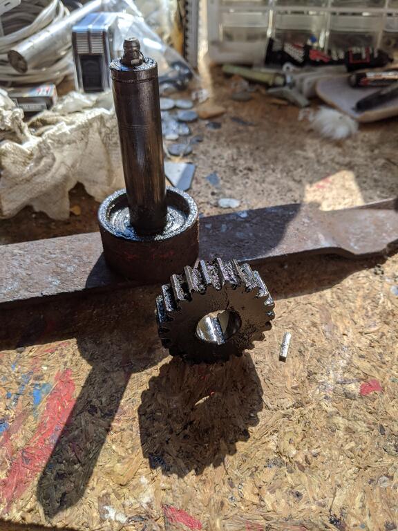

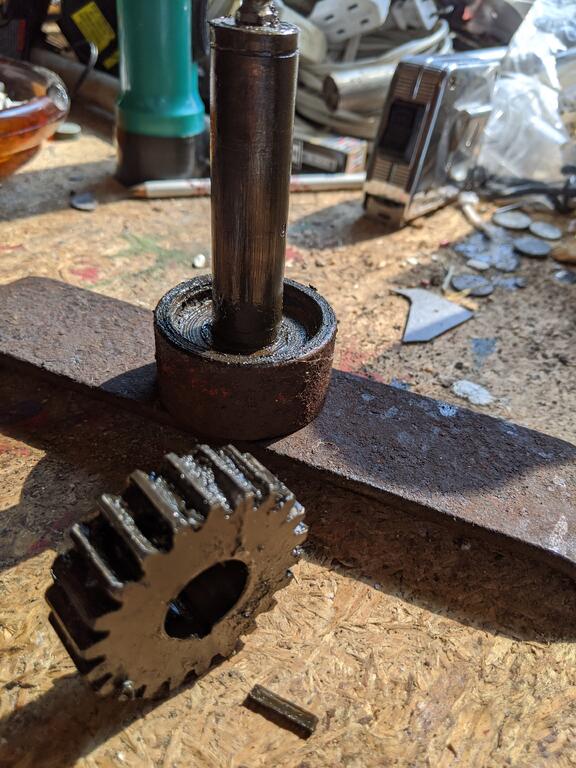

dgrondy 3 #11 Posted June 18, 2020 Here are a couple pics of what I have. Again this the right side(as Im sitting on tractor) blade spindle. The spur gear spins freely on the spindle with the key(#11 in diagram above) in. Is this key not right? i.e. has it been shaved off to where it's not functioning? Share this post Link to post Share on other sites
Ed Kennell 47,609 #12 Posted June 18, 2020 Yes, it appears the key sheared off. I don't see a key slot in the shaft. Is half of the key in the shaft slot and smeared over such that you do not see it? 1 Share this post Link to post Share on other sites
dgrondy 3 #13 Posted June 18, 2020 The spindle(shaft) is completely smooth all the way around. I don't even see a key slot in the shaft. The only key slot i see is in the center of the spur gear as shown. But.. that doesn't make any sense for there not to be a key slot in the spindle. What would be the point of a key then, right? I'll have to look again. BRB. Share this post Link to post Share on other sites
dgrondy 3 #14 Posted June 18, 2020 Ahhh. Ed you nailed it! I wiped the spindle off completely(duh) and there she is! Key is sheared and half was in the shaft/spindle slot. Hey I need a new key! Awesome. Thanks Thanks. 1 Share this post Link to post Share on other sites
