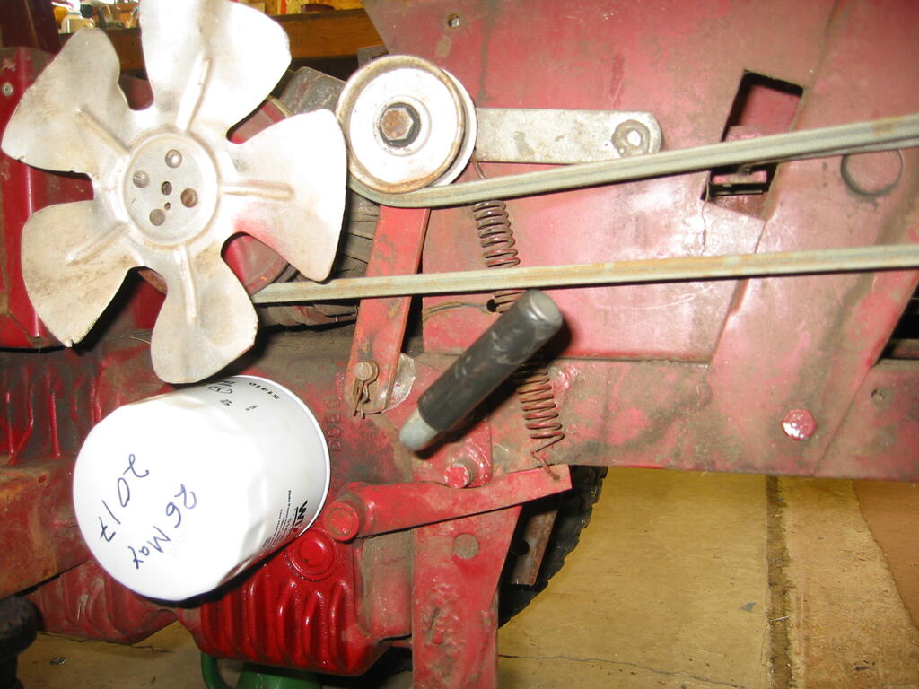

pfrederi 21,095 #4 Posted June 10, 2020 Setup should look like this Do you have the correct belt? WH8005 or Gates Power rated 6872 1 Share this post Link to post Share on other sites
Graycenphil 3 #5 Posted June 10, 2020 That looks about the same, but yours is a lot cleaner. And there is a cage over the fan.I assume the belt is correct, since it is old and always worked fine. I ordered this one from ebay, but it hasn’t come yet. https://www.ebay.com/i/324053554909?chn=ps&norover=1&mkevt=1&mkrid=711-117182-37290-0&mkcid=2&itemid=324053554909&targetid=883446499809&device=t&mktype=pla&googleloc=9003259&poi=&campaignid=9426387564&mkgroupid=95112701705&rlsatarget=pla-883446499809&abcId=1140476&merchantid=6333254&gclid=EAIaIQobChMImZ_Cwbbe6QIVQb7ACh3euQonEAQYAiABEgIyBvD_BwE I should also replace the filter, it’s pretty old. Do you have a part number for that? And a preferred parts supplier? There is no dealer in our area, that I am aware of. (NE Connecticut.) Thanks again, it is much appreciated. Share this post Link to post Share on other sites
pfrederi 21,095 #6 Posted June 10, 2020 From the description the belt looks OK. i have no personal experience with that brand. The gates power rated I have used. Those you can get at any auto parts store. also at the auto parts store you want Wix 51410 for the filter (or Napa 1410) Yes there should be a screen 1 Share this post Link to post Share on other sites

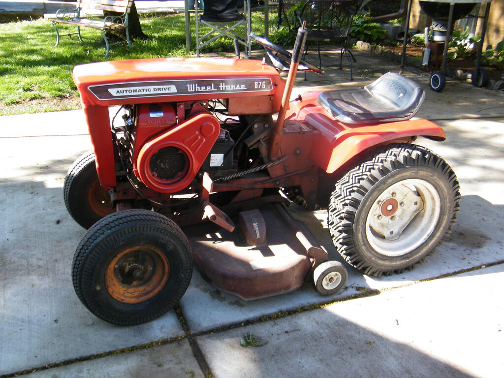

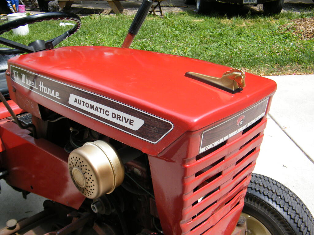

stevasaurus 23,816 #11 Posted June 24, 2020 Glad you got if running again. If it is an 876...it is 1966. It should have decals on the hood that look like wood grain. 1 Share this post Link to post Share on other sites
Graycenphil 3 #12 Posted June 24, 2020 That is a good looking machine. This one doesn’t looks exactly like that, and has the 876 decal, but is not so fresh. It is very pleasant to work on and runs like a top. Over the course of it’s life, it has been driven into a pond, caught on fire, and mowed the lawn for 54 summers. 1 Share this post Link to post Share on other sites
stevasaurus 23,816 #13 Posted June 24, 2020 These stickers are from Terry (Vinyl Guy). I think 1966 horses are the only year for the wood grain stickers. Mine looks clean because I just re-built the Kohler 8 hp. You are correct, easy to work on and last forever. 1 Share this post Link to post Share on other sites
