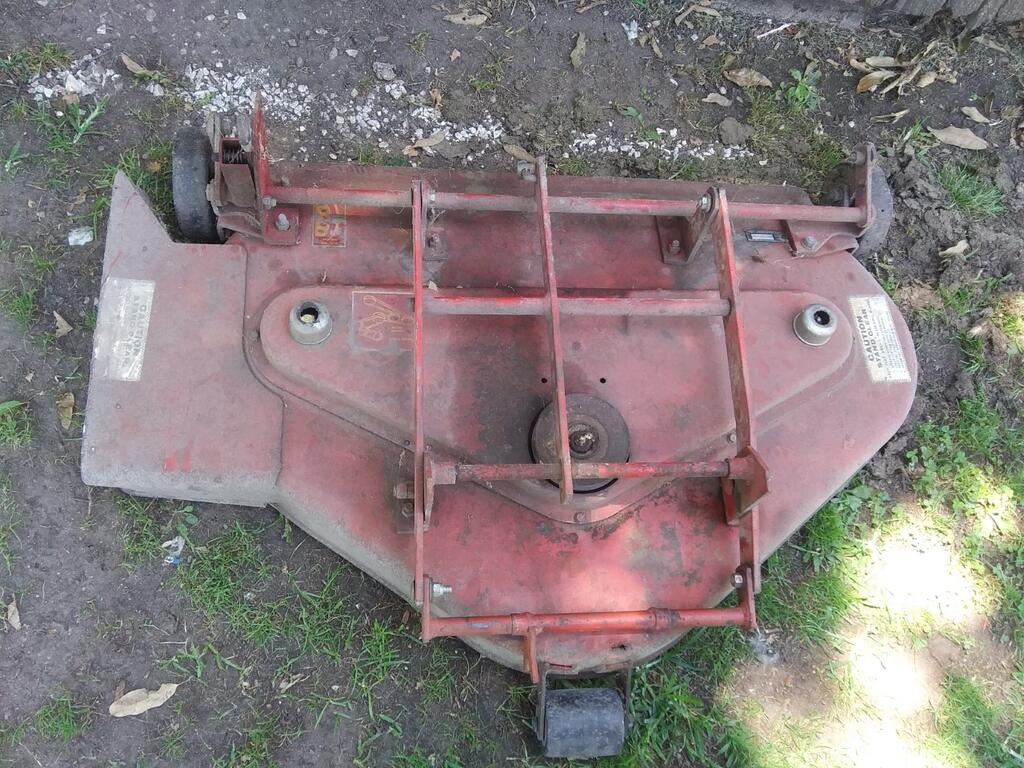

upstate yank 219 #1 Posted June 9, 2020 well again guys i am in need of some information on a leak i have on my charger 10; a few weeks back i changed the oil and filter ;i did not over crank the new filter putting it on ;i noticed last week when i used it to mow under the bottom it is soaked in fluid ;i wipe it all off and yesterday i used it again ;checking the dip stick in was a quart low plus again soaked under neath ;i noticed in the rear of the deck where the wheels are and the adjust bar they were soaked in oil so i think the problem is in the front of the transmission; the drain plug is tight plus most bolts ;so i am not sure where to look for the leak ;could it be a gasket ; i have never really messed with a transmission of these types so any thoughts sure would be helpful; sad this machine out of the 7 i have is my favorite 'but till i figure out the issue it will sit as i would hate to ruin it ;thanks again guys Share this post Link to post Share on other sites

upstate yank 219 #9 Posted June 9, 2020 2 hours ago, Achto said: You'll have to remove the tranny if this is what the issue is, but it is an easy fix after that. You will need a 1/4" 12 point socket to remove the bolts from the gray box. There are 2 O-rings behind that box that tend to dry out & start leaking. thanks for the reply but i was really hoping that i didn't have to remove it but it seems it needs to be done ;i did talk to a wheel horse dealer today and for his labor rate of 35 per -hour plus parts if could be found as the tractor being so old they would be really hard to get but heck isn't an o- ring the same if they are the same size ;if i could be so lucky to save this old horse which again is my favorite so with weather holding and no rain it seems this is the only way to go as labor rates are so darn high for maybe an few hours work ;i sure will let you know the out come ;again thanks so much Share this post Link to post Share on other sites

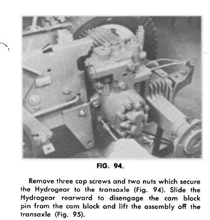

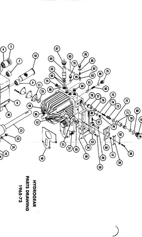

pfrederi 21,274 #15 Posted August 3, 2020 Sorry not sure I understand where you found the leak. Is it near the bolt being removed in the picture # 37 in parts list?? Share this post Link to post Share on other sites
upstate yank 219 #16 Posted August 4, 2020 On 8/3/2020 at 8:42 AM, pfrederi said: Sorry not sure I understand where you found the leak. Is it near the bolt being removed in the picture # 37 in parts list?? thanks so much for the reply and the diagram ;i will have to put the tractor up on ramps and try to get a picture of where i saw the leak ; Share this post Link to post Share on other sites

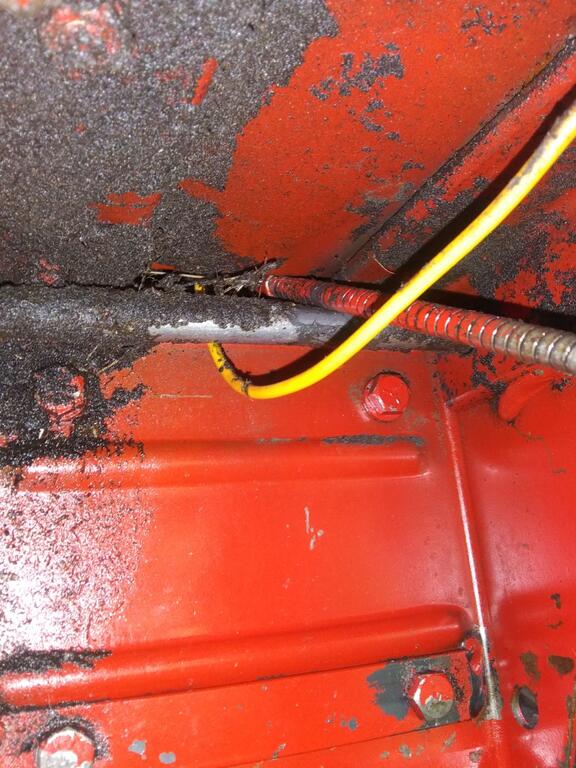

upstate yank 219 #19 Posted August 5, 2020 On 8/3/2020 at 8:42 AM, pfrederi said: Sorry not sure I understand where you found the leak. Is it near the bolt being removed in the picture # 37 in parts list?? pfrederi;thanks for the diagram and i am sorry if i have confused you as again this is all new to me with these types of transmissions ;i am adding a photo that my daughter took today to hopefully explain where the leak is coming from'under the tractor near the very front there is plate that has 4 bolts on it ;one in each corner ;as in the photo you will see the right side bolt and just above that bolt is where the fluid is lesking out ;i really didn't know it was that dirty as last week i thought i cleaned every thing with the degreaser but to do that i would have to stand on my head as i did lay down and thought i removed all of the grime ;but again you can see the right side top bolt where again it is leaking ;again thanks so much asi really appreciate it ; Share this post Link to post Share on other sites
pfrederi 21,274 #20 Posted August 5, 2020 Being the sludge is accumulating o the right side of the tractor and coming down from above I would guess it is the motion control leaking. 1 Share this post Link to post Share on other sites

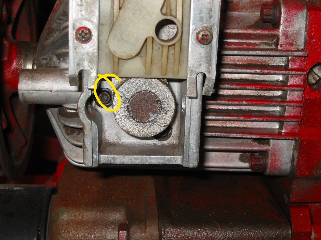

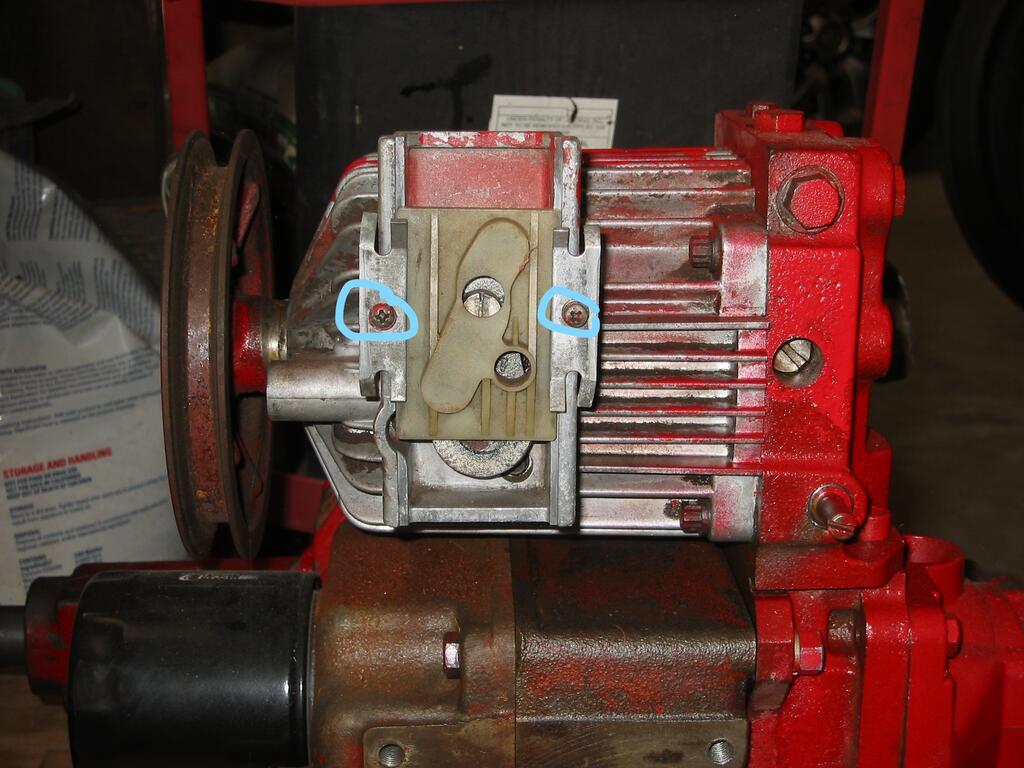

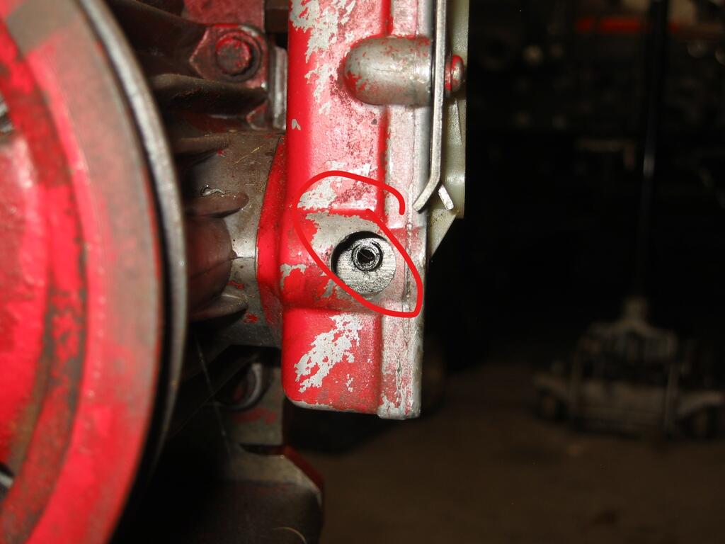

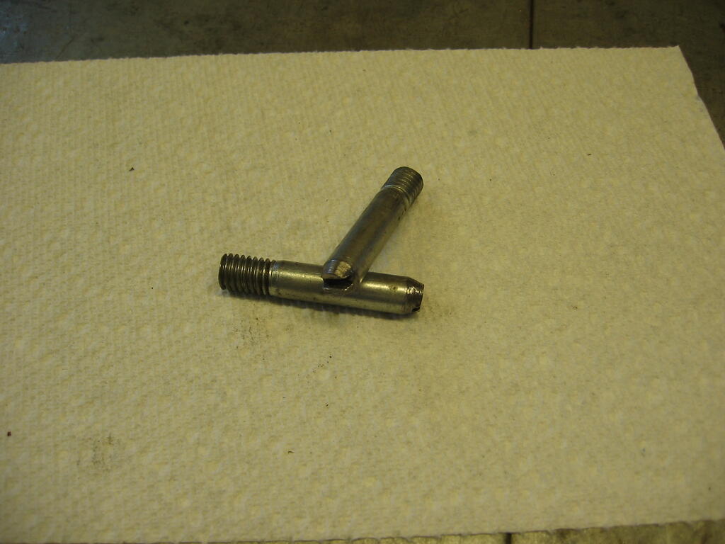

pfrederi 21,274 #22 Posted August 6, 2020 Split the tractor. Support the front end. Unhook the tension spring. Make yourself a couple of aligning pins in picture. support tyranny on your floor jack. remove 4 bolts and roll tranny back.. Take out 2 small screws holding the slider in place. Note there should be 2 small washers behind them don't lose them. (blue circles). Drive out the roll pin (red circle) and pull off the arm; Remove the three 12 pt 1/4" screws (yellow circle). Pull off the control box. Replace the 026S large oring in the triangular holder. small ring goes onto the pump shaft... Share this post Link to post Share on other sites

upstate yank 219 #24 Posted August 7, 2020 3 hours ago, pfrederi said: Split the tractor. Support the front end. Unhook the tension spring. Make yourself a couple of aligning pins in picture. support tyranny on your floor jack. remove 4 bolts and roll tranny back.. Take out 2 small screws holding the slider in place. Note there should be 2 small washers behind them don't lose them. (blue circles). Drive out the roll pin (red circle) and pull off the arm; Remove the three 12 pt 1/4" screws (yellow circle). Pull off the control box. Replace the 026S large oring in the triangular holder. small ring goes onto the pump shaft... thanks so much for the information ;it sure does sound complicated but i am sure i can do it ; though making those alining pins i am not to sure about ;my address is Dean Borland 1507 west nichols street springfield mo 65802 again thank you so much ;i would be willing to pay you for those 2 0-rings ' while i am here i would like to ask another question ;there is another wheel horse colletor here in the area that has a 1966 model # 1076 as with the one i have he would like to know if a mower deck model #507207 would fit under neath ; this is a spare that i have and he needs a deck for his ; again thank you Share this post Link to post Share on other sites
pfrederi 21,274 #25 Posted August 7, 2020 (edited) Deck will not fit with out major mods to the tractor aligning pins are easy . Cut the head off a 3/8 nc bolt. Cut a slot for the screw driver to get it in and out of the tranny. File/grind a bit of a bevel on the end, makes it line up more easily. Will send o rings today no charge... Edited August 7, 2020 by pfrederi 1 Share this post Link to post Share on other sites
