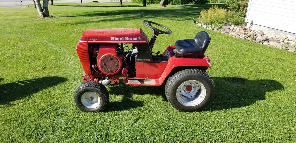

BrianX128 115 #1 Posted June 8, 2020 I'll post a video up when I get a better connection but my wife's kt17 is surely dead. Horrid knock, both pistons still have 90psi and spark but it sounds like a main bearing or something deep knocking. There's a k series 14hp and a magnum 14hp near me I can get for 300-400$. This kt17 has been mostly disappointing, it's likely tired and needing a full rebuild if it didn't self destruct. Just curious if I can mount a magnum or k series the same way this kt was mounted. The magnum 14 I have on my old c141 has been the most impressive small engine I've had yet, I can't believe the power it has on my old 48" deck. Also curious if it robs more power being a hydro on the kt17 I'd be replacing with one of these engines. I guess if anyone has any advice of where to dig into the broken kt17 first but I need to get the mower going before I tear into the carnage. Share this post Link to post Share on other sites

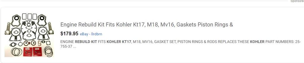

pfrederi 21,300 #3 Posted June 8, 2020 I would not bother to rebuild a KT17 series one and I have a bunch of them and like them a lot..... You are going to be into serious money for parts and machine shop work. Rods are $50 each as are pistons so 200 just for that throw in gaskets and stuff you are getting up there. Do you have access to a good machine shop two cylinders to bore and two crank journals here would be another 200.... if it was a series 2 maybe ... Spec number 24300 and up is series 2. 1 Share this post Link to post Share on other sites

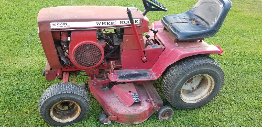

BrianX128 115 #15 Posted June 10, 2020 I also found a C161 with an original K series 16hp, still an 8 speed so I'd be swapping the engine, and it's more money but it also comes with a rear discharge deck which would be nice for the areas of my yard near the back porch and firepit areas, I have a yard sweeper and usually sweep that part of the yard so it looks nicer, just waiting to hear back from the seller if he still has it. Share this post Link to post Share on other sites

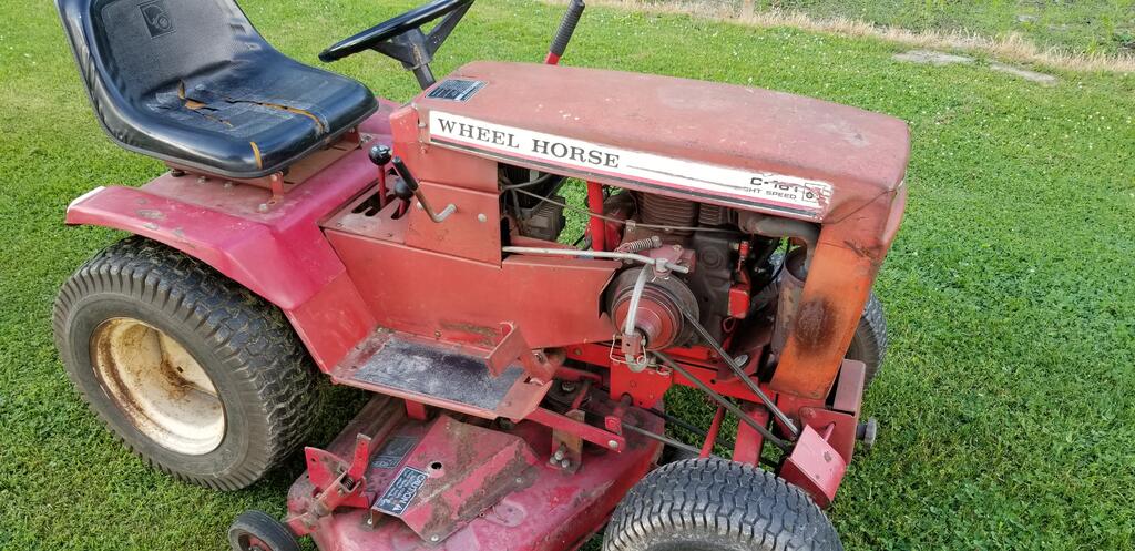

BrianX128 115 #18 Posted June 10, 2020 (edited) Well I got a 16hp replacement engine, just so happens it came with an entire tractor. Unfortunately though I feel guilty the engine is getting stolen to go on the 417a and this thing will be engineless. Just no way around that for now.. My kt17 must have been half dead the whole time I had it, I'm haven't swapped it yet but the last time I mowed up a hill in the front yard going slowly with moderately high grass it was bogging down hard. This thing just mowed the same hill for kicks in second and barely bogged. We'll see how much power the hydro robs from it. So since I'm going from kt to k series I don't think I'm in for as much wiring wise, but the kt had a black plug with two wires going to the engine and that was it. The k series seems to have more.. I'm guessing the rectifier mounted under the battery is going to come along for the ride, but I might need to start from scratch on the wiring. The kt was pretty hacked from the previous owner. Edited June 10, 2020 by BrianX128 Share this post Link to post Share on other sites

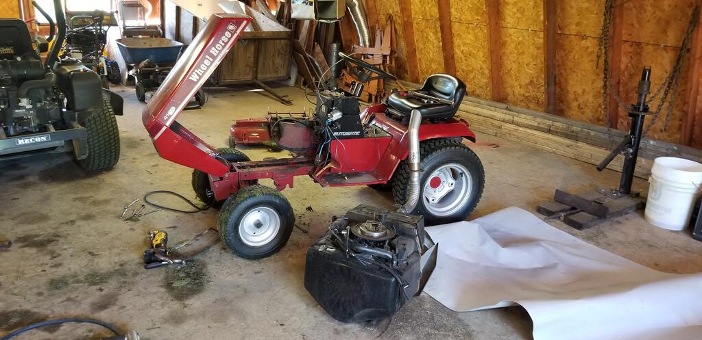

BrianX128 115 #19 Posted June 14, 2020 Fyi, it's all back together with it's new engine. Not the most fun swap ever, here's a list of everything that doesn't work: Throttle cable too short Choke too short unless you use zip ties and new routing. Wrong drive pulley [4" vs 5 1/4"] Need 80" belt because of that Rectifier needs a home Axle in the way of shaker plate mounting holes PTO wrong size unless you have the k series pto like I did. Fuel line too short [easy] Starter cable wayyyy too long And lastly I have no patience. Personal problem there.. I hate the rear discharge deck. Tried it, only can stomach it with a yard sweeper behind it. 1 Share this post Link to post Share on other sites
