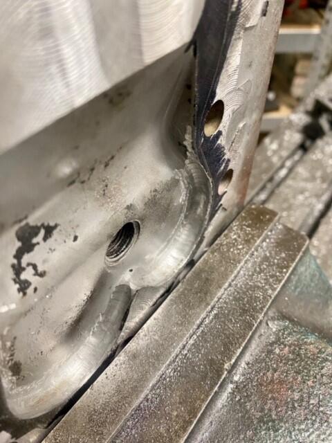

oliver2-44 11,559 #32 Posted January 6, 2021 50 minutes ago, Greentored said: Would be interesting to see what gains could be had just by unshrouding the valve area...and of course milling. @Greentored Can you explain or show a picture of what "unshrouding the valve area" in the head is? 1 Share this post Link to post Share on other sites
ebinmaine 79,266 #33 Posted January 6, 2021 8 minutes ago, oliver2-44 said: unshrouding the valve area I'll let Scott answer this one too but basically every engine is an air compressor and if you add something flammable and it goes boom at the right time you can move something with it... The more boom you make and the more air you move the more power you have. Unshrouding the valves lets the air flow around the valves so the engine can breathe better. It varies with every setup but if you can imagine a cereal bowl ... and you scrape the insides of the cereal bowl out ... you now have a slightly larger cereal bowl. 2 Share this post Link to post Share on other sites

Greentored 3,220 #35 Posted January 7, 2021 21 hours ago, oliver2-44 said: @Greentored Can you explain or show a picture of what "unshrouding the valve area" in the head is? Here ya go, in the 'roughed in' step. Basically taking the vertical 'wall' in the head where the valve is, and 'rounding it out' with a ball mill, so when the valve is open, the incoming/outgoing air has more room to move without the wall obstruction. 3 Share this post Link to post Share on other sites
ebinmaine 79,266 #36 Posted January 7, 2021 43 minutes ago, Greentored said: Here ya go, in the 'roughed in' step. Basically taking the vertical 'wall' in the head where the valve is, and 'rounding it out' with a ball mill, so when the valve is open, the incoming/outgoing air has more room to move without the wall obstruction. Am I correcting assuming that there's plenty of aluminum "meat" to do that there? I've heard of moving the spark plug as well. Is that something that you'd normally do only for a race engine? 1 Share this post Link to post Share on other sites
