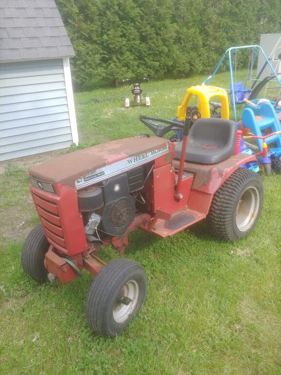

Gilbertr 5 #1 Posted June 8, 2020 Hey guys im new here. I've been looking at the content on here and there is a lot of good information. Ive got a gt2500 im rebuilding the deck and im having trouble finding the all the pulleys for the deck. Ive talk to local dealers and they want an arm and a leg for that stuff. I was wondering if anyone had part numbers for these items so I can have an easier time finding them 3 Share this post Link to post Share on other sites

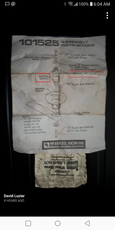

Gilbertr 5 #11 Posted June 12, 2020 I am now having another issue lol. Wondering if anyone can aid me. My deck has been apart for 2 weeks now waiting on parts and i have now forgot how it goes together. The new spindles have a grove on one side of the slotted drive and im not sure which way that goes and im sure it matters as ive measured it and one side is a 1/8 inch longer than the other. My other concern is test fitting everything together and on the pulley side there seems to be quite a large gap between the mandrel and the pulley and I don't recall if it had that large of a gap. Thanks for the help in advance Share this post Link to post Share on other sites
Gilbertr 5 #12 Posted June 12, 2020 Update on my search. Someone on a face book group found this picture for me 1 Share this post Link to post Share on other sites
tunahead72 2,645 #13 Posted June 12, 2020 This should help: Share this post Link to post Share on other sites
