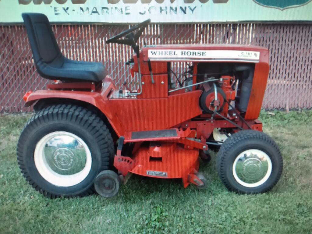

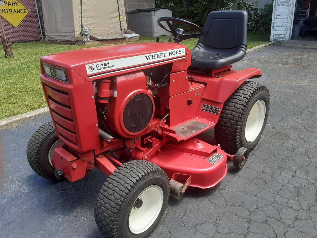

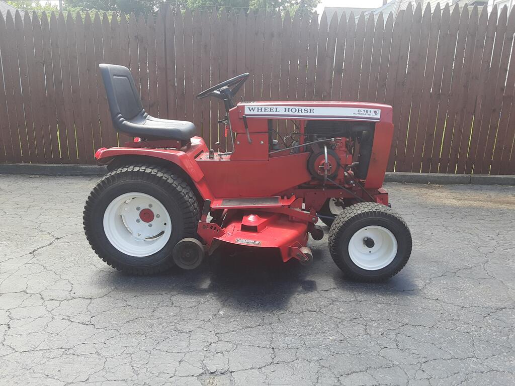

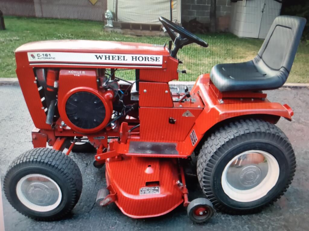

D_Mac 9,335 #26 Posted June 14, 2020 Well its done. I dont ever want to do that again. All 4 are in and bolted down tight. Makes a HUGE difference. Before at low idle it would shake like crazy. Now... no shakes. Just the rumble of the 16hp Kohler running silky smooth. I see why they discontinued making them with the shaker mounts. I have to tell you I am really pleased how this tractor came out, I see why so many like these C series, and that 16 hp under the hood... excellent. Couple little small things I would like to do to it, like change the muffler to a stack and work on the rear hitch other then that this baby is done. 3 1 1 Share this post Link to post Share on other sites

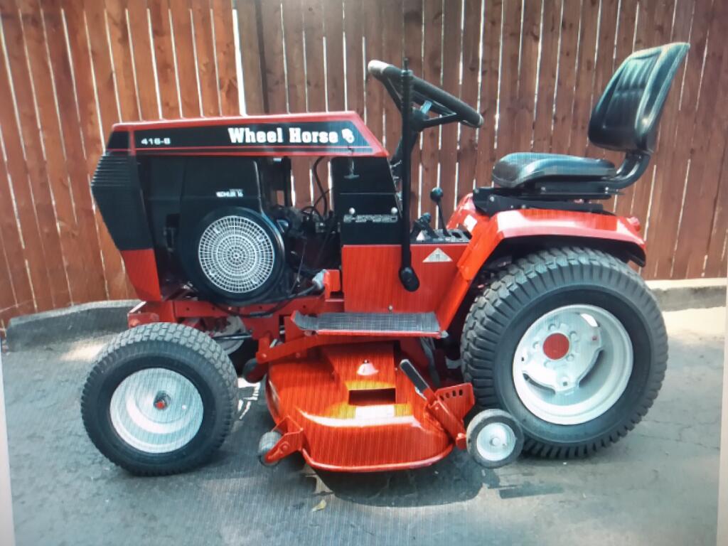

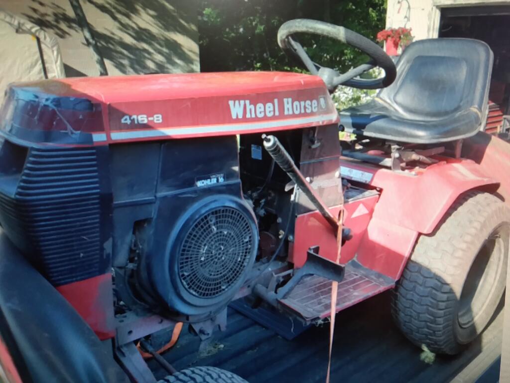

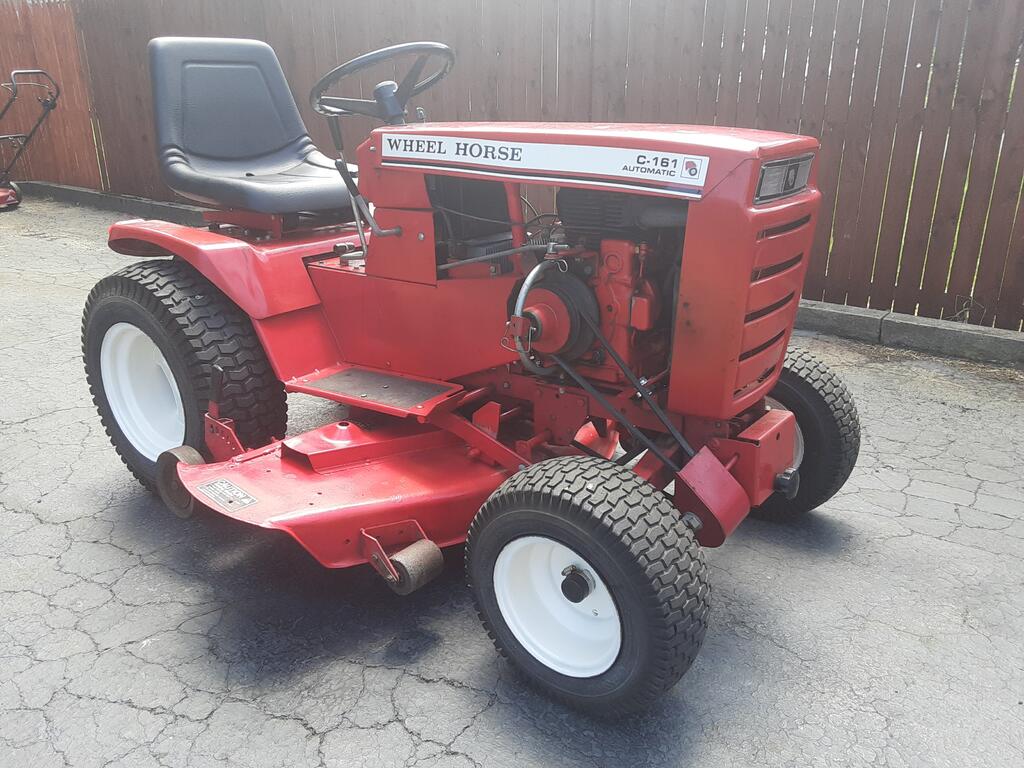

D_Mac 9,335 #31 Posted June 19, 2022 11 hours ago, Blasterdad said: If you do get around to putting a stack on it I'd be more than happy to make a deal with you for the one that's on it. Beautiful 161, you're gonna Love it ! There are a couple of vendors on here that make a really nice bolt on Reese type reciever / hitch too. That tractor is long gone. I never did put a stack on it but I did add a few things to it after this post was made. It is still one of my favorites was sad to see it go but I like passing them on and look forward to working on the next one. The 416-8 that I did after this one is still my all time favorite. That is the only one I regret getting rid of. Before and after of that one. 1 3 Share this post Link to post Share on other sites
