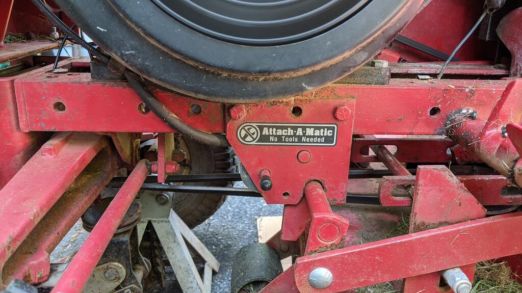

echris 1,426 #1 Posted June 7, 2020 Can anyone tell me if this is the correct fuel line routing for a 1989 310-8? I thought I remember the line running outside the framerail below the blower housing, with an inline filter at the back side of the engine. I don't like the way that's routed. I could see the fuel getting chafed by the front of the Attach-a-matic bracket. What say you O guru's of Share this post Link to post Share on other sites
JCM 11,260 #2 Posted June 8, 2020 Outside the frame rail below the blower housing is correct. 2 Share this post Link to post Share on other sites

echris 1,426 #5 Posted June 8, 2020 That's exactly how I remember them being routed. Thanks for the pic! Share this post Link to post Share on other sites
