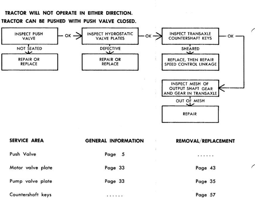

krohs nest 29 #1 Posted June 6, 2020 I have been working on mt gt-14. Almost done except for the wiring. Problem I think, I can easily push the tracker around the shop no matter which position the valve is in. Is this normal? This dose not seem right to me. What am I missing. Share this post Link to post Share on other sites
pfrederi 21,274 #2 Posted June 6, 2020 (edited) Have you ever had it running? Is the tranny full of fluid? Are you r axle hub keys OK? Not normally good news Edited June 6, 2020 by pfrederi Share this post Link to post Share on other sites

krohs nest 29 #4 Posted June 6, 2020 It was running two years ago and has not been run since. There is fluid and the keys are ok. You referred page numbers, is there a manual I should be looking at. Share this post Link to post Share on other sites
krohs nest 29 #5 Posted June 8, 2020 On 6/6/2020 at 5:09 PM, krohs nest said: It was running two years ago and has not been run since. There is fluid and the keys are ok. You referred page numbers, is there a manual I should be looking at. On 6/6/2020 at 5:09 PM, krohs nest said: The fluid level is just above the full mark when the dip stick is screwed in. I did find the manual. Would you happen to have the current part number of the push value if I might need one. Share this post Link to post Share on other sites
pfrederi 21,274 #6 Posted June 8, 2020 WH# 7266 No new parts are available for this. There were two types of tow valves. The diagnostic chart is really addressing the cone valve type which can become damaged/corroded and not seat. Yours is a port valve. Unlikely the valve body failed. Could be a failure of the O rings or back up rings letting fluid get past. See pinned link at the top of this forum Sunstrand O rings for numbers... I would try to get it running then you could narrow down the culprits easier. Running tow valve closed if the lift operates but no movement I would think the transaxle counter shaft key. if the lift didn't operate then tow valve or valve plates... Share this post Link to post Share on other sites
