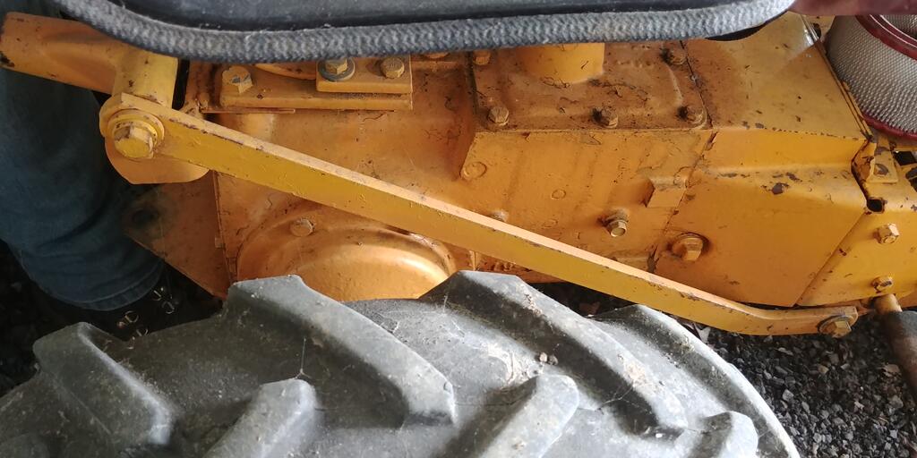

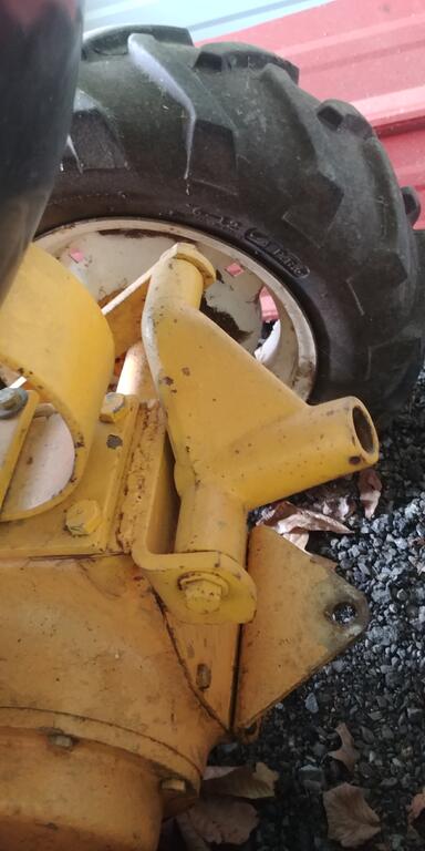

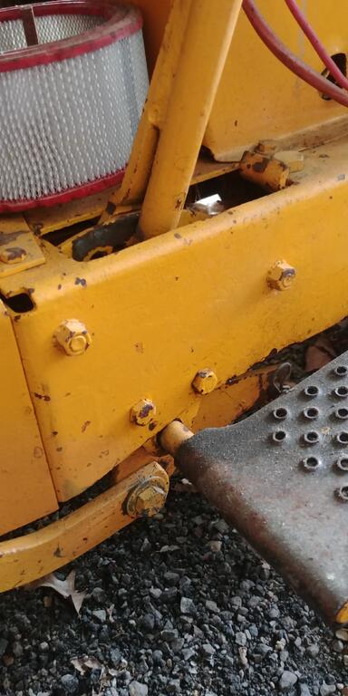

WVHillbilly520H 10,379 #20 Posted June 6, 2020 This is the linkage and top link or rear rockshaft on a Cub Cadet Original that I grew up on I'm sure with a little bit of Hillbilly ingenuity other solid rear lift lever/links could be on order of this... 1 2 Share this post Link to post Share on other sites
