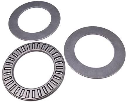

DarrellF 33 #1 Posted June 5, 2020 (edited) Ok guys am I missing anything 71930-C91 - Cub Cadet - Kit, Ball Cup John Deere Cam follower M45567 9/16-18 John Deere Isolator M45568 John Deere Washer M43747 Not sure if the upgrade would work? In picture below. Edited June 5, 2020 by DarrellF forgot something 1 Share this post Link to post Share on other sites

pacer 3,180 #3 Posted June 5, 2020 I think that covers it... you'll probably only need the bottom balls/cage and the 9/16" cam follower. The bearing/washer is - 1 think - an after market thing to ease the steering a bit - Ive done about 5 of these things and never saw it on an original, but as soon as I saw what it did I added it to the last 3-4 that i did. The last couple I did I could not find the cage/balls, so my race and existing balls were perfectly good, just the plastic cage was toast so I positioned it in the vise with the end upright and using heavy grease stacked the balls around the race to make them stick - I had to add 2 or 3 to fill in with out the cage and carefully screwed the plug back on --- worked like a charm. The cam follower is where the slop comes from.!! What are you doing it on, a 'Big D' or ???? Its a bit of a pill to remove the assy on the D's, but it sure do make a difference!! 1 Share this post Link to post Share on other sites

DarrellF 33 #9 Posted June 5, 2020 Pacer I was planning on using a bearing there as well,what you said a front wheel bearing is very close. I was wondering if anyone has tried thrust needle bearings on the spindles? Not sure there is enough room for them. Hmmm. Share this post Link to post Share on other sites
953 nut 66,378 #11 Posted June 6, 2020 If you remove the front spindles and cut enough material off the TOP side of the axle to make up for the bearing and washers things will go together well. 1 Share this post Link to post Share on other sites
