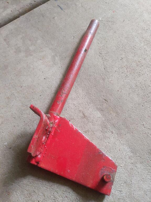

squonk 38,848 #2 Posted June 4, 2020 (edited) Snowblower flag. The pin goes into your lift arm. The long piece fits into another tube that is attached to the snowblower. The flag pushes on the tube and it raises the blower Edited June 4, 2020 by squonk 1 1 Share this post Link to post Share on other sites
857 horse 2,581 #3 Posted June 4, 2020 AND YEAH GOT TO HAVE IT !!!! 1 Share this post Link to post Share on other sites
Ed Kennell 35,629 #4 Posted June 4, 2020 And the tab on the side is to attach a lift assist spring. Share this post Link to post Share on other sites
peter lena 8,038 #5 Posted June 5, 2020 add more washers to the base of the solid rod for easier lifting,add a heavy spring to the hole on the angular piece on side of flag.mounts to clutch and brake cross joining rod, pete Share this post Link to post Share on other sites

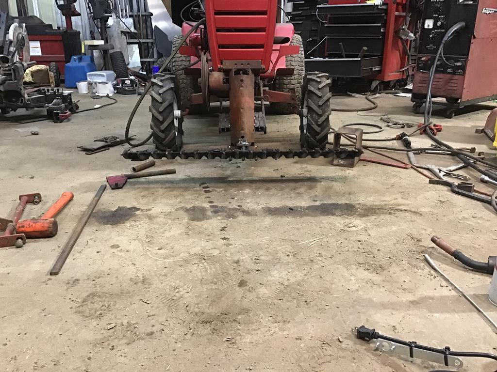

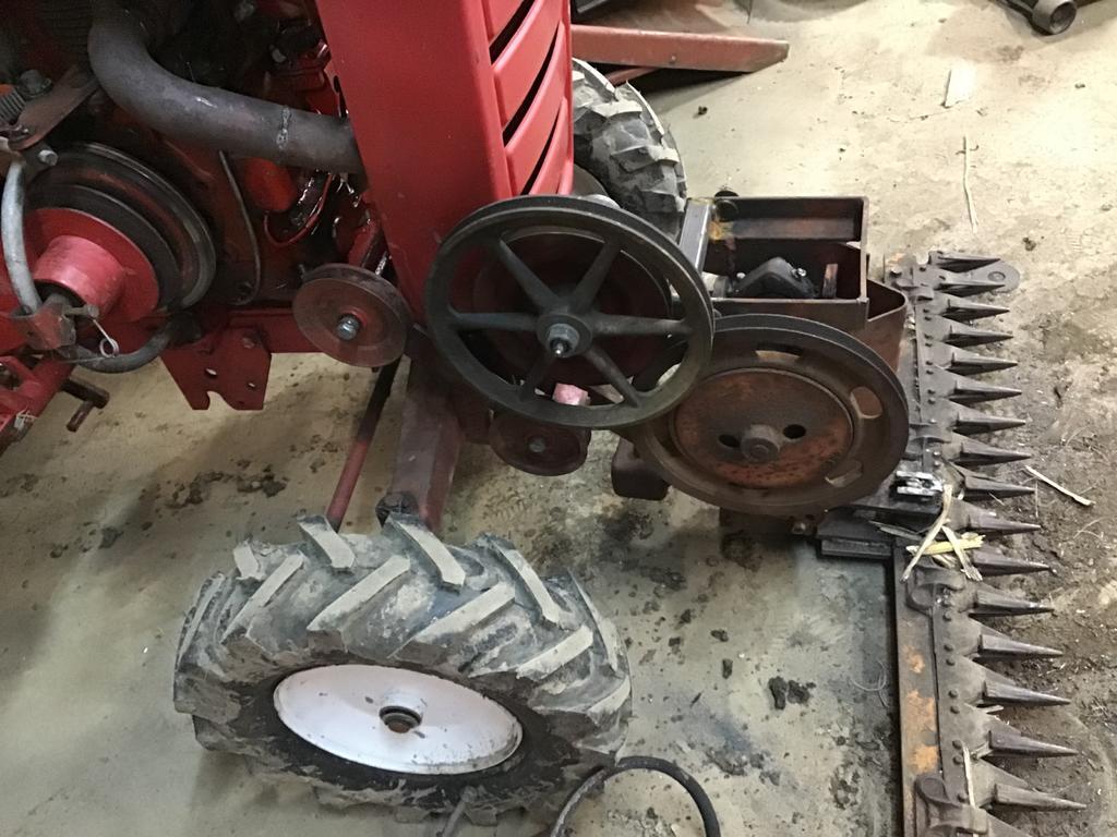

Pullstart 59,571 #6 Posted June 5, 2020 It’s for lifting your front mount sickle bar. 1 1 Share this post Link to post Share on other sites
