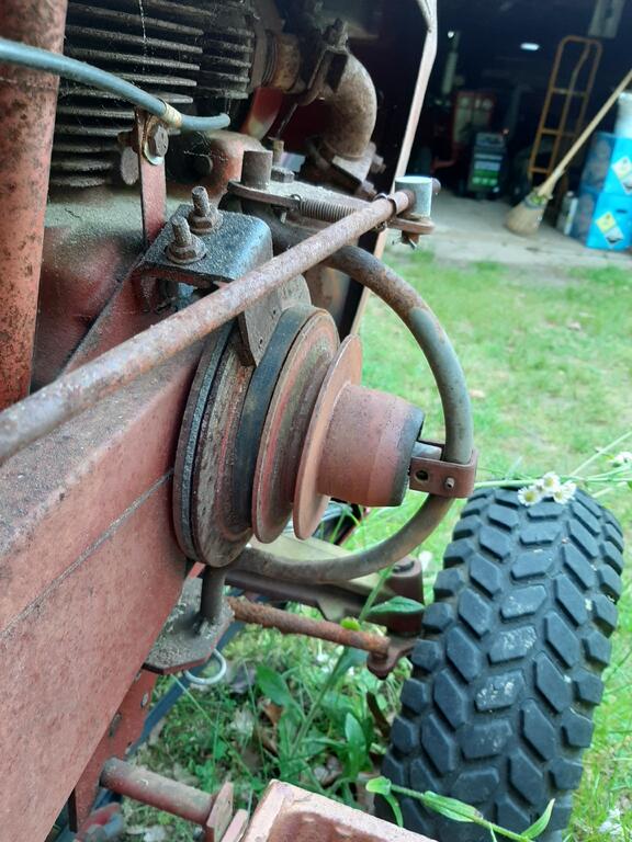

Buzz 502 #1 Posted June 3, 2020 How do I swing the doohickey out of the way so I can remove the belt Share this post Link to post Share on other sites

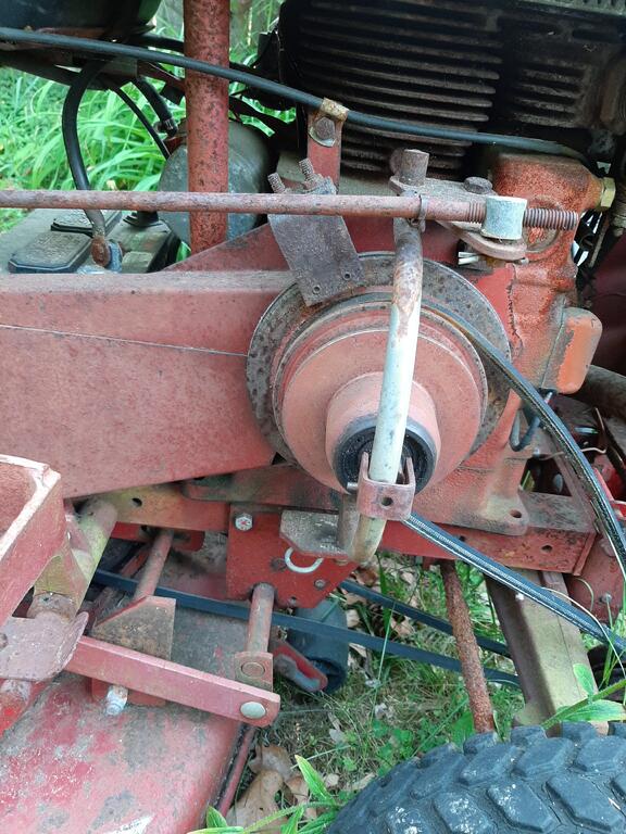

echris 1,426 #2 Posted June 3, 2020 (edited) If I remember correctly, you pull the hitch clip on the bottom of the curved arm, remove the pin at the end of the pulley, then lift and rotate the curved arm to the side. There's supposed to be a pin going through the red U bracket and the end of the pulley which is missing in your pic. Edit: added pic with hitch clip circled. Edited June 3, 2020 by echris Share this post Link to post Share on other sites
lynnmor 8,831 #3 Posted June 3, 2020 Pull that cotter pin in the trunnion just above the hoop, watch the magic happen. 1 2 1 Share this post Link to post Share on other sites
Sparky-(Admin) 25,392 #4 Posted June 3, 2020 Remove the clip or pin holding this and pop it up and the bale will swing out enough to remove the belt. (See yellow circle) Share this post Link to post Share on other sites

Buzz 502 #6 Posted June 4, 2020 16 hours ago, Sparky said: Remove the clip or pin holding this and pop it up and the bale will swing out enough to remove the belt. (See yellow circle) Wow! Just like magic the belt is off . Thanks everyone, it's been years since I have removed a mower deck Share this post Link to post Share on other sites
