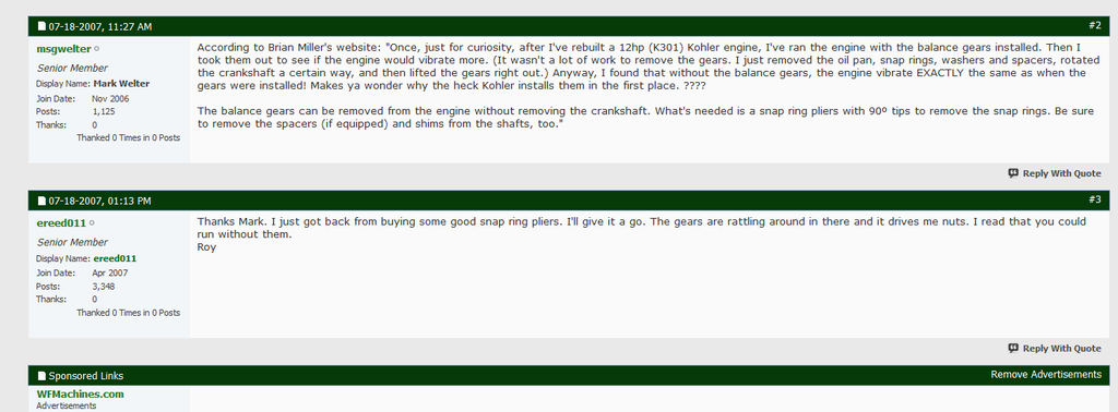

Ed Fox 20 #15 Posted June 3, 2020 I googled it and found this. Thank you very much Squonk! 1 Share this post Link to post Share on other sites
squonk 48,166 #16 Posted June 3, 2020 They were not really needed. Search balance gears here. Read this: http://gardentractorpullingtips.com/balance.htm 1 Share this post Link to post Share on other sites

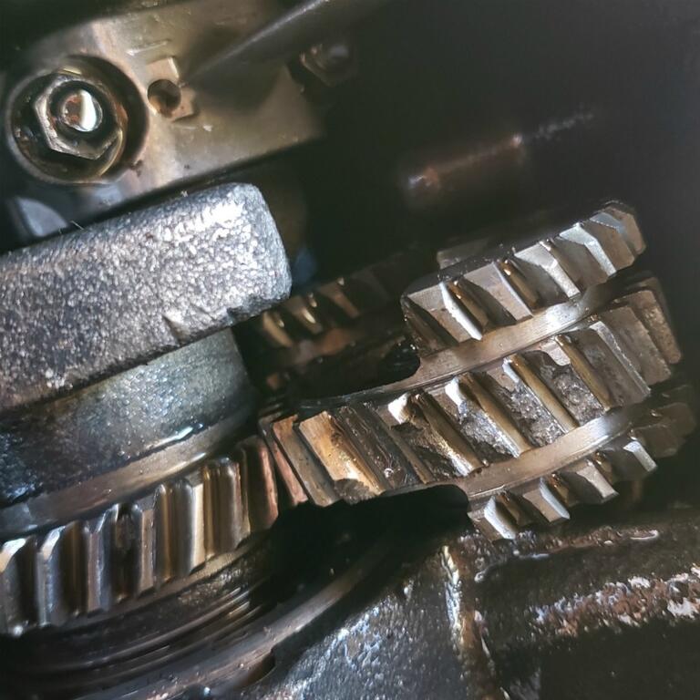

pacer 3,180 #18 Posted June 3, 2020 (edited) Thats a serious rattle!! and indeed it does sound like the infamous "grenade Gears" While it is a pretty simple procedure to jerk the gears out, I would suggest going ahead and do a check on the crank/cylinder/valves/etc. Very little more work at that point. When I did the couple engines I had I went ahead and pulled the piston/rod out for an inspection as I had got the engines used and knew nothing about their history. On my K361 not only was the gears very loose, the crank had about .003-4 wear but cylinder was good. Since I dont have any where to get a crank ground I elected to just try a new rod and do rings also (one of those import rebuild kits - very inexpensive and Ive had good luck with them) Was lucky and the new rod/piston/rings and absence of the gears made a huge difference in the engine. Edited June 3, 2020 by pacer 2 1 Share this post Link to post Share on other sites
Tractorhead 9,217 #19 Posted June 3, 2020 Uuuuaaahhh, that sounds horrible - I‘m also in at remove the balance gears. it seems they may have caries. i have not much experiences with kohler Engines, but i have some experiences with the old 250 and 350ccm single Honda Engines they had also counterbalance gears. I tuned several Engines of them in my Quadbike and my first step when i did Engine tuneup, remove that gears. Than recheck the balance of the cam/ piston itself and just than go further. they gears rapidly quits in a tuned engine as first parts. if you unsure about the balancing, let check the balance of camshaft and piston in a Engine workshop But for normal rpm engine i see no real senseful reason and i doubt it was that urgently need. 2 Share this post Link to post Share on other sites
Lee1977 7,786 #20 Posted June 3, 2020 Take them out or they will come out on their own and leave a nice size hole in the side of the block. 1 Share this post Link to post Share on other sites

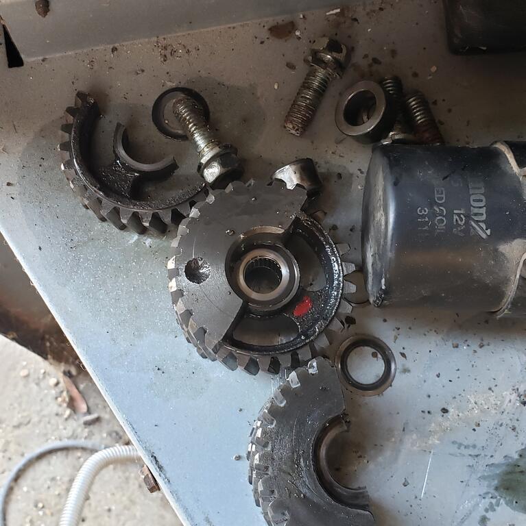

Ed Fox 20 #21 Posted June 4, 2020 That was it. I had to bust the lower gear out by splitting it with a chisel. I worked at it for a good 10 minutes and no matter how I positioned it you just couldn't get it off of the pin. Thank you all for your help!! Kindest regards Ed 4 1 Share this post Link to post Share on other sites
Ed Fox 20 #22 Posted June 4, 2020 Just another pic 1 Share this post Link to post Share on other sites
Bill D 3,159 #23 Posted June 4, 2020 Wow, you got lucky. Now go buy a lotto ticket. Remember me if you win😁. 2 Share this post Link to post Share on other sites
Tractorhead 9,217 #24 Posted June 4, 2020 2 hours ago, Bill D said: Wow, you got lucky. Now go buy a lotto ticket. Remember me if you win😁. Huh? No, buy a second horse instead.. 😂 they tend to herd.... i see exactly what i heared caries. 1 Share this post Link to post Share on other sites
pacer 3,180 #25 Posted June 4, 2020 GAH!! I bet you didnt have another 20-30 mins run time before that 'grenade' went off and that couldve been ...bad!! 1 Share this post Link to post Share on other sites
