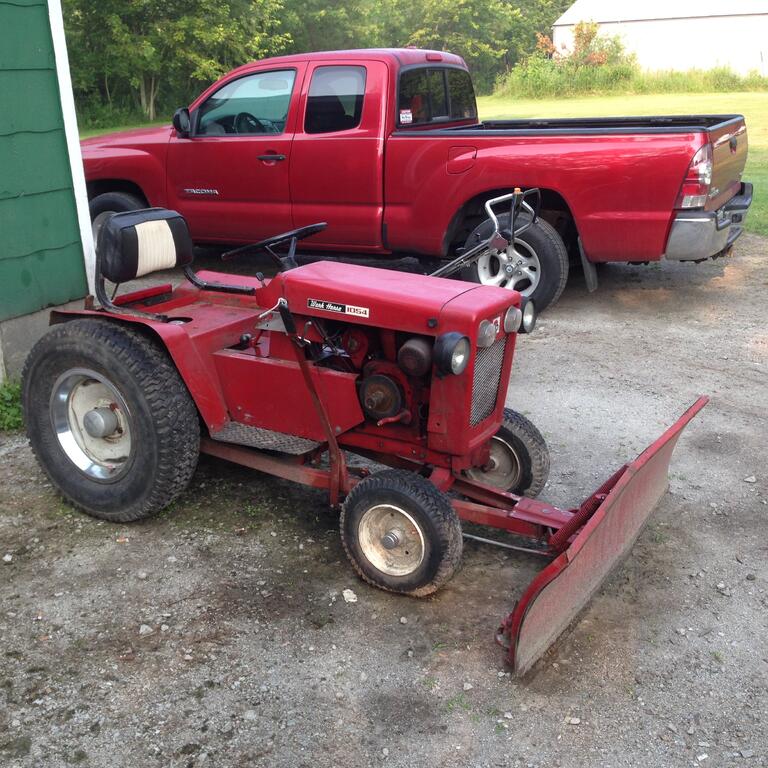

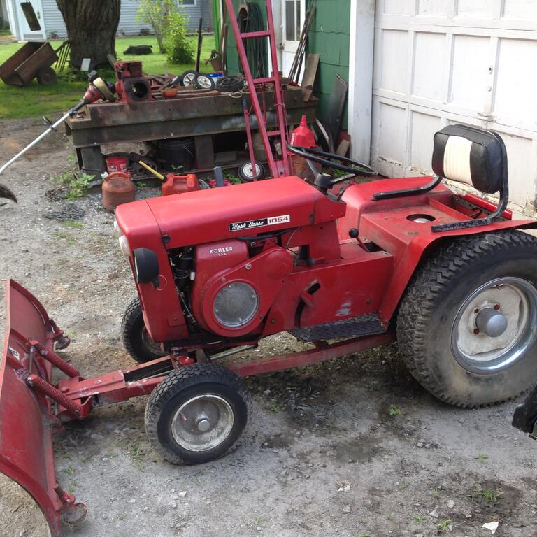

Lane Ranger 11,844 #4 Posted June 3, 2020 I painted a 1054 tractor ten years ago or more with a quart of Rustoleum red paint (not sure which color) but I researched how to apply with a brush! The secret is a product that painters use on metal like aluminum siding, exterior sheets, etc. It is called Flood Penetrol and it works great. No brush marks will be left if properly mixed and applied with a good bristle brush. https://www.hardwareworld.com/pw3atqx/Penetrol-Oil-Paint-Additive-Quart A quart should do you ! 3 1 Share this post Link to post Share on other sites
8ntruck 8,635 #5 Posted June 3, 2020 The beauty rings on the back wheels are a nice touch. 1 1 Share this post Link to post Share on other sites
