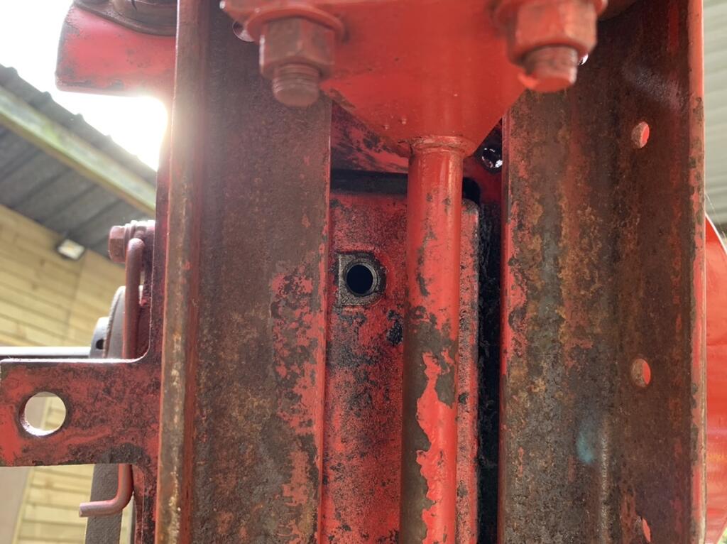

meadowfield 3,191 #1 Posted June 2, 2020 (edited) After pouring oil in, and losing it on the floor on my K301 on a C-121... the remote oil drain on the engine base was snapped off. I welded a nut into the broken piece to get me going. Anyone help with what thread size? Assume by the rough size it is 1/4-18 NPT thanks Edited June 2, 2020 by meadowfield Share this post Link to post Share on other sites

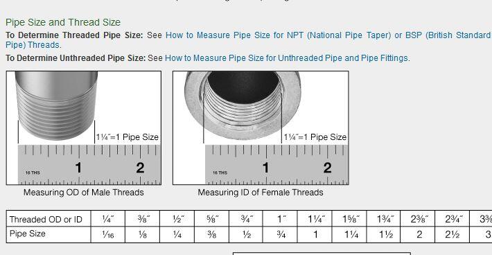

pfrederi 21,300 #2 Posted June 2, 2020 Pipe size may vary depending on the oil pan. Most of mine are 3/8 NPT This chart may help you figure out what you have 3 1 Share this post Link to post Share on other sites

pfrederi 21,300 #5 Posted June 2, 2020 OD of 3/8" NPT is about 11/16" Share this post Link to post Share on other sites

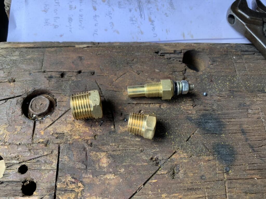

meadowfield 3,191 #8 Posted June 2, 2020 I guess the head size on the bolt tells all! Share this post Link to post Share on other sites
meadowfield 3,191 #9 Posted June 22, 2020 Turns out it is 3/8” NPT.... bought both sizes just in case 1 1 Share this post Link to post Share on other sites
