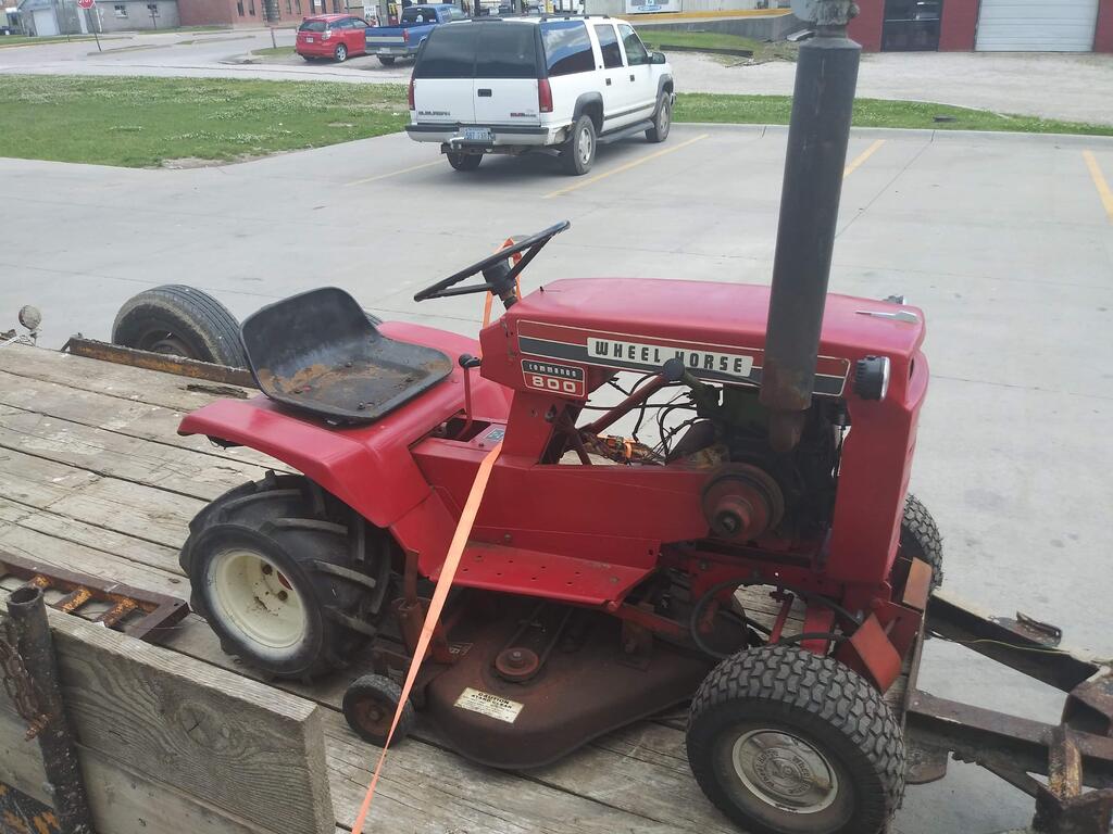

BaDoo 3 #3 Posted June 1, 2020 Here's my tractor, for reference. I'm sure that you can see what parts are missing. 1 Share this post Link to post Share on other sites
gwest_ca-(File Mod) 12,535 #4 Posted June 1, 2020 Your tractor looks to have been well cared for. A search for model 1-0110 brought up 2 pages of results. The illustrated parts lists are named ipl. They are in no particular order so look through them all. https://www.wheelhorseforum.com/search/?q=1-0110&quick=1&type=downloads_file Garry 1 Share this post Link to post Share on other sites

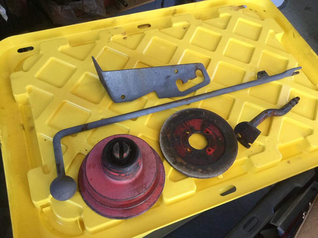

SylvanLakeWH 32,823 #6 Posted June 1, 2020 And... 2 Share this post Link to post Share on other sites
richmondred01 2,393 #8 Posted June 1, 2020 Just parted one this weekend. PM me if interested 1 Share this post Link to post Share on other sites
Pullstart 71,521 #9 Posted June 1, 2020 48 minutes ago, richmondred01 said: Just parted one this weekend. PM me if interested I think he has the newer style hoop Share this post Link to post Share on other sites
richmondred01 2,393 #10 Posted June 1, 2020 (edited) It has the non hoop pto and it appears to have the lever action holes in the tower rather then the newer hoop. the commandos I believe were transitional were some had the hoop and others had the lever. Better photos or a model number will clear up the issue. Edited June 1, 2020 by richmondred01 1 Share this post Link to post Share on other sites
squonk 48,338 #11 Posted June 1, 2020 I believe Mark is correct. You can tell by the slotted PTO bell shaft. Share this post Link to post Share on other sites
