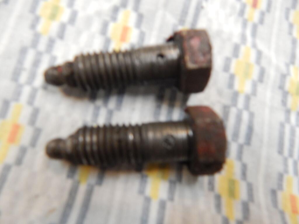

Lane Ranger 11,784 #1 Posted June 1, 2020 This greaseable bolt was used on 1961 through 1963 Wheel Horse tractors on the front steering. I can find no Part Number and any of the Wheel Horse Manuals for this. I know they are on my 701 and I still grease them Anyone know of a source for new ones? 3 Share this post Link to post Share on other sites
JAinVA 4,638 #2 Posted June 1, 2020 I believe the number is 3949.There is a pair of NOS ones on E-bay.Just type in Wheel Horse steering. 3 Share this post Link to post Share on other sites
gwest_ca-(File Mod) 11,998 #3 Posted June 1, 2020 Item #242 in the 1961 parts lists part number 3949 but they call it a clevis pin. No part number for the nut or grease fitting Garry 2 1 Share this post Link to post Share on other sites

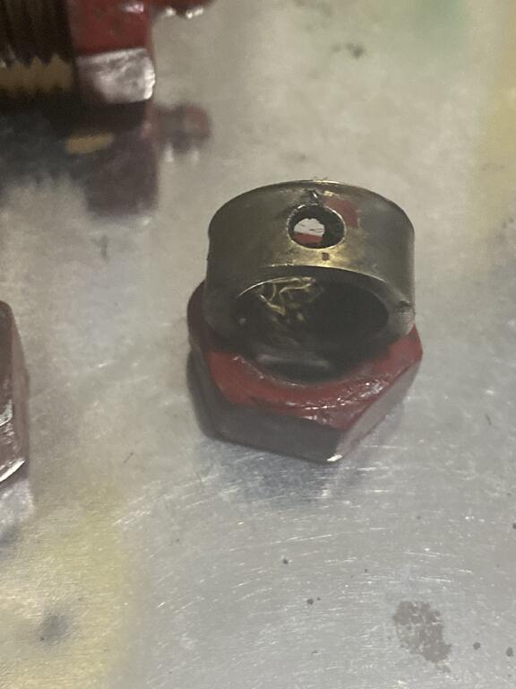

WHX?? 54,955 #5 Posted June 1, 2020 Yeah I got a ton of them Lane, they are called Dan @Achto can probaly make them .. Oddly enough we just kicked this around today when he was making a new drag link for his 701. Looked again Dan and they are 1/2 -13 thd.. 3 1 1 Share this post Link to post Share on other sites

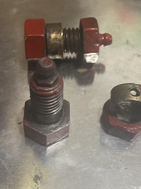

WHX?? 54,955 #6 Posted June 1, 2020 I took the old ones and brazed them up and just re- drilled the grease holes if this helps Lane. Added bronze washers under them. Far as I know that was used on 61 and 62? 753 has conventional tie rods. 3 Share this post Link to post Share on other sites

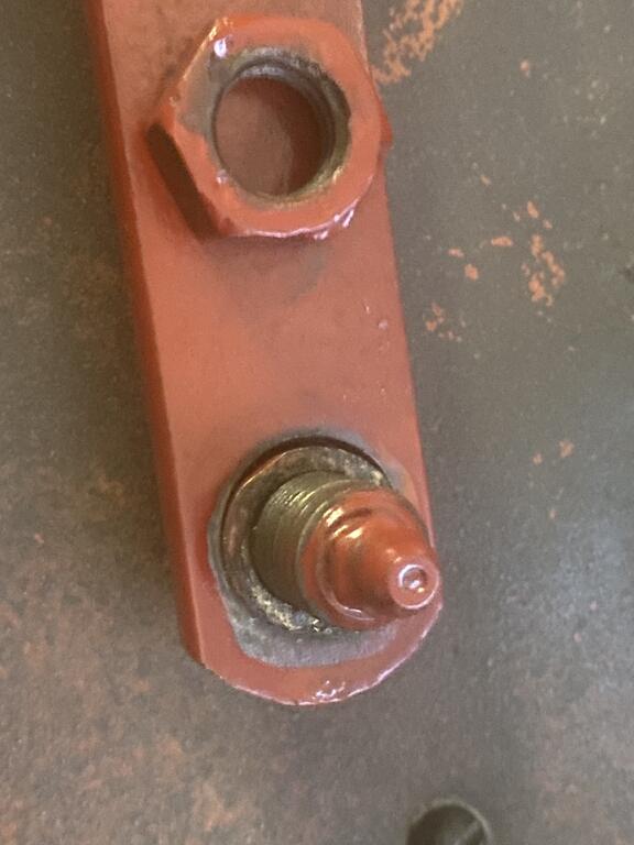

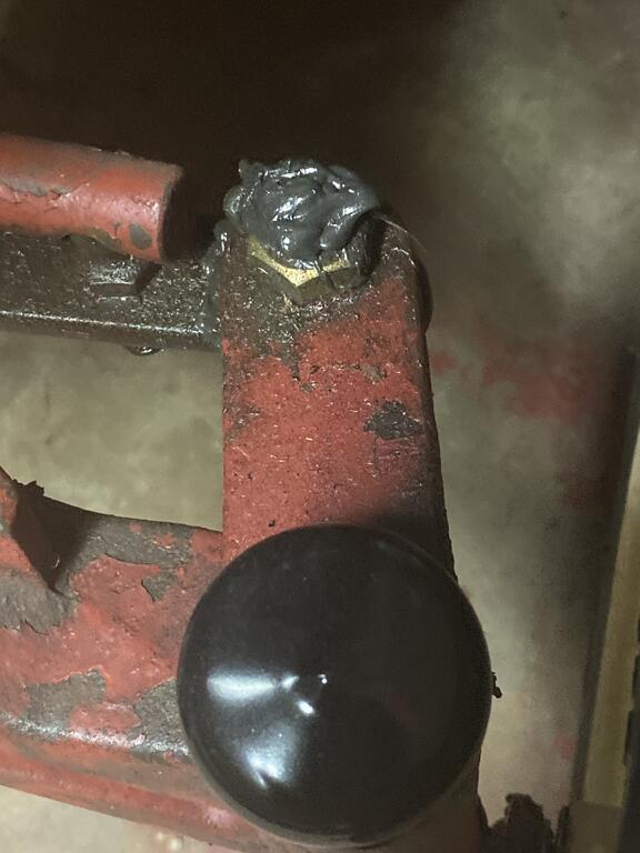

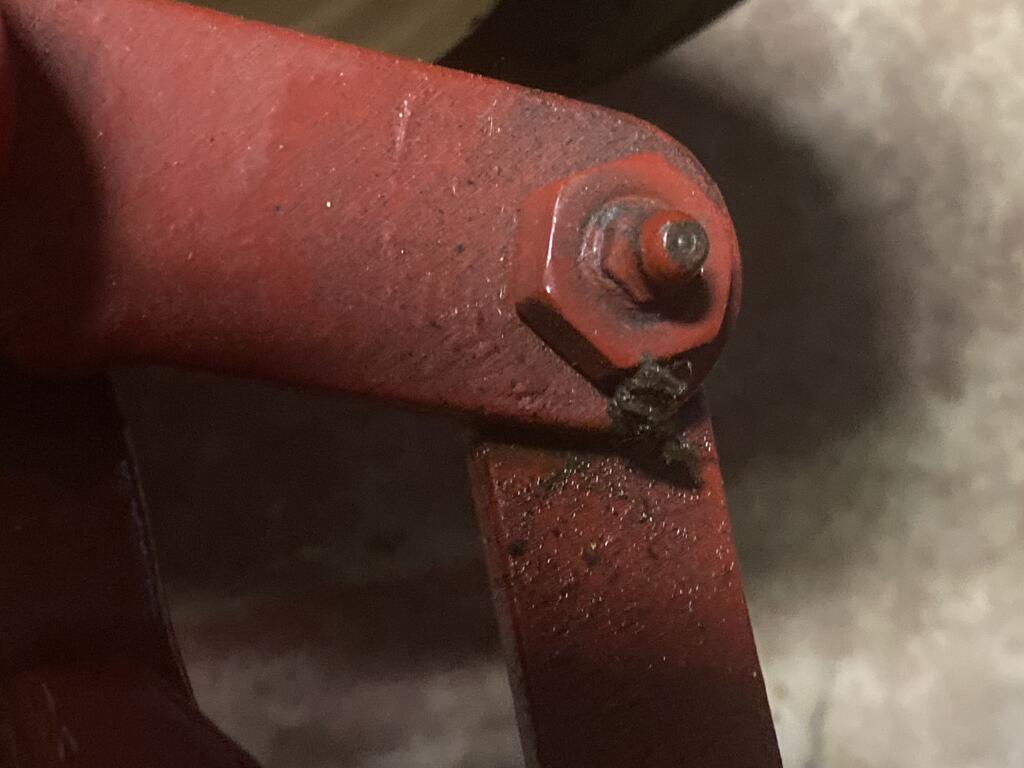

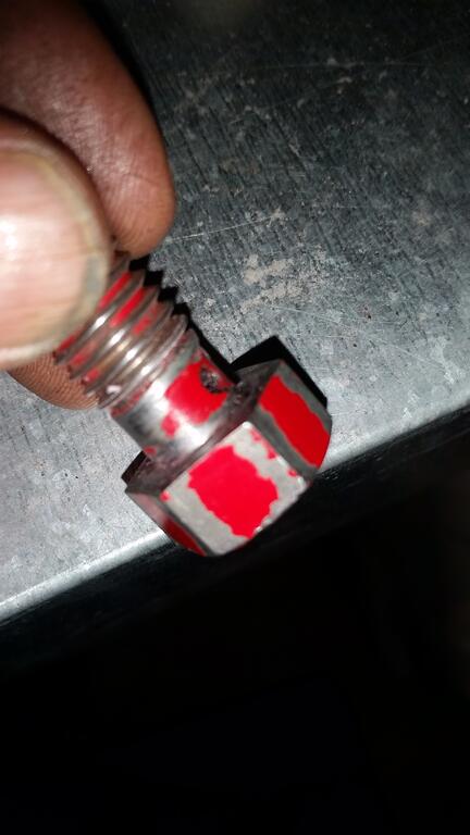

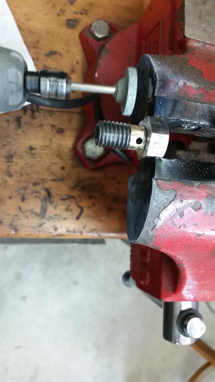

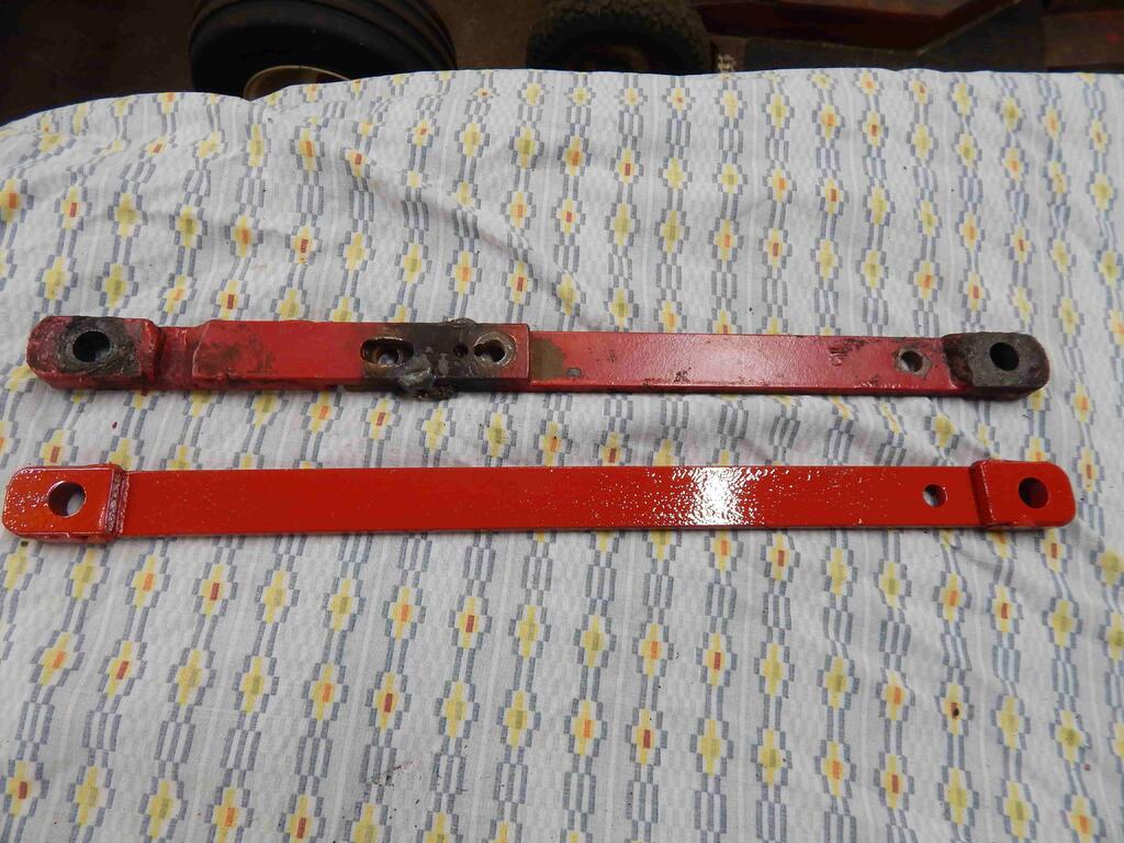

Achto 30,992 #7 Posted June 1, 2020 1 hour ago, Lane Ranger said: Anyone know of a source for new ones? Holy cow Lane, are we working on the same tractor?? Any way I just made a new drag link for my 701. The one on the top of this pic is the one that a PO/Shoe Man made. It did not look anything like stock & I didn't like how cobbled together that it looked. They had doubled up the thickness on the ends. I was just about to head to a lathe to make new bolts and make my drag link to the stock specs but the more that I thought about it the more I liked the doubled up ends. More meat on the ends seemed like a good idea, So instead of making new bolts I decided to use the ones that the PO had made & doubled up the ends of my new drag link. On to the bolts, sorry for the blurry pic. If you grab some 1/2 13 bolts with a smooth shank towards the head, run a die down it until there ise only 1/4" of smooth surface left. Then drill an 1/8" hole length wise down the bolt, drill part of the way out larger to tap 1/4-28 threads for a grease cert, then cross drill 1/8" hole near the head. Depending on the length of the bolts that you find you may have to cut them down a bit. If you look at the pic below you can tell that the PO did not use a lathe to do this with the ones that they made. The grease cert is a bit off center. If you wish to make your own new ones it shouldn't be too difficult. 6 1 Share this post Link to post Share on other sites
Lane Ranger 11,784 #8 Posted June 1, 2020 The beefed up drag link is a great idea! I now see that they can be made without too much ballyhoo! 8 hours ago, WHX24 said: I took the old ones and brazed them up and just re- drilled the grease holes if this helps Lane. Added bronze washers under them. Far as I know that was used on 61 and 62? 753 has conventional tie rods. jim. You added bronze washers under them at the top under the drag link or where??? Share this post Link to post Share on other sites

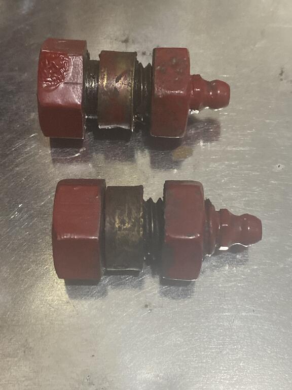

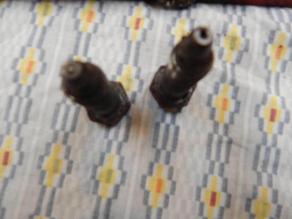

Lane Ranger 11,784 #9 Posted June 1, 2020 I found my spare pair of these greaseable bolts #3949 as Wheel Horse labels them “clevis pins” ! I see I had a 701 that was parted out that had them on it. the previous owner tried tightening up the steering doing some of what Jim did by adding bronze fittings. He also drilled out the steering drag link for the fittings to fit tight and drilled holes in the bronze fitting so the grease would get in them . 2 Share this post Link to post Share on other sites
WHX?? 54,955 #10 Posted June 1, 2020 (edited) Oddly the hole in the drag link on mine were not wallowed but the bolt shank was worn out of round. So I didn't need to use bushings. Since I don't have ready access to a lathe to make new ones. I brazed up the shank and filed back down to fit. I could have had Dan turn me some new bolts but I just liked the thicker head the original bolts have so decided to save them. I did use a bronze flat washer between the drag link and steering arm for some smoothness there. I would make a new drag link like Dan did and go back to original without the bushings I were you. With or without the beefed up ends. If with you will need to make longer shanked grease bolts. Edited June 1, 2020 by WHX24 4 Share this post Link to post Share on other sites
WHX?? 54,955 #11 Posted June 1, 2020 (edited) After thought here too Lane if you want to stay original weld the holes up and re-drill to proper size. If you make a new drag link let me know so I can put my finger prints in the wet paint like I did Dans! Edited June 1, 2020 by WHX24 1 2 Share this post Link to post Share on other sites

WHX?? 54,955 #13 Posted June 1, 2020 12 hours ago, Achto said: The grease cert is a bit off center. Got a feeling that will bother you and make new ones & send them to @ebinmaine…..claims he is a bit off center! 1 3 Share this post Link to post Share on other sites
JAinVA 4,638 #14 Posted June 1, 2020 (edited) The listing I was referring to was around $16.00 for the pair NOS.You cannot make them for that. Edited June 1, 2020 by JAinVA 5 Share this post Link to post Share on other sites
Achto 30,992 #15 Posted June 1, 2020 11 minutes ago, WHX24 said: Got a feeling that will bother you and make new ones Your probably correct. 1 Share this post Link to post Share on other sites
