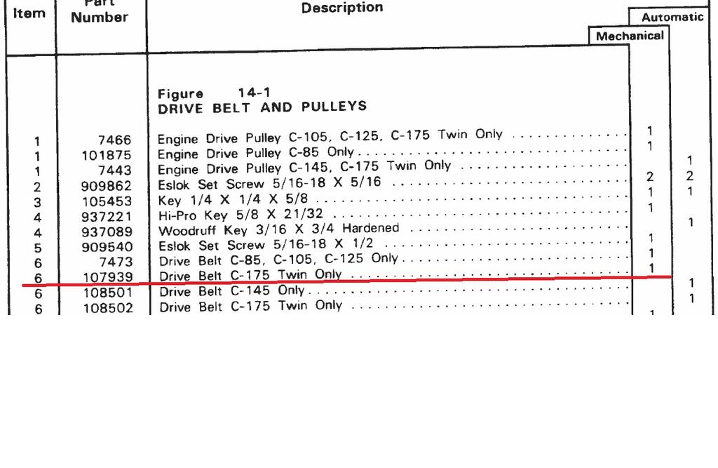

gwest_ca-(File Mod) 12,263 #3 Posted May 31, 2020 Attached are the belts for 1983 models from an original parts list. 1983 C-175 Twin 8-speed model 11-17K801 Transmission drive belt 107939 replaced by 93-9809 - (HB x 83.5" or 5/8" x 83-1/2"") That is not helping your problem because the correct belt is longer again. Wrap some tape on the belt you have for a marker and run a tape measure around the outside to see what the actual length is. Is the engine still mounted to the shaker plate? Are the 3 pulleys still original size? Is the new belt you have 5/8" wide? The Twin cylinder models use a longer belt. The online parts lists are most often shared by more than one tractor model. Look at the engine page and the transmission page to see what others are included. You could have 5 different belts listed but none of the applications are identified. Garry Share this post Link to post Share on other sites

gwest_ca-(File Mod) 12,263 #5 Posted May 31, 2020 Single cylinder 8-speeds Transmission drive belt 78-7100 replaced by 7473 - HB x 81.9" or 5/8" x 81.9" Twin cylinder 8-speeds Transmission drive belt 107939 replaced by 93-9809 - (HB x 83.5" or 5/8" x 83-1/2"") Single cylinder Automatics Transmission drive belt 108501 - (HB/5L x 81.50" or 5/8" x 81.5") Twin cylinder Automatics Transmission drive belt 108502 - (HB/5L x 83" or 5/8" x 83") I do not know what it will take. Trial and error I think. You are correct on the pedal adjustment. Just there to accommodate different height operators. Garry Share this post Link to post Share on other sites
