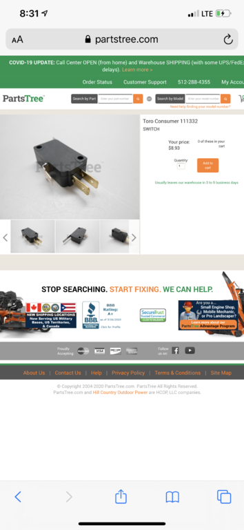

Whguy46041 10 #8 Posted May 30, 2020 (edited) 20 minutes ago, gwest_ca said: The circuit you need is the "Spark" circuit. Hope you realize the magneto ignition is self-powered and the single ignition wire when grounded shuts the ignition off. That is how the safety system for the ignition works. It grounds out the ignition. Do not allow any battery voltage to get to the ignition wire. That will instantly burn up the coil. Garry This is the switch that is bypassed right now that would not allow the tractor to start originally. The purple and tan wires are the ones bypassed together that plug into this switch. Edited May 31, 2020 by Whguy46041 Share this post Link to post Share on other sites
Whguy46041 10 #9 Posted May 30, 2020 5 minutes ago, wallfish said: Are you sitting in the seat when engaging the PTO? The seat and PTO safety switch work together so you can not engage the PTO if someone isn't sitting in the seat . From the sound of the video it is not bogging down, it's shutting off. Couldn't see the video just has the sound. Seat switch is bypassed and this switch is bypassed do to it going bad and not allowing the tractor to start at all. I’d rather just bypass the pto switches all together. Share this post Link to post Share on other sites
