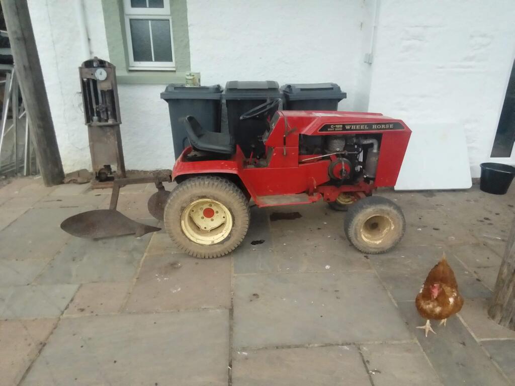

Dan.gerous 2,696 #28 Posted June 4, 2020 (edited) The kids kindly sent me a picture of the plow sitting behind one of the wheel horses - it turned up about three hours after I left for work. Edited June 4, 2020 by Dan.gerous 4 1 Share this post Link to post Share on other sites
Achto 32,844 #29 Posted June 4, 2020 (edited) I see that your tractor is protected by an attack chicken. Edited June 4, 2020 by Achto 3 Share this post Link to post Share on other sites
Dan.gerous 2,696 #30 Posted June 4, 2020 29 minutes ago, Achto said: I see that your tractor is protected by an attack chicken. I have ten attack chickens keeping it safe! 1 2 Share this post Link to post Share on other sites
gwest_ca-(File Mod) 12,511 #31 Posted June 4, 2020 If you want to plow 5 inches deep place 5 inch blocks under the front and rear left tractor tires. Place the plow at the rear of the tractor like in the photo. Then you can see what you need to do to join the two. If a bit of adjustment can be built into the hitch you will be able to fine tune it. Garry 1 1 Share this post Link to post Share on other sites

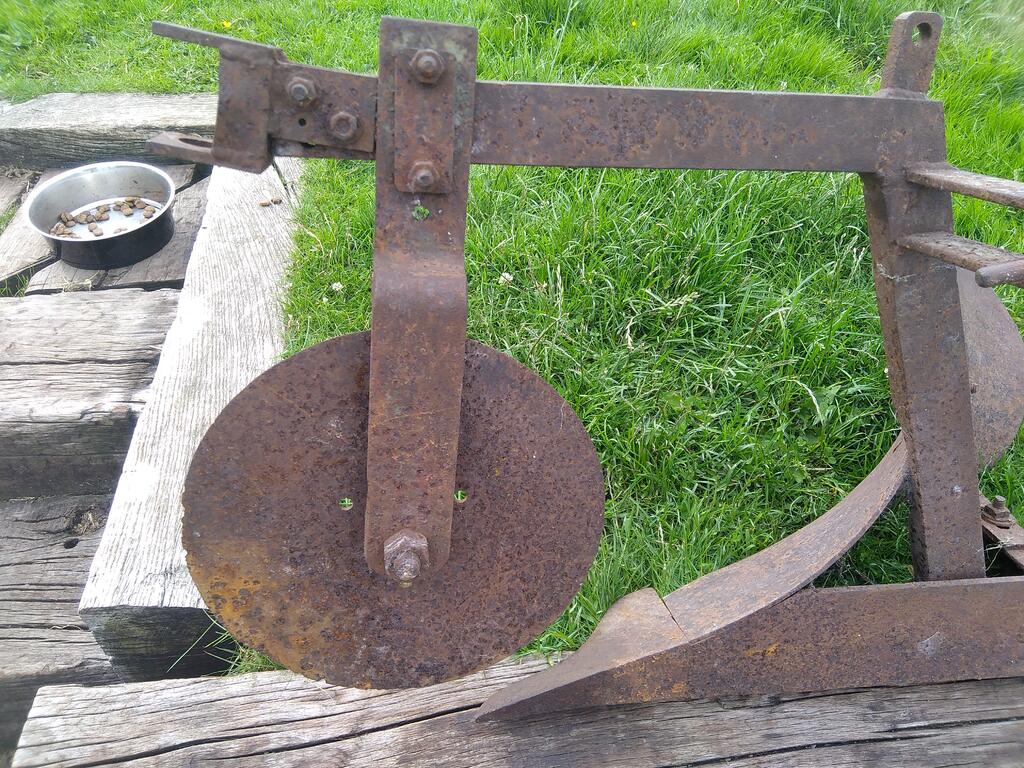

Dan.gerous 2,696 #33 Posted June 6, 2020 So can anybody explain what the disc is for on the plow? I'm assuming it's to stop things getting hooked on the blade? Share this post Link to post Share on other sites

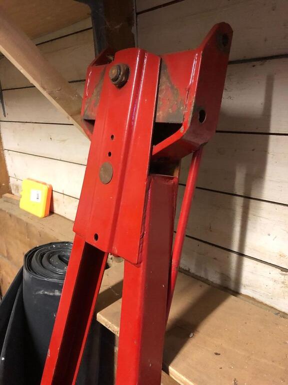

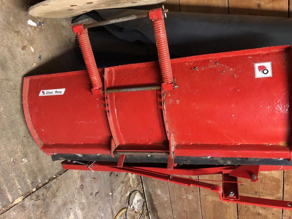

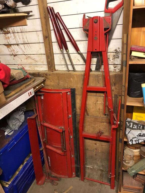

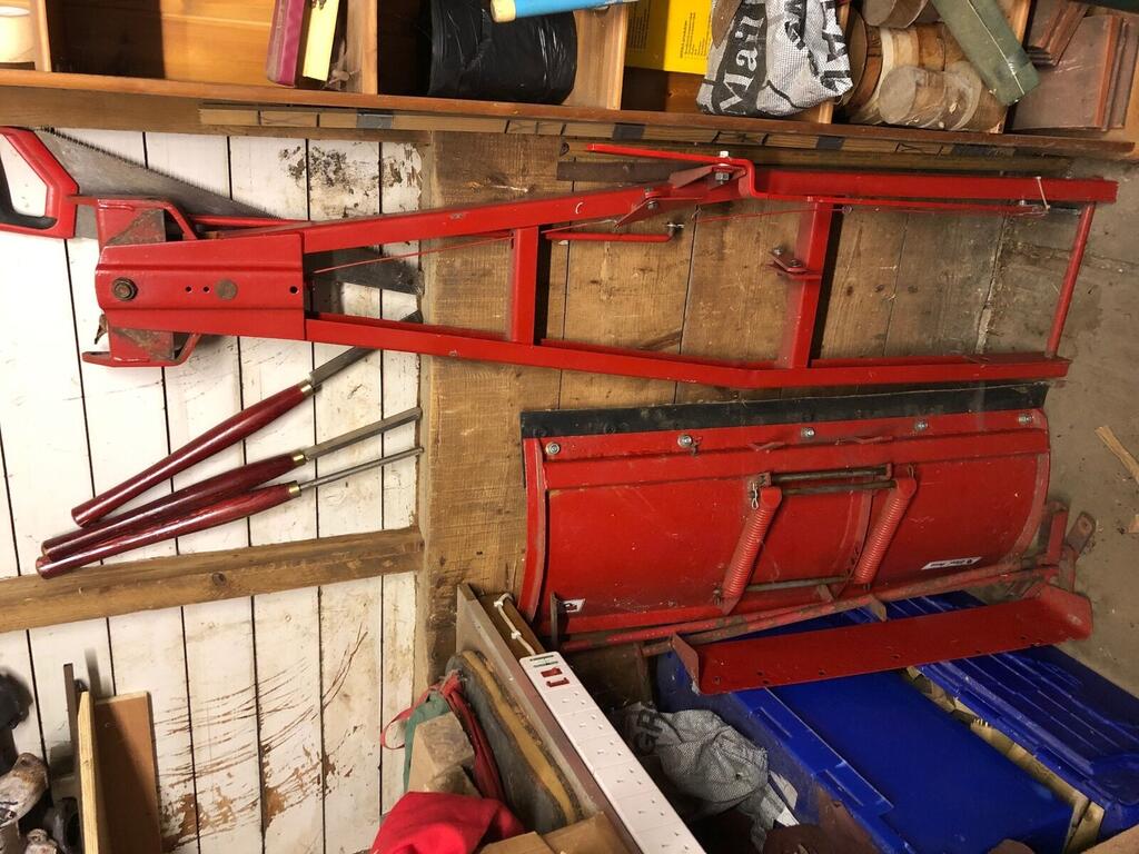

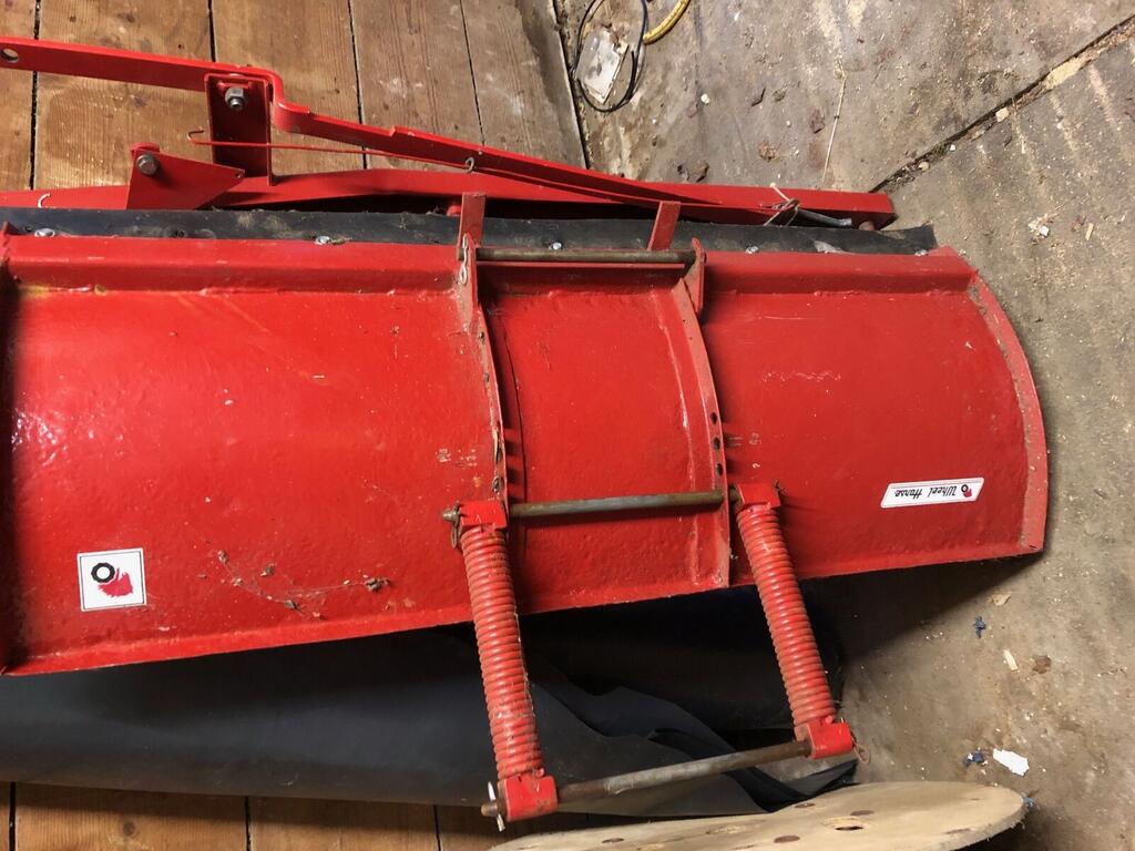

Dan.gerous 2,696 #34 Posted June 16, 2020 I just brought a different kind of plow, this time managed to pick up a nice condition snow plow. Haven't even been home yet to have a look at the plough that started this thread! The owner also has a 48" side discharge deck and a bunch of parts for me 😁 Starting to get lots of attachments now, thought it would take a lot longer. 1 3 Share this post Link to post Share on other sites
ebinmaine 80,959 #35 Posted June 16, 2020 NIIIIIICE 1 Share this post Link to post Share on other sites
WHX?? 58,307 #36 Posted June 16, 2020 My neck was getting sore Dan. You will need the axle bracket too I don't see that? 1 Share this post Link to post Share on other sites
Dan.gerous 2,696 #37 Posted June 16, 2020 6 minutes ago, WHX24 said: My neck was getting sore Dan. You will need the axle bracket too I don't see that? That's better, didn't even think to turn them around. Yeah, I do have an axle bracket for my Rototiller, but hopefully this will have one as well so I can swap between machines if required. 1 Share this post Link to post Share on other sites
ebinmaine 80,959 #38 Posted June 17, 2020 2 hours ago, Dan.gerous said: axle bracket If not you can make one from rugged angle iron. 1 Share this post Link to post Share on other sites
WHX?? 58,307 #39 Posted June 17, 2020 Bracket should be the same Dan. 1 Share this post Link to post Share on other sites
gwest_ca-(File Mod) 12,511 #40 Posted June 17, 2020 On 6/5/2020 at 11:59 PM, Dan.gerous said: So can anybody explain what the disc is for on the plow? I'm assuming it's to stop things getting hooked on the blade? The disc is called a coulter and cuts the sod just before the mouldboard turns it over. Garry 1 1 Share this post Link to post Share on other sites

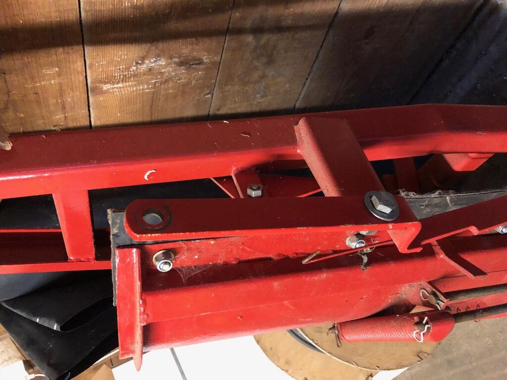

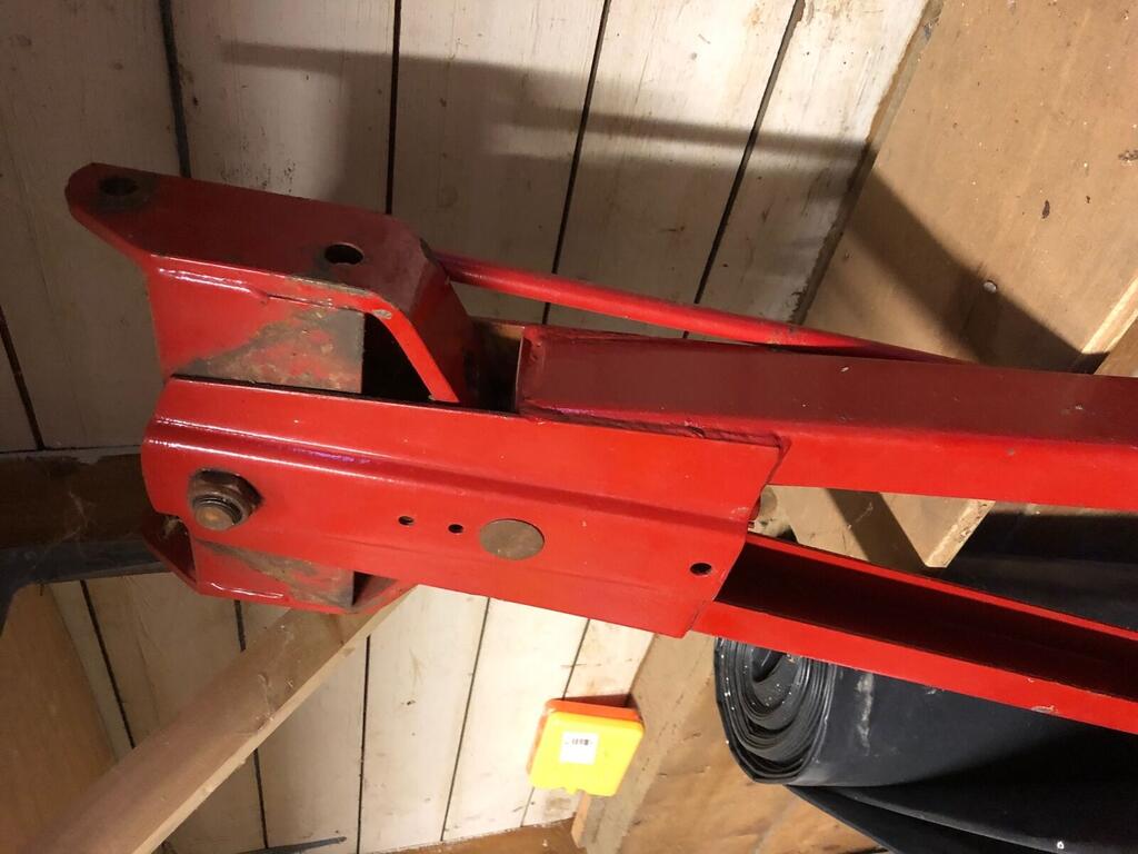

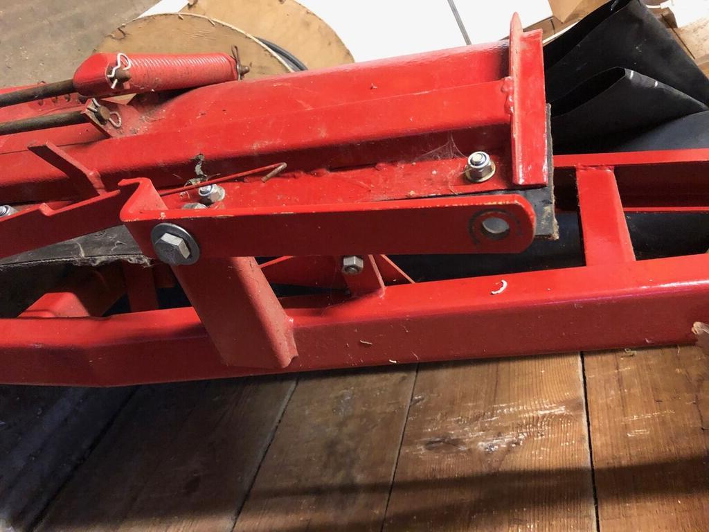

Dan.gerous 2,696 #45 Posted June 18, 2020 Just got home, had a first look at the plow. It's got adjustment on the front to change the angle - see pics. That's got to be a good thing. Share this post Link to post Share on other sites

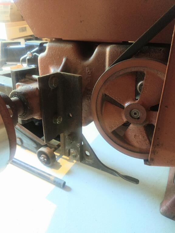

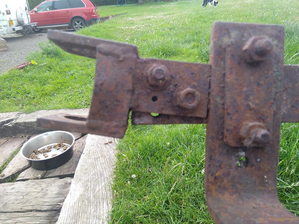

ebinmaine 80,959 #46 Posted June 18, 2020 29 minutes ago, Dan.gerous said: You know the rules, pictures 😊 I know there's a thread on here somewhere that has them but I don't remember if it's separated or in a common Thread. I'll either find a couple pictures or take some more for you. 1 Share this post Link to post Share on other sites
ebinmaine 80,959 #47 Posted June 21, 2020 On 6/18/2020 at 12:31 PM, Dan.gerous said: You know the rules, pictures 😊 Here's a shot of the right side bracket. Left is same size/shape but opposite built. 1 Share this post Link to post Share on other sites
Dan.gerous 2,696 #48 Posted June 21, 2020 1 hour ago, ebinmaine said: Here's a shot of the right side bracket. Left is same size/shape but opposite built. Thanks, that is so simple but effective. 1 Share this post Link to post Share on other sites
