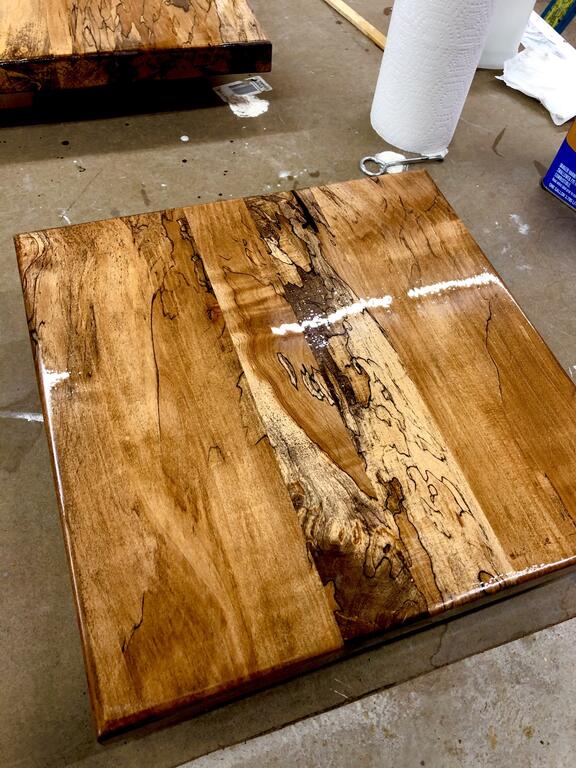

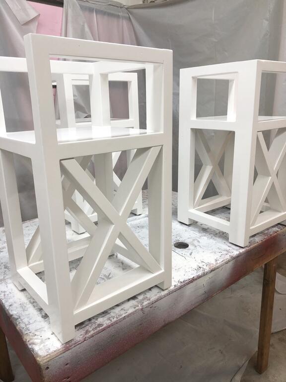

The Tuul Crib   7,354 #1 Posted May 29, 2020 Been painting today but unfortunately the wrong color.  I much prefer regal red but this project had to get done in three more days!!  Almost there. The tops are spalted maple. A lot going on in these small little squares!! 7 2 6 Share this post Link to post Share on other sites
Stormin   9,988 #2 Posted May 29, 2020  Look very strong and sturdy and I'm sure they are. First thought was stools. But not if they've got tops. Share this post Link to post Share on other sites
The Tuul Crib   7,354 #3 Posted May 29, 2020 6 minutes ago, Stormin said:  Look very strong and sturdy and I'm sure they are. First thought was stools. But not if they've got tops. They do resemble children's seats ! all I have to do is leave the top off! it's what the customer wanted! 2 Share this post Link to post Share on other sites
CCW Â Â 1,519 #4 Posted May 29, 2020 Tops are really nice. 1 Share this post Link to post Share on other sites
formariz   12,381 #5 Posted May 29, 2020 That's actually a pretty nice design for them and those tops are just stunning.  Pretty clever title too. 1 Share this post Link to post Share on other sites
The Tuul Crib   7,354 #6 Posted May 29, 2020 47 minutes ago, formariz said: That's actually a pretty nice design for them and those tops are just stunning.  Pretty clever title too. They're a little uneven on top because there's so much going on with the pieces, The white color wood is a lot softer than the darker almost the start of dry rot .Was a Challenge to sand. probably a second coat of poly tomorrow and wrap it up. Thanx ! 1 Share this post Link to post Share on other sites
formariz   12,381 #7 Posted May 29, 2020 8 minutes ago, The Tuul Crib said: They're a little uneven on top because there's so much going on with the pieces, The white color wood is a lot softer than the darker almost the start of dry rot .Was a Challenge to sand. probably a second coat of poly tomorrow and wrap it up. Thanx ! I know the feeling. I usually use a clear penetrating epoxy on the rotted soft parts to harden it. Takes a few applications but it does the job. 2 Share this post Link to post Share on other sites

The Tuul Crib   7,354 #9 Posted May 30, 2020 12 hours ago, formariz said: I know the feeling. I usually use a clear penetrating epoxy on the rotted soft parts to harden it. Takes a few applications but it does the job. Would you believe those frames are. 2x4s from lowes? Ive never worked a 2x4 this much before. The smell eventually will lead you to pinesol hell!  Share this post Link to post Share on other sites
