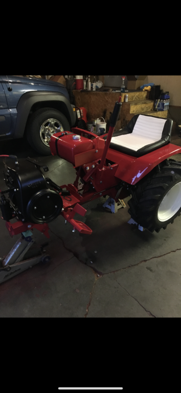

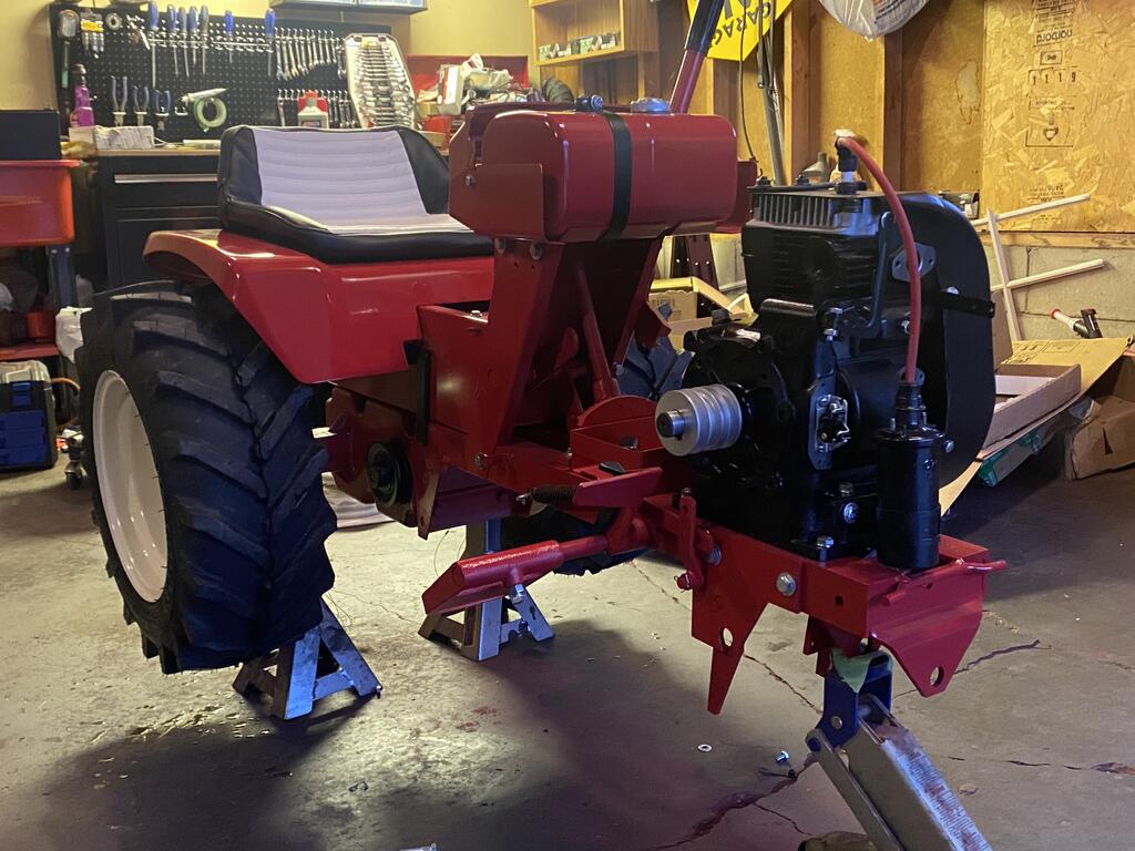

JustinW.73 224 #1 Posted May 28, 2020 Been awhile since I posted on this forum. My girlfriend got me an 856 for my birthday in April. To surprise her I’ve been restoring it and am going to surprise her with it. Hopefully it will be done soon. 8 11 1 1 Share this post Link to post Share on other sites

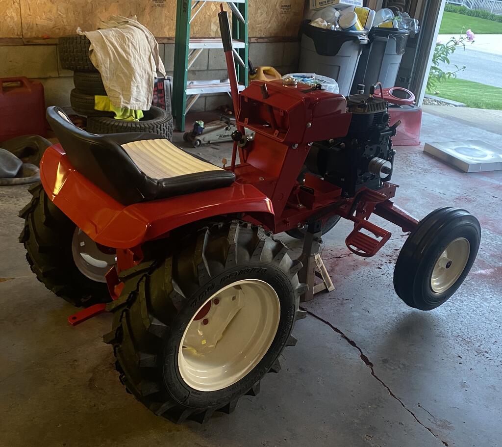

JustinW.73 224 #9 Posted May 29, 2020 Thanks guys for all the comments. Kasey, mechanically the transmission was good (not like these transmissions go out lol). Engine was completely rebuilt my my buddy and me. 20 over with nos kohler piston and rings. New rod. All new gaskets. New points and condenser. Engine ran well before tearing apart, but it did smoke and needed a valve job badly. I’m technically the second owner of it. The guy I got it from dad bought it new in 66, he restored it back in the 90s, and past away last year. His son, the one I bought it from, never did anything with it after he past. So I’m going to call myself the second owner. Also got the deck with it which was in good shape. Still need to paint that. Only other thing mechanically that needs to be done the steering rods need replaced (if anyone has any really good used ones or even nos let me know) and the rh spindle where the tie rod connected is bent fairly well. Also have to replace the front pivot pin for the front axle. Have almost everything painted but the front axle, tie rods, and rh spindle. 1 5 Share this post Link to post Share on other sites

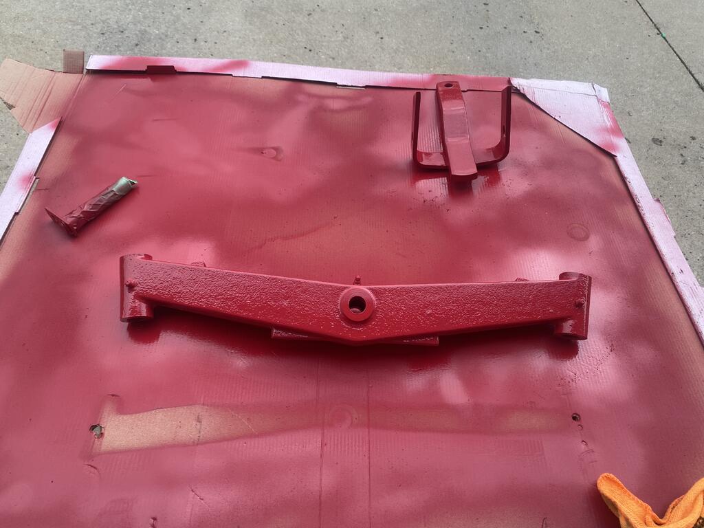

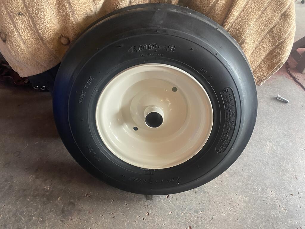

JustinW.73 224 #17 Posted May 31, 2020 Got more done today. Painted front rims and got the new tires on. Will be masking off the tires and wet sanding and coating the rims again to get rid of and scratches put in when mounting the tires. Also got the front axle painted and is now drying as well as the rear hitch. Will probably be able to get the axle on tonight along with one spindle and hold the left tire on to see how it looks. I need a new rh spindle. Mine was all bent up and can’t get it bent back right. Also found the updated tie rods on parts tree. Will be getting in some of those as well as new fender bumpers. Didn’t get a picture but decided to mount the rear rims on the tractor for now so it’s not on jack stands. Looks awesome. 6 1 Share this post Link to post Share on other sites

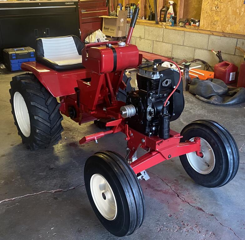

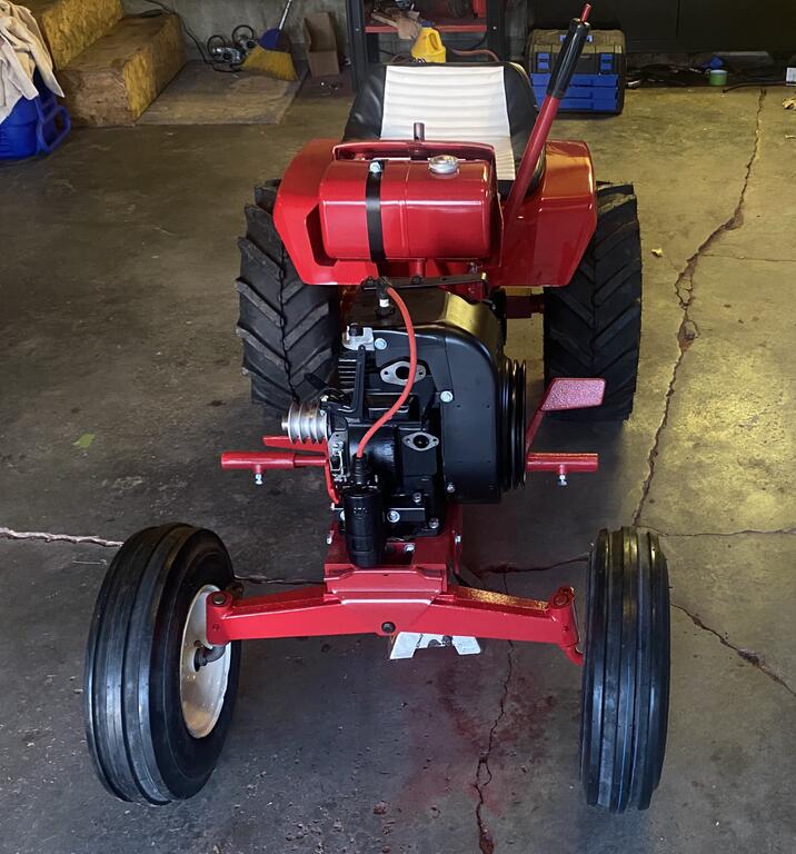

JustinW.73 224 #19 Posted June 1, 2020 Got the front axle on. Also threw the front wheels on for fun. Looks awesome. My OCD might be getting to me, but to anyone else, does it look like the axle the the front of the frame are different colors? May just be white wash and because the frame has older paint idk. Kinda freaking out about it lol. 3 6 1 Share this post Link to post Share on other sites
Pullstart 71,482 #20 Posted June 1, 2020 I’m thinking the difference in axle and frame might be the texture of the cast vs the smooth steel? Either way, it looks amazing! 4 Share this post Link to post Share on other sites
JustinW.73 224 #21 Posted June 1, 2020 1 hour ago, pullstart said: I’m thinking the difference in axle and frame might be the texture of the cast vs the smooth steel? Either way, it looks amazing! I thought that too. But sadly no. Took it back down to the frame and it is definitely pinkish. Sprayed the frame and transmission again with the same can I used on the front end. It’s definitely different. Of course I screwed up on that front piece and have to wait and sand it down to do one more coat. Will never be buying another can of krylon paint again after this is all done. 1 Share this post Link to post Share on other sites
ebinmaine 81,048 #22 Posted June 1, 2020 4 minutes ago, JustinW.73 said: I thought that too. But sadly no. Took it back down to the frame and it is definitely pinkish. Sprayed the frame and transmission again with the same can I used on the front end. It’s definitely different. Of course I screwed up on that front piece and have to wait and sand it down to do one more coat. Will never be buying another can of krylon paint again after this is all done. Any thoughts what may have caused the difference? Was the surface prepared in an identical manner? Share this post Link to post Share on other sites
Pullstart 71,482 #23 Posted June 1, 2020 Yeah, Rustoleum Regal Red seems to be the favorite, then Sunshine Red. Share this post Link to post Share on other sites
WHX?? 58,324 #24 Posted June 1, 2020 1 hour ago, JustinW.73 said: never be buying another can of krylon paint again I say the same thing about Rustoleum when half the can refuses to spray! 1 Share this post Link to post Share on other sites
ebinmaine 81,048 #25 Posted June 1, 2020 4 minutes ago, WHX24 said: I say the same thing about Rustoleum when half the can refuses to spray! 1 hour ago, JustinW.73 said: never be buying another can of krylon I've had problems with both in the past but I've learned to purchase them from chain stores so that I have a good return capability. My Paint Department, also known as Trina, has a great leaning preference towards Rust-Oleum 2X. We've gone through AT LEAST 25 or 35 cans of 2x of different colors doing the tractors over the last couple years. I've had maybe two? Or 3? That were bad. And those were during the winter months and may have been frozen during shipment. 3 Share this post Link to post Share on other sites
