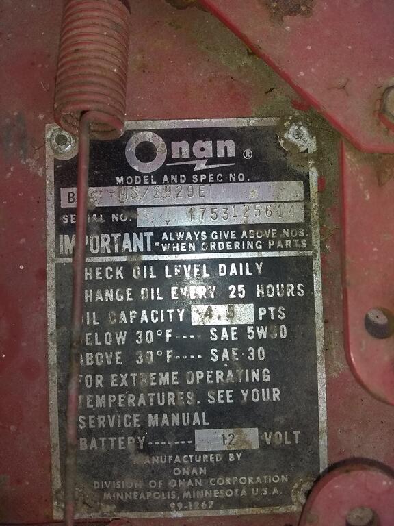

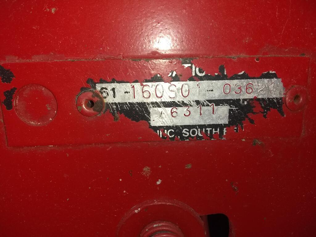

bottjernat1 2,197 #1 Posted May 28, 2020 (edited) Does anybody know the oil filter number for the engine and transmission? and the air filter number it is the round air cleaner i tried 1 of my many new stens air filters but they are for the old k series kohlers. ? I am hoping to go buy new ones or see if i dont have them in stock. The current engine one is a fram ph2870A the tranny one i cant read its been painted over! Thanks for all the help!! Edited May 28, 2020 by bottjernat1 Share this post Link to post Share on other sites
gwest_ca-(File Mod) 12,521 #3 Posted May 28, 2020 Click on the picture for hydro filter. 1976 filter was 102819 The air filter 201180 is not showing up. Found a Wix filter for the D-160 Wix # 42299 (3-1/16" tall, 6-1/16" OD and 4-11/16" ID) Engine oil filter 201099 replaced by 108-3817 Wix 51516 (4-13/16" tall and 2-15/16" OD Garry 1 Share this post Link to post Share on other sites
